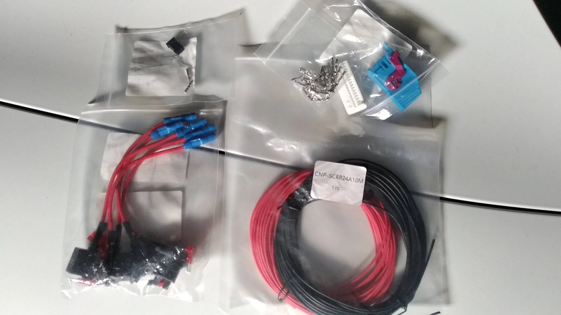

My parts from aliexpress came in today, all okay except the crimping tool was €3 junk (although it did its job eventually)
Porsche Taycan Retrofitting original sport chrono clock IMG_20250605_100929

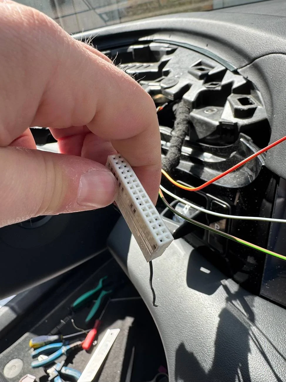

so that's the connector for the clock, a 32 pin connector with terminals (I used it to test my crimping skills and was happy to have extras when my crimp went wrong) ... if you are confident you only need one of those terminals to add to slot 17.

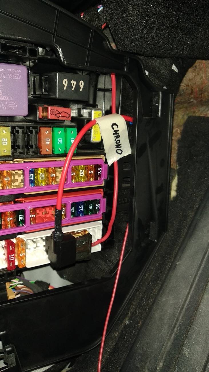

I took a slightly different approach than alex_bell as I didn't dare to splice into the existing wiring for 12v and ground, so got me some add-a-fuse.
Then some 24 AWG silicone wire (first ordered 18 AWG, but that was too thick to fit in the terminals and into the connector , beginners mistake, I'm not used to working with wiring)
Made the wire-loom as per directions in the first post
added pin 17 to the big white connector of the cluster, was the top left one (still empty in the pic)

fishing some wire from the chrono to the instrument cluster area, then from there to the fuse box,
ground to the bolt near the fuse-box, red 12v to the add-a-fuse

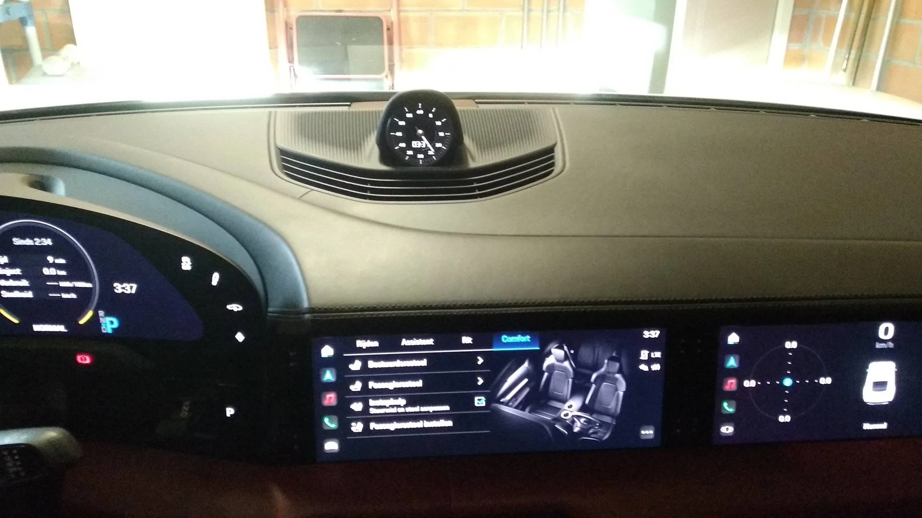

Great success! Completely useless and yet another place to read the time, but I like it.
Porsche Taycan Retrofitting original sport chrono clock IMG_20250605_192518
I think it took about 4 hours, took my time ... always a good feeling to successfully complete a DIY project.

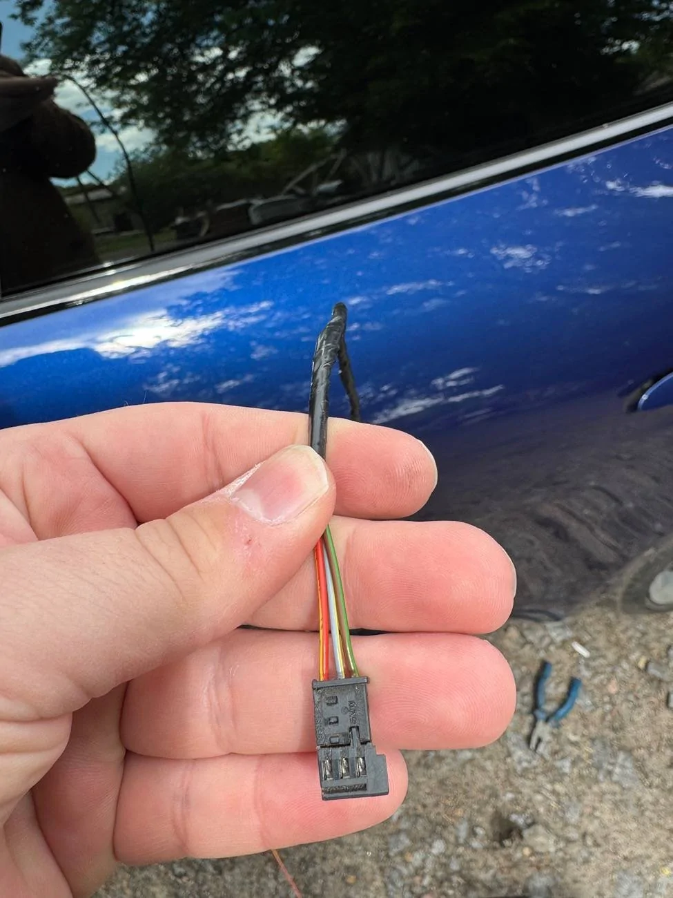

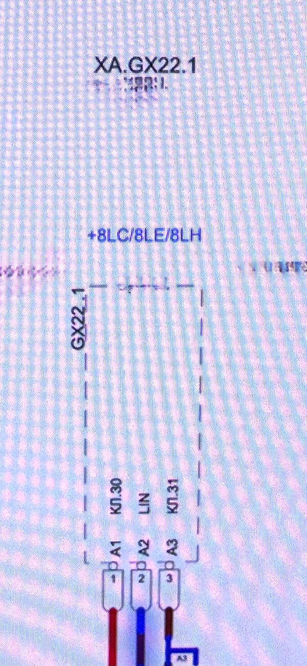

Here's pinout of connector and how it looks

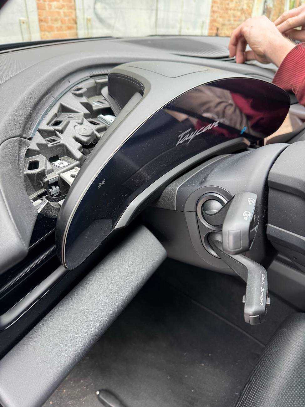

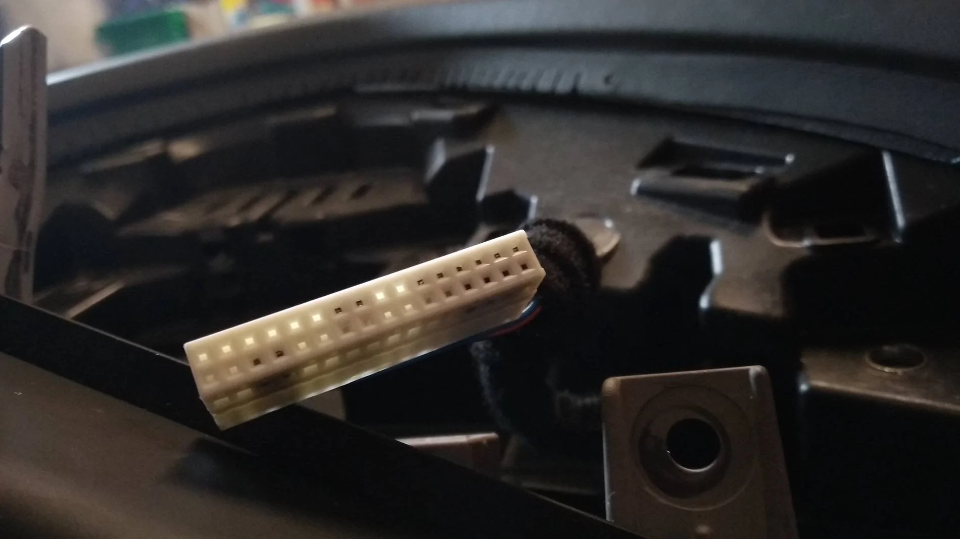

TO start I had to remove instrument cluster. To remove it you need to pop off plastic cover thats over IC and then unscrew 4 T20(or T25 dont remember) screws. Then IC simply pops off. Make sure car went to sleep so the screen isnt on anymore to prevent any damage when you disconnect it(it can take 5 mins to fully fall asleep sleep). Remove big connector first and then video signal
Remove video cable and big connector. Now we need to wire our clock to this connector. At first - remove housing, that purple small clip that holds connector in housing, just push it up and it will pop off. Next step - we need to add pin #17. This is where one of LIN bus wires lives and this bus made specifically to feed data to clock. The connector has 4 labels marking position of pins. The pin for #17 located in corner, but in my case connector didnt have pin, so I had to add one. You can use crimping tool to make it, but I didnt have this small pins, so I just found old wiring loom from VW and pulled one of pins from that loom and it fit perfectly

Last step - add power and ground. You can use any red wire on connector for +12v and any brown wire for ground. In my case I used PIN 31 for +12v and pin 30 for ground. Simply cut isolation off, soldered and put isolation tape back.

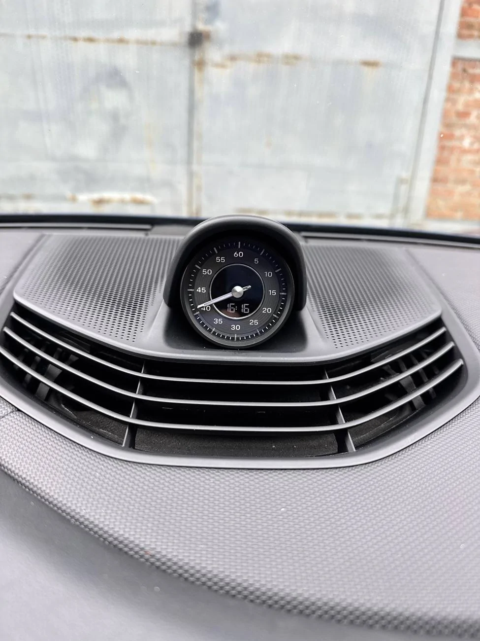

Now it's basically done. I insulated with same isolation tape as rest of the loom, so in my case it looks like its been factory made. Connect clock, connect instrument cluster(video signal first, then big connector) and turn car on. You should have your time reset, so go to PCM and set it again. The clock should synchronize with car time right away.
Basic clock feature does not need any coding and works right after connecting. In my case it worked right away. Clock arrow works well, backlight also works well(the one that lights up numbers). If you wan it to be a timer, you will need to code it to car, but I'll do that sometime later when I find reasonable priced steering wheel with mode selector and add full Chrono sport to car.
This is how it looks now
I hope it will help someone to retrofit it too. It took me about 3-4 hours in total with few coffee breaks.

Curious why you decided to tap into fuse box for power instead of taking it from instrument cluster? Would be so much easier
That's just me being overly worried I'd somehow screw up the original wires :)
Taking power from the instrument cluster would indeed have been better.
