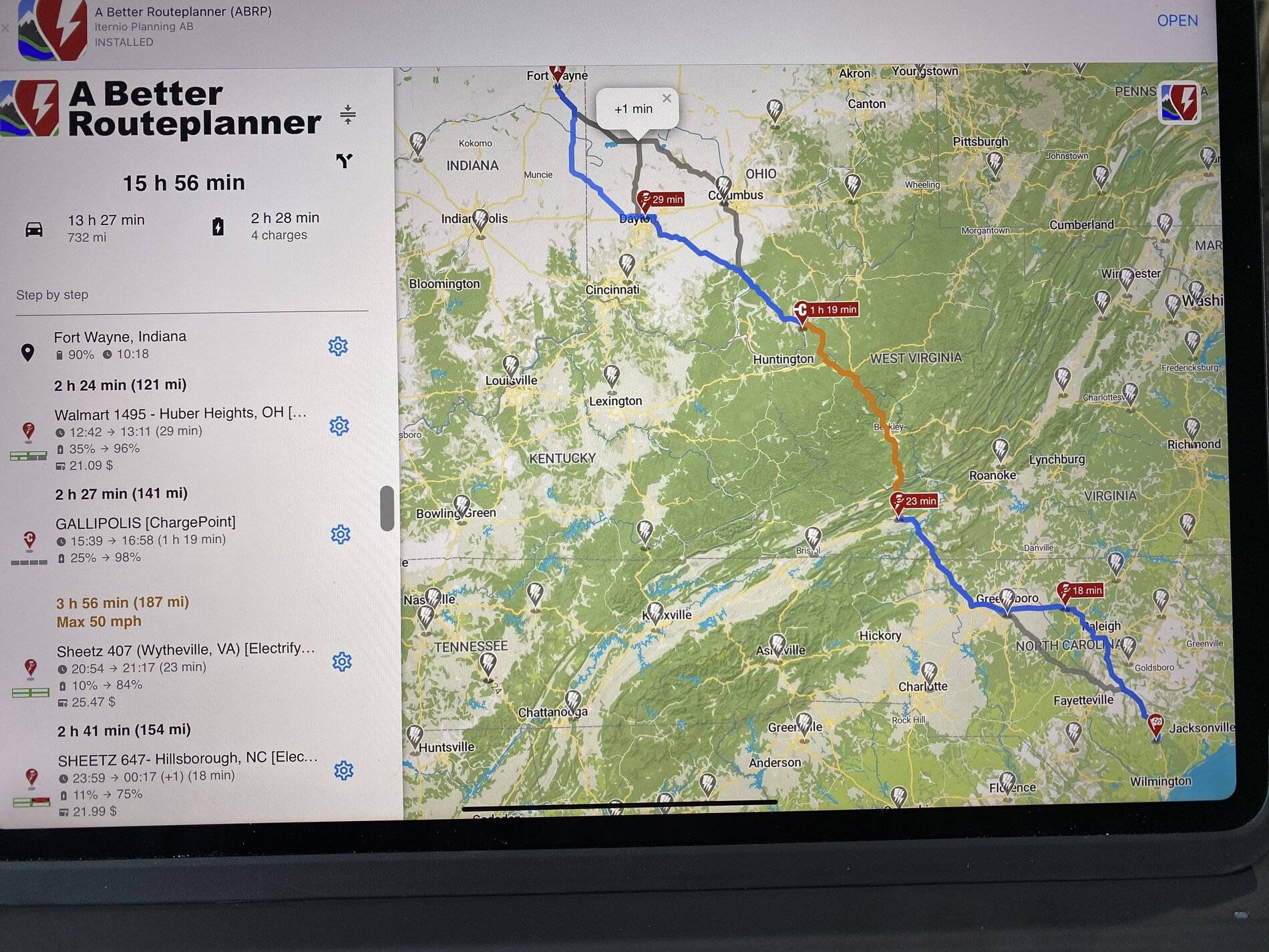

Been reading today about road tripping and just came across @evanevery’s post here: https://www.taycanforum.com/forum/t...rom-a-1400-mile-trip-in-two-travel-days.2580/
I take a golf trip from Indiana to North Carolina twice a year. Really want to take the Taycan on the next one (spring), but am concerned about 1 section of the trip.
I downloaded the ABRP app and plugged in my trip which looks like the attached image. The section in orange is what I’m concerned about....this section takes you though the mountains of W. Virginia and its the best part of the drive. I typically fly through this section as its filled with elevation changes (5-7% grades), fast paced curves, etc.... ABRP says “Max speed 50mph” through this section, I’m assuming to preserve battery. This will put me at Wytheville with 10% battery left. I’m a little nervous that I’ll run out of juice prior to that if I‘m driving in a spirited fashion. Any thoughts on this? Given that there are NO chargers along this section, it seems a little risky...what do you experienced road-trippers think?

yeah speed and cold weather will make that section dicy - 10% is a bit close but possible - I'd do the section even slow to "gain" some battery % - and as you make progress over the pass you can "add" speed as you get closer…10% is my threshold for "being careful" on a segment.

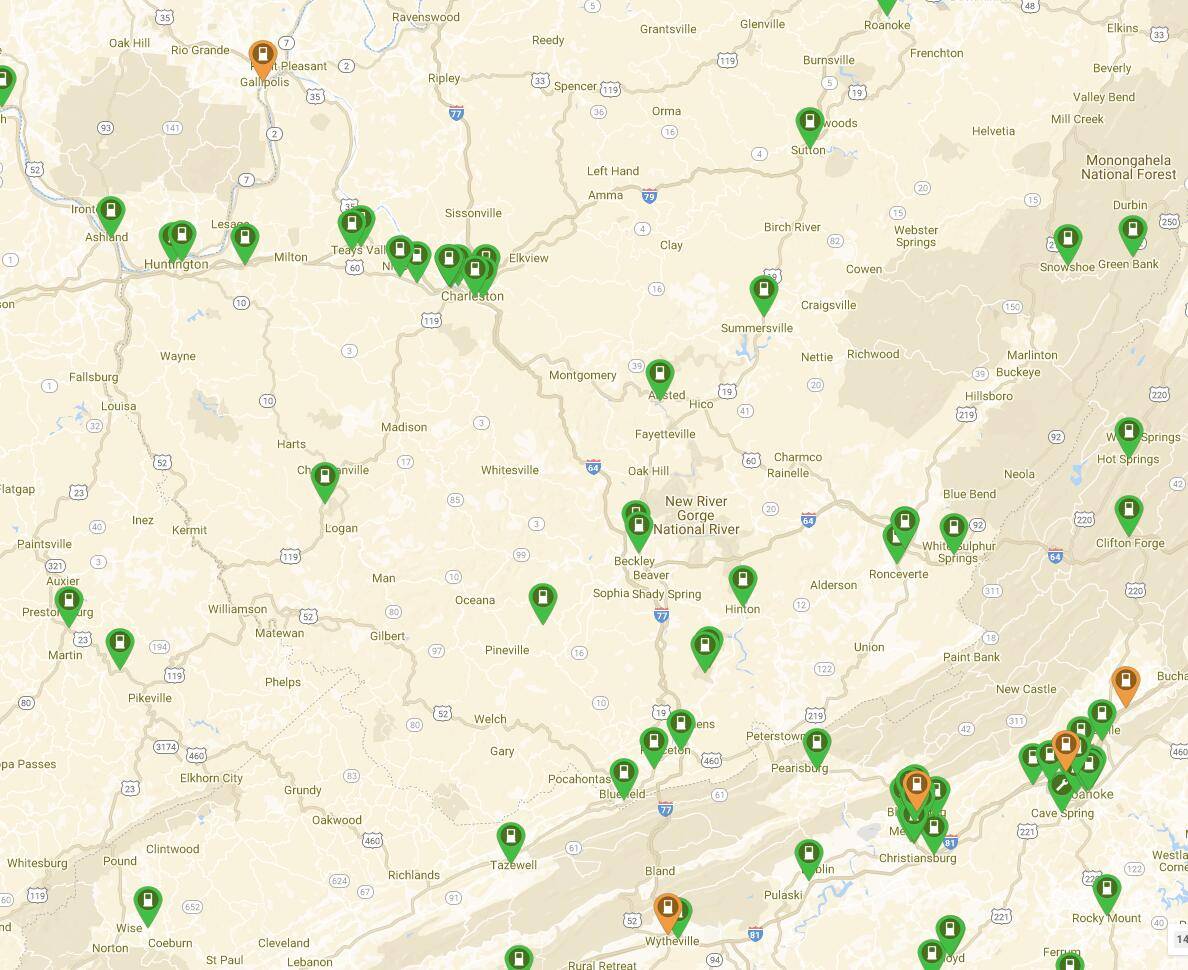

according to plugshare there are some "slow" chargers along the way -so you'd be unlikely to get stranded, but you may be delay'd - an hour or 2 stop (if necessary) in Charleston could give you a 10% buffer…

I would wager $1,000 you can make it through that section with much % to spare if you do range mode at any speed. I'd guess you'd make it through with a bit to spare if you went ham on it.
So you can range mode it no problemo or just be ready to stop at a slower charger if needed. Or range mode for a bit to gauge consumption than play around with the extra.
you are correct there are no "fast" chargers on this segment but there are plenty of "slower" chargers - a 1 or 2 hour stop can net you 10-20% battery - so you're unlikely to get stranded - but you might be delay'd…
see plug share picture below - the "green" pins are slow chargers which should net 10% battery per-hour (or close to that)

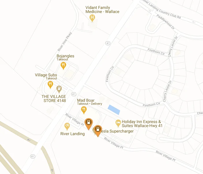

Thanks! I’ve been looking at Plugshare. Looks like I’m going to have an issue once I get to Wallace NC. THere’s a bank of 8 Tesla Superchargers at the hotel that we stay at, however, there are none that I can use in the Taycan and it looks like there are no other ones in the area. Might have to get to 100% in Raleigh before heading all the way down. I can figure that piece out when it gets closer.

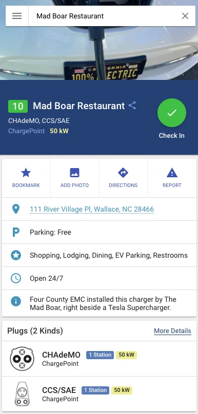

@jimshadow there are 50 kW Chargepoint chargers right next to the Wallace Superchargers - so you should be good…

@daveo4EV , did you find those on the Plugshare app? I don’t see them listed, but good to know that they are there. I know the MadBoar well! :)
Jim
yes screen shots are from plugshare…
