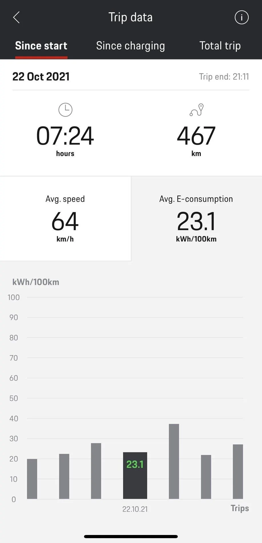

Pretty bad consumption on a recent trip. Box was off but roof bars left on. It was a wet day with quite a lot of water on the road. Maybe that made a difference?
Porsche Taycan Roof Box and reduction of range 72FAEDA0-D7BD-44C8-B1ED-401CB7579C1A
4,777
8,364
Pumping losses on a wet road are surprisingly high, probably more than many non-scientific types could believe.
