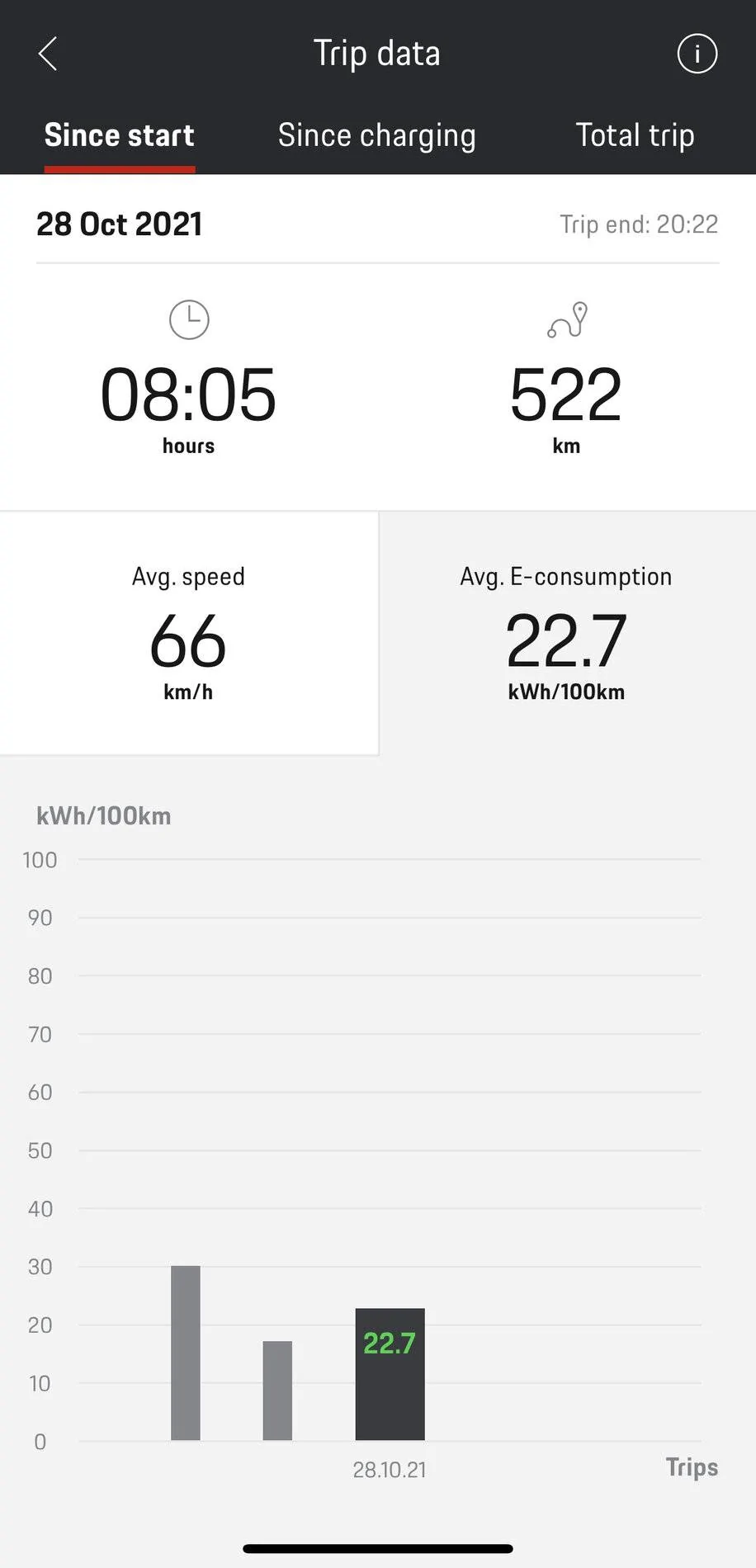

And slightly better on the way back… 130kmh in Austria 120kmh in Switzerland. A couple of stops and a fair bit of traffic reduced average speed. The roof box is a non issue for range.
Bob, you may feel it was a non issue for range because you averaged 40 miles an hour!!!!! That is like driving around in your neigborhood.
Double that speed and think your opinion will change.

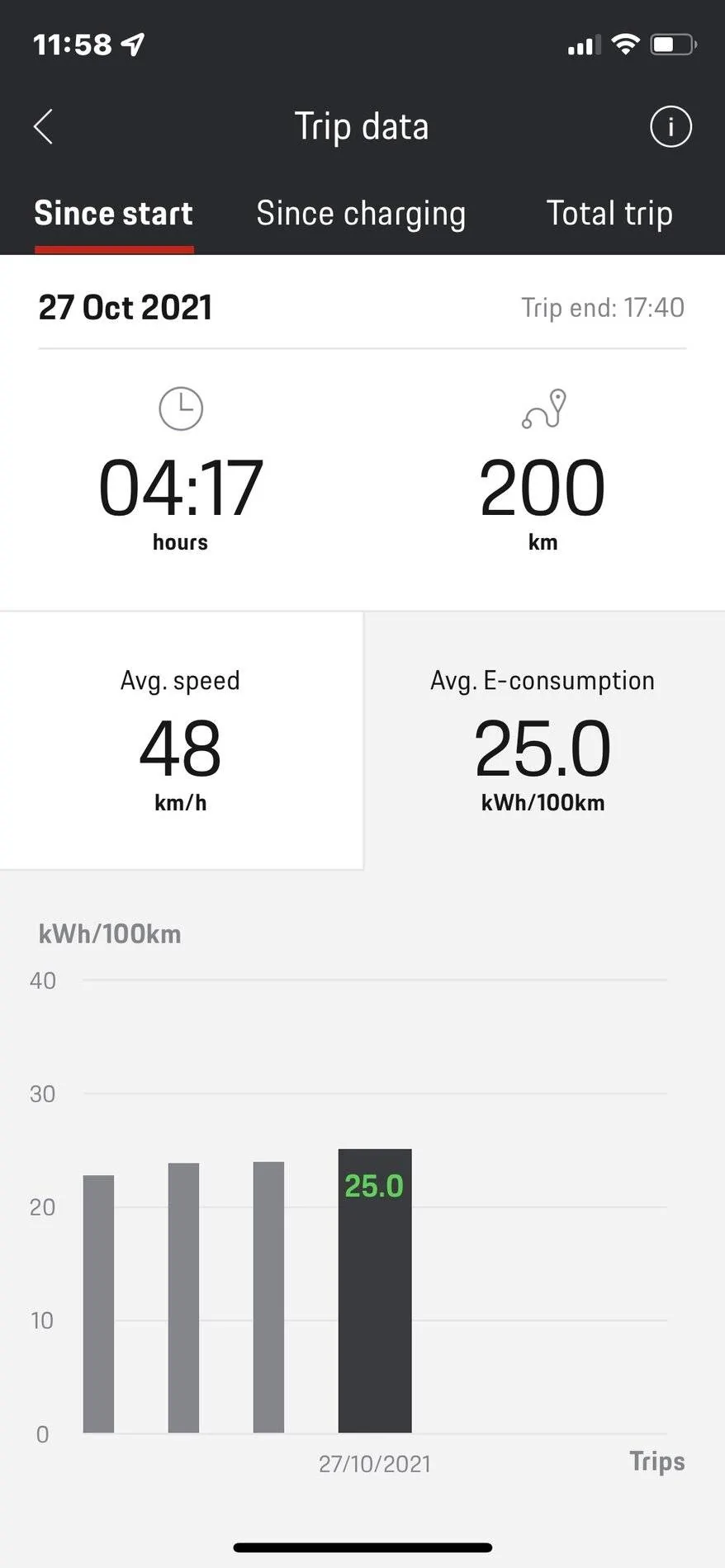

We’re on holiday in Austria with roof box. This is the journey here from Switzerland with full roof box at highway speeds. It’s the new aero Roofbox. Only 10-15% down on normal consumption
I am very impressed with how low your consumption is with a Roof box. I have not been able to get so low figures over the last couple of weeks without a roof box. And that is with a Taycan sedan. I guess I might be paying the price for the 21 inch wheels now that it gets colder??
Variety of driving on motorways at 110 km/h and lots of 70 km/h plus traffic in town.
did you get these figures driving most of the trip on the highway 120-130 km/h? In my current car the average speed is calculated with the car is switched on and not departure and arrival time. Does the Taycan also take the charging time to calculated the average speed.
It still is quite warm. Probably will be worse in winter.

Yep it’s mainly “highways” 120kph in CH, 130kph in Austria. There are several 100/110 sections, a few non highway sections and also a few traffic jams where we were at a standstill for a while eg around Zürich hence the lower average speed.
The temperature makes a bigger difference. Starting cold in Austria and driving up some mountain passes with temps around zero the consumption was much higher. But these were shorter journeys so range anxiety not an issue. There were also some 22KW chargers in the ski resort car parks which were handy (if pricey compared with Ionity).
