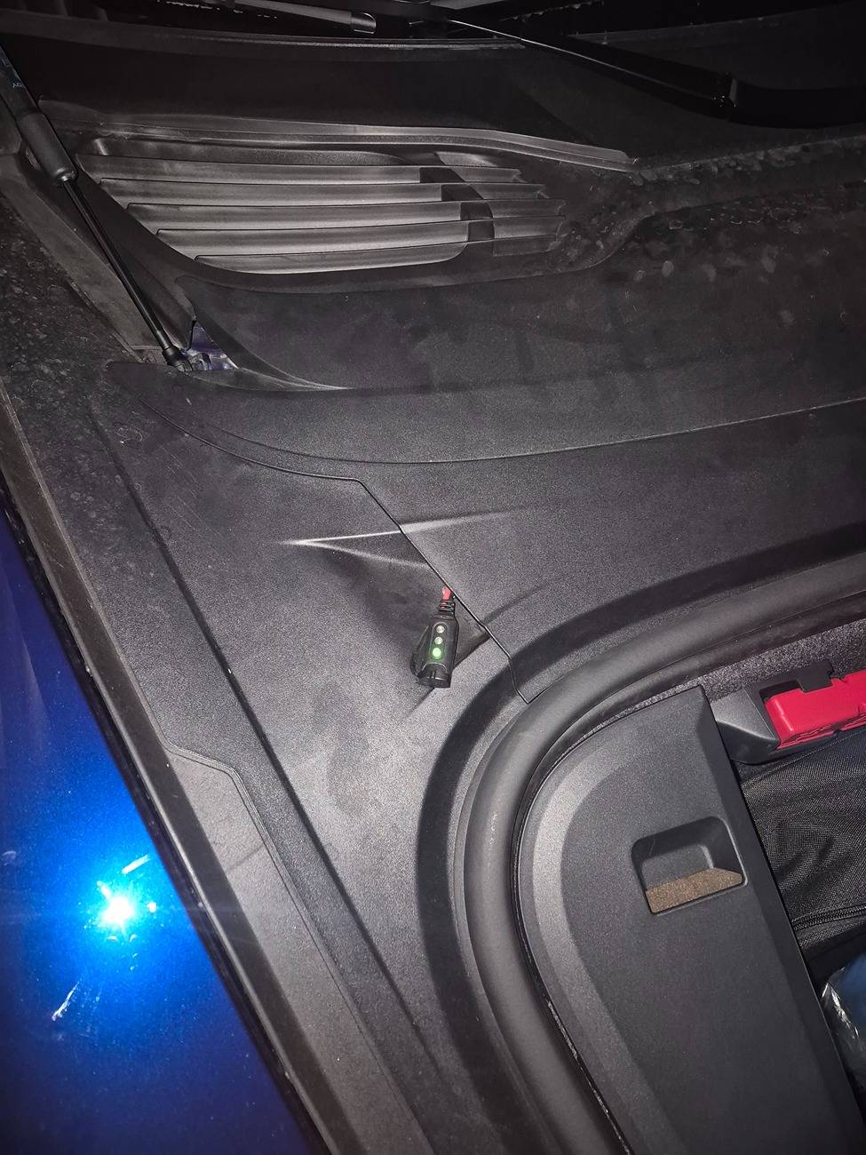

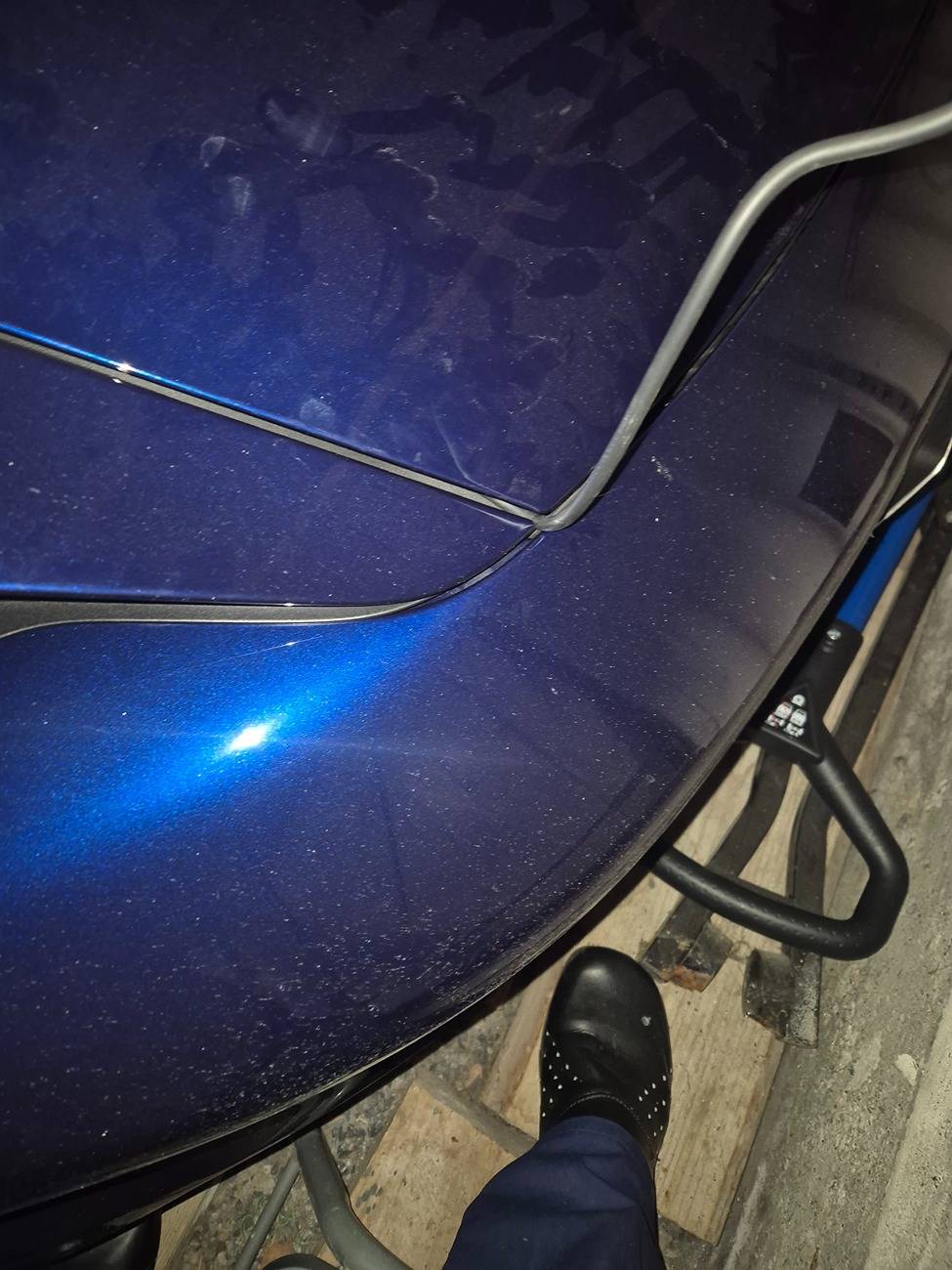

For those who use a battery tender/conditioner on their Taycan 12V battery, how did you get the power wire out from the frunk area? (Other than leaving the frunk open - we are parked outside so that's not an option.). It seems that the area flats shut all around the bonnet, and also there is a little wall at the top where the windscreen washers go. Couldn't quite figure out how to run the cable without crushing it.

My original question was less about where to put the clips, but more how we route a cable out of a locked waterproof area without crushing it. I guess feeding it through the corner is the best, but it is still crushed.
I guess the risk is just that the cable may break, but there could be a worst case where the positive lead shorts to the car and … bang.

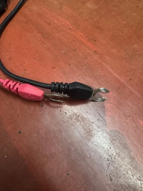

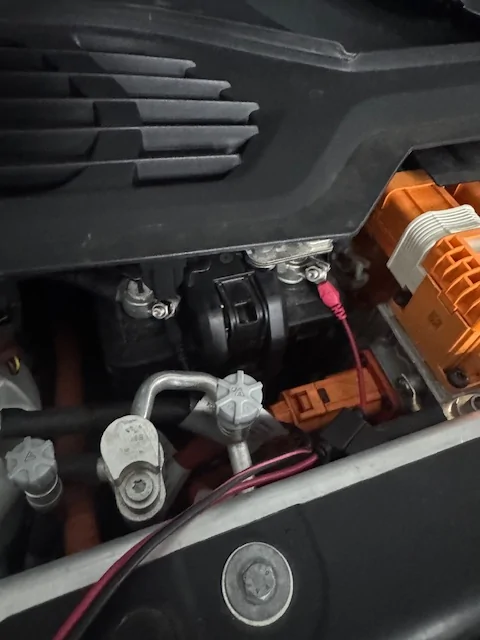

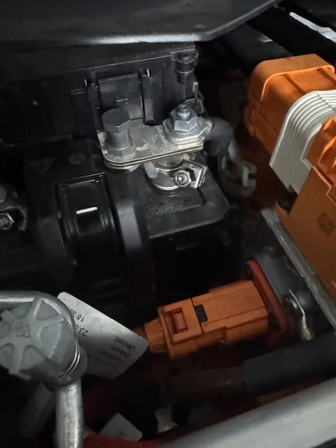

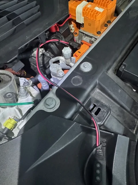

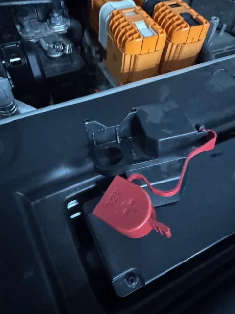

To connect the cable to the positive terminal, remove the cover that hides the + terminal from the battery.
I discovered the same with the positive terminal a few days ago.
HOWEVER, your negative should not directly connect to the battery. I think I read that it may confuse the car’s battery monitor and cause problems with the HV battery topping it up. The negative of the CTEK charger should be attached to the chassis ground point from
https://www.taycanforum.com/forum/threads/routing-ctek-cable.23342/post-358027 - unscrew the bolt near the shock tower and place the charger eyelet under that.
Since the negative terminal of the battery is connected directly to the car's chassis, it doesn't matter where you connect it.
