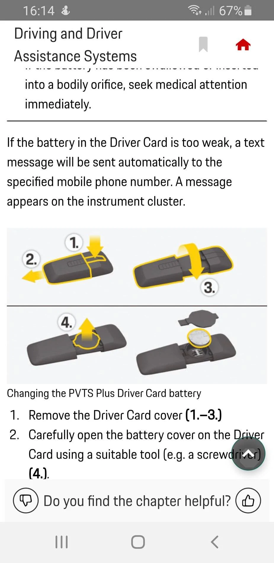

Simple.
Get the Porsche Good To Know App and search PVTS.
Porsche Taycan Security fob battery replacement please help. Screenshot_20210221-161425_Porsche Good to kno
I'm guessing it's a CR2032 but when you open it you will see what is marked on the battery.
Out of interest why do you think the battery is flat - did you get a text to alert you?

Simple.
A message came up on the dash to say, not on my mobile.
