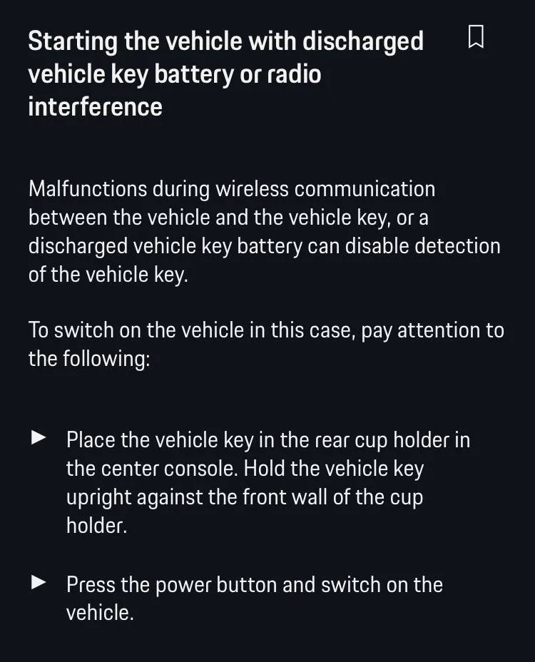

Hirschaj Well-Known Member First Name Jim Joined Sep 5, 2021 Threads 68 Messages 2,223 Reaction score 2,617 Location Austin TX Vehicles 2022 Taycan CT4 - Mamba Green, 2022 Challenger Sep 5, 2022 #2 The manual states that only Porsche dealerships can teach the car about keys. I assume you can’t even start the car to get it to the dealership. Have you tried this procedure yet to get it started?
