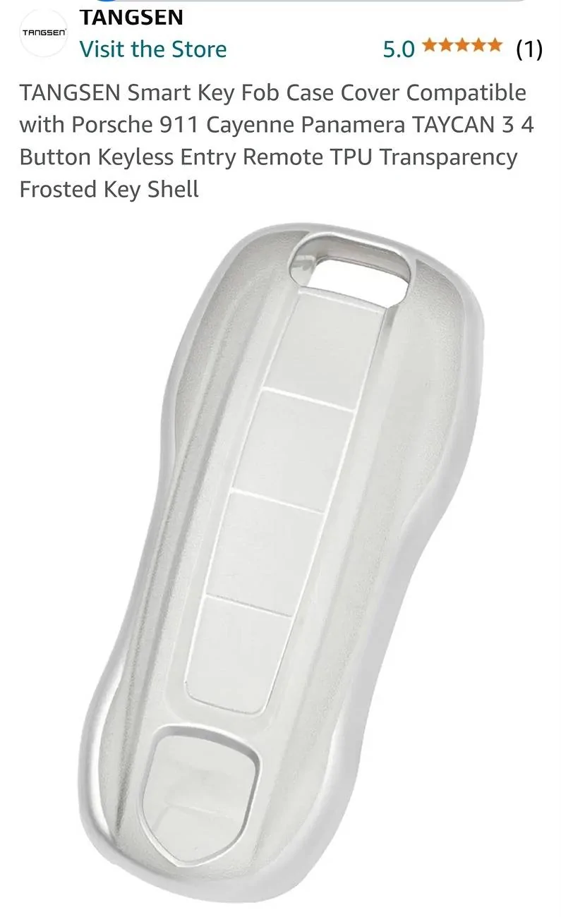

Not exactly the software fix you want, but a solution that works for me. I bought the case below through Amazon and the thin plastic adds just enough tension that I never have a problem with accidental button presses. The bottom plastic is a bit thicker (the case is a two-piece clamshell) so no worries about accidentally hitting the panic alarm either.
Porsche Taycan disable frunk button on key fob 1000002363

interesting idea may give it a try
What's the panic alarm? Not come across this before.
ShiftyWolf
Nov 16, 2023
524
656
Central Florida
Red button on the bottom of the key fob. Does the UK version not have it?
