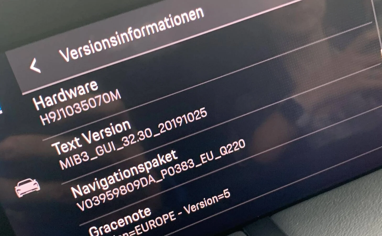

I did the SW update today at my PZ (Porsche Zentrum) in Germany. I figured out the SW Version (all you can see on the PCM) doesn't changed. Was that update in the backend (controller etc) without showing a new SW update on the screen?
The technique guy from PZ told me the SW Update has happen...but I can't see it. Same experience to the others?

Miwa
Oct 3, 2019
820
860
Bay Area, CA, USA
The screen only shows the PCM version, not the versions of the firmware on all the other ECUs in the car. You have to hook up a service tool like PIWIS to query all the ECUs for versions.
