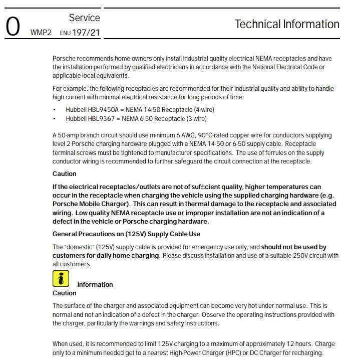

ROFL - porsche wants 6 gauge wire for 50 amps to feed their woefully under spec 10 gauge supply cable
that right there is all you need to see to know they screwed up the the PMC+/ PMCC supply cable!
now if they will only follow their own advice and give us all a new 6-gauge wire power supply cable we'lll be good.
6 gauge wire is a great choice for 50 amp circuit - they should do the same for the EVSE supply cable
Shhhhhhhhhhhhh..........................
(Anyway, everyone knows 10 is larger number than 6, so shuddup.)
