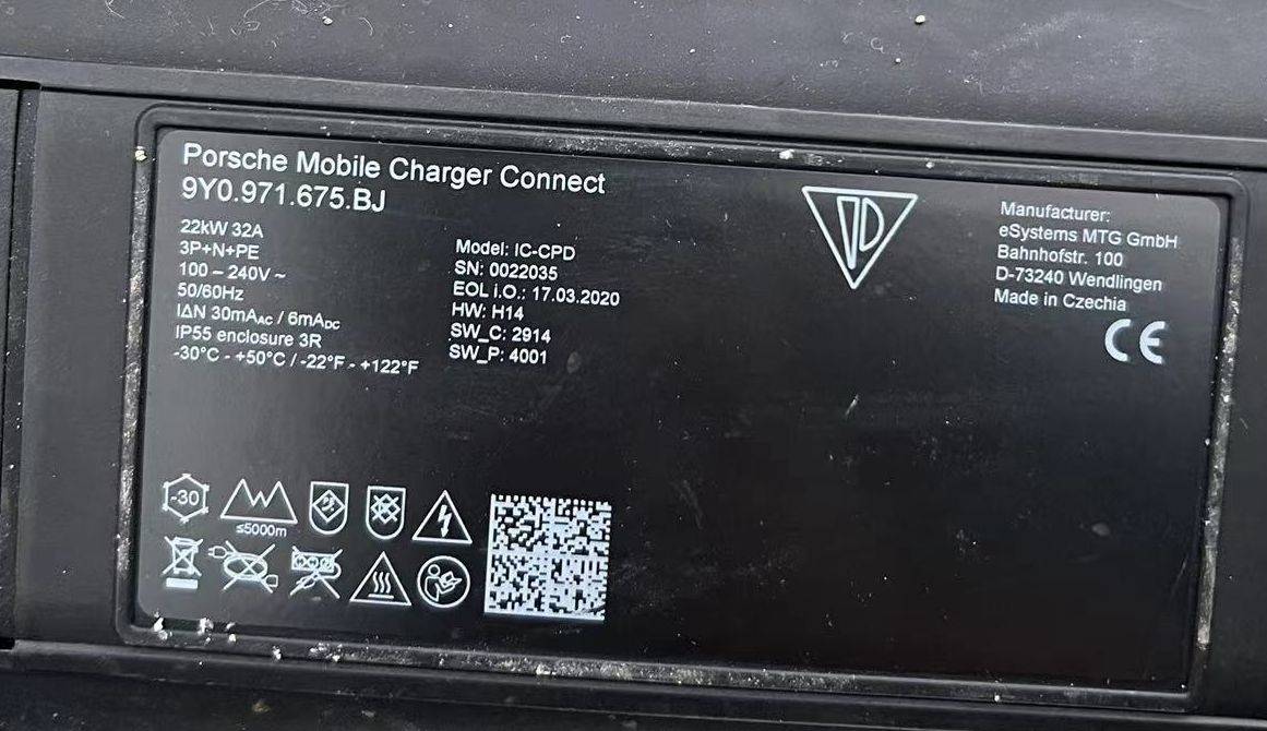

Thanks Damien. Will ask Porsche dealer to find out before calling electrician to install 3 phase socket. My PMCC also indicate 3P+N+PE. Most Norwegian houses don't have Neutral line.
Porsche Taycan Show your home charging setup for your Taycan Porsche PMCC 9Y0.971.675.BJ 22kW 32A

Thanks David. I see that you have neutral line on your configuration. My question is if Porsche PMCC works on 3 phase 240V supply without neutral line (L1, L2, L3, PE).
The eletronic engineer did that for me, I have no idea about neutral line :)

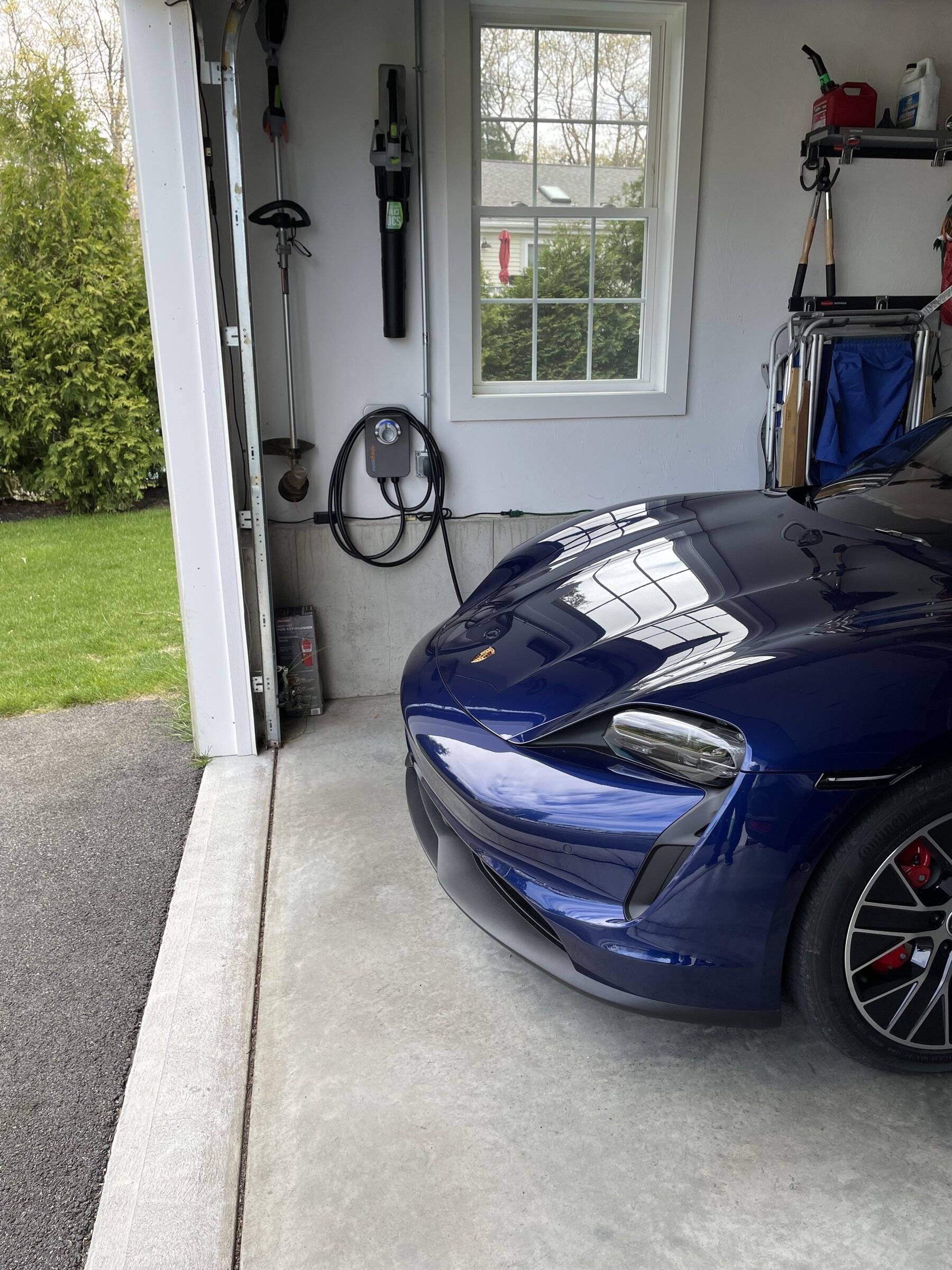

Juice Box connected to NEMA 14-50 outlet connected to 50 amp breaker using 8 gauge wire.
Porsche Taycan Show your home charging setup for your Taycan E4736AFD-0B51-461F-B9EB-682B02910277
Do post what you find out. I often wondered if there was a special Norwegian version. Maybe if neutral isn't connected – the device goes – oh, I'm in Norway mode – I know what to do! Maybe!
For sure the Juice Booster travel charger does that in Norway.
Is there any specific reason why Norwegian electricity network is like this? I don't even understand how electricity flows without a neutral – I assume its not down the protective earth wire (PE)?
Multiple phases and usually an earth means you don’t need an actual neutral if my understanding is correct. How and why is beyond me.
This entire video is very good for explanations but looks like the answer to our question is at the bit I've bookmarked:
Because the three live wires are out of phase, each live wire can act as the currency return path for another live wire and thats why neutral can be optional on these circuits.

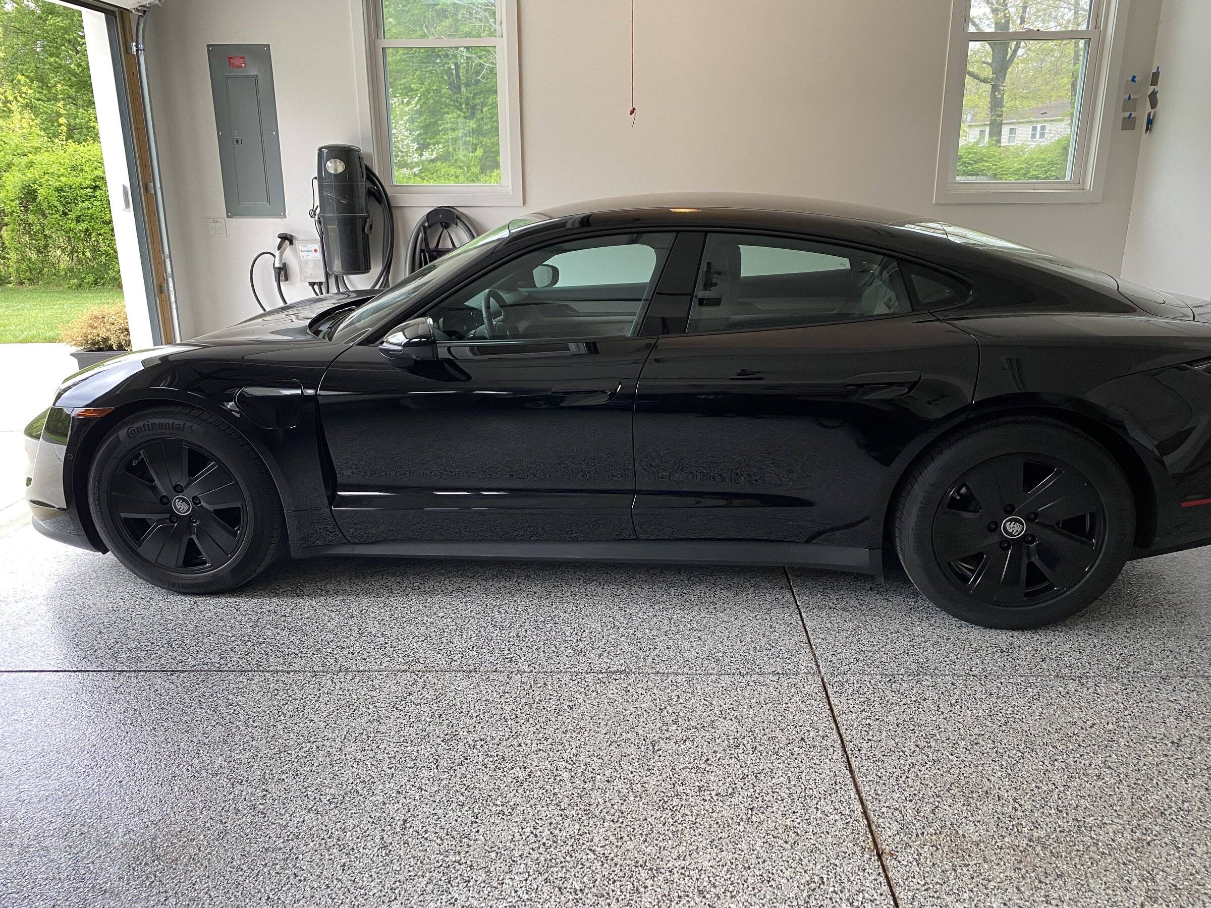

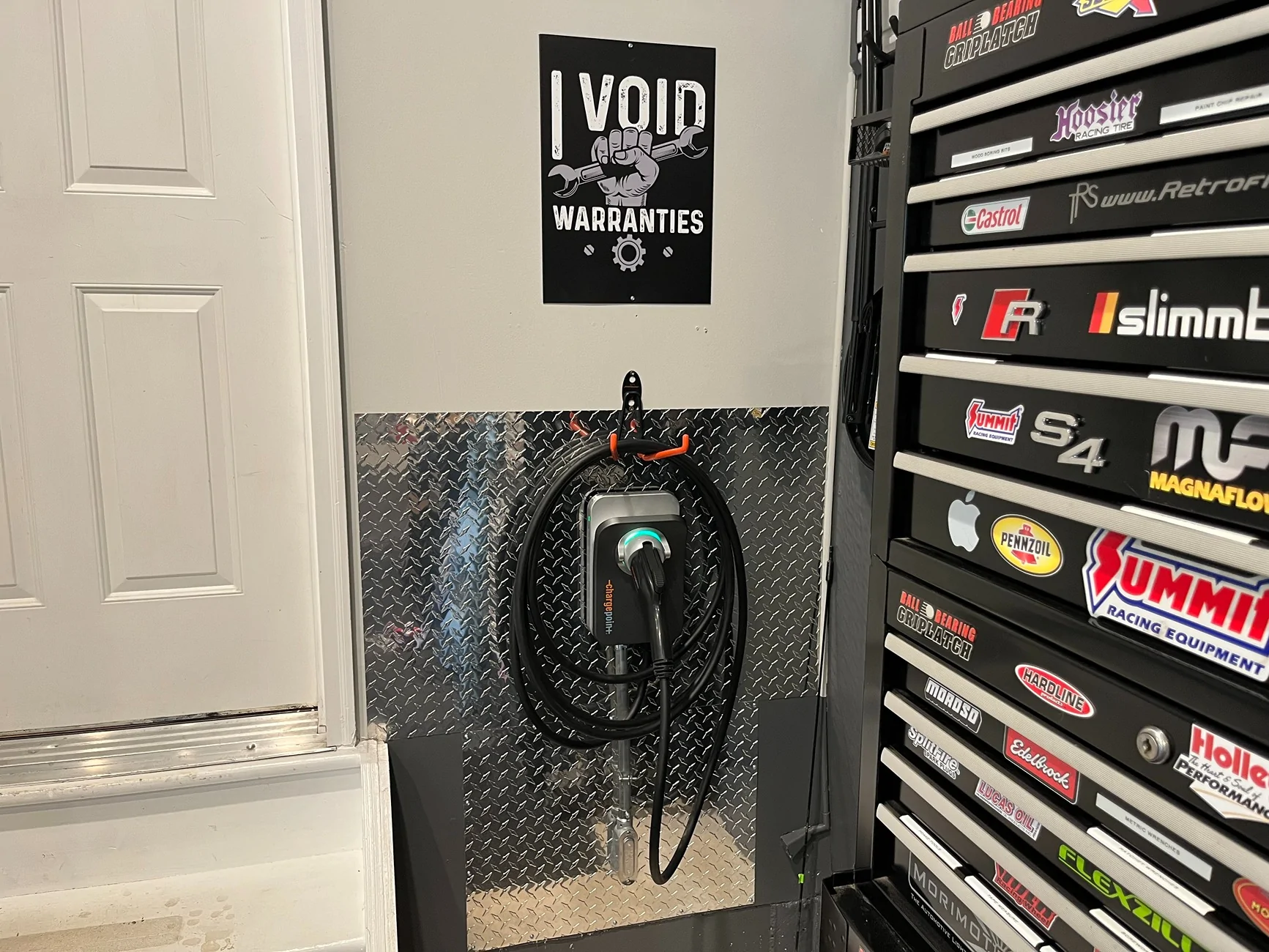

Outside and in the driveway making it convenient to charge our own cars and guest cars. I briefly considered a garage install, but it's not like I am charging every day.
Porsche Taycan Show your home charging setup for your Taycan IMG_8604

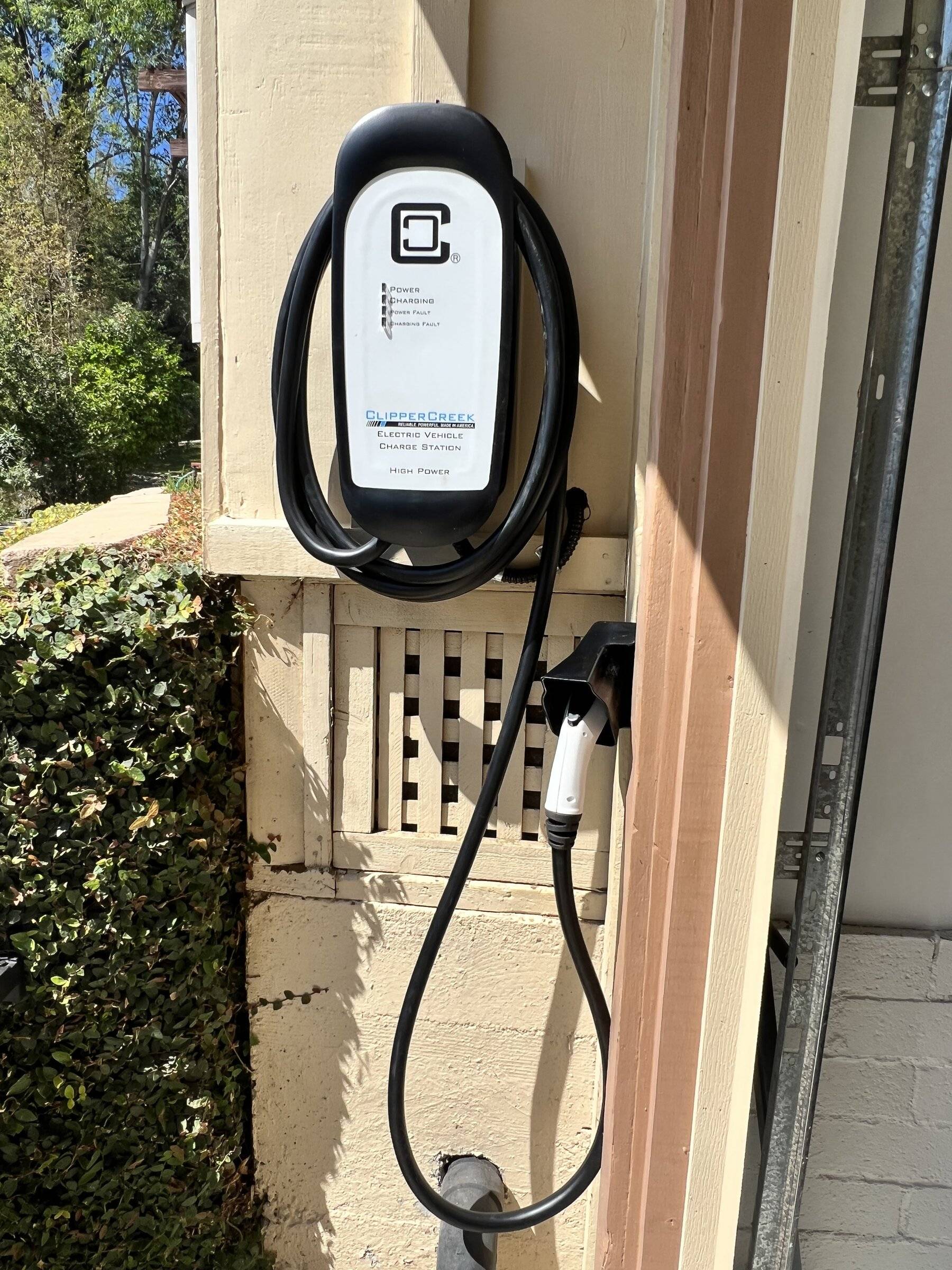

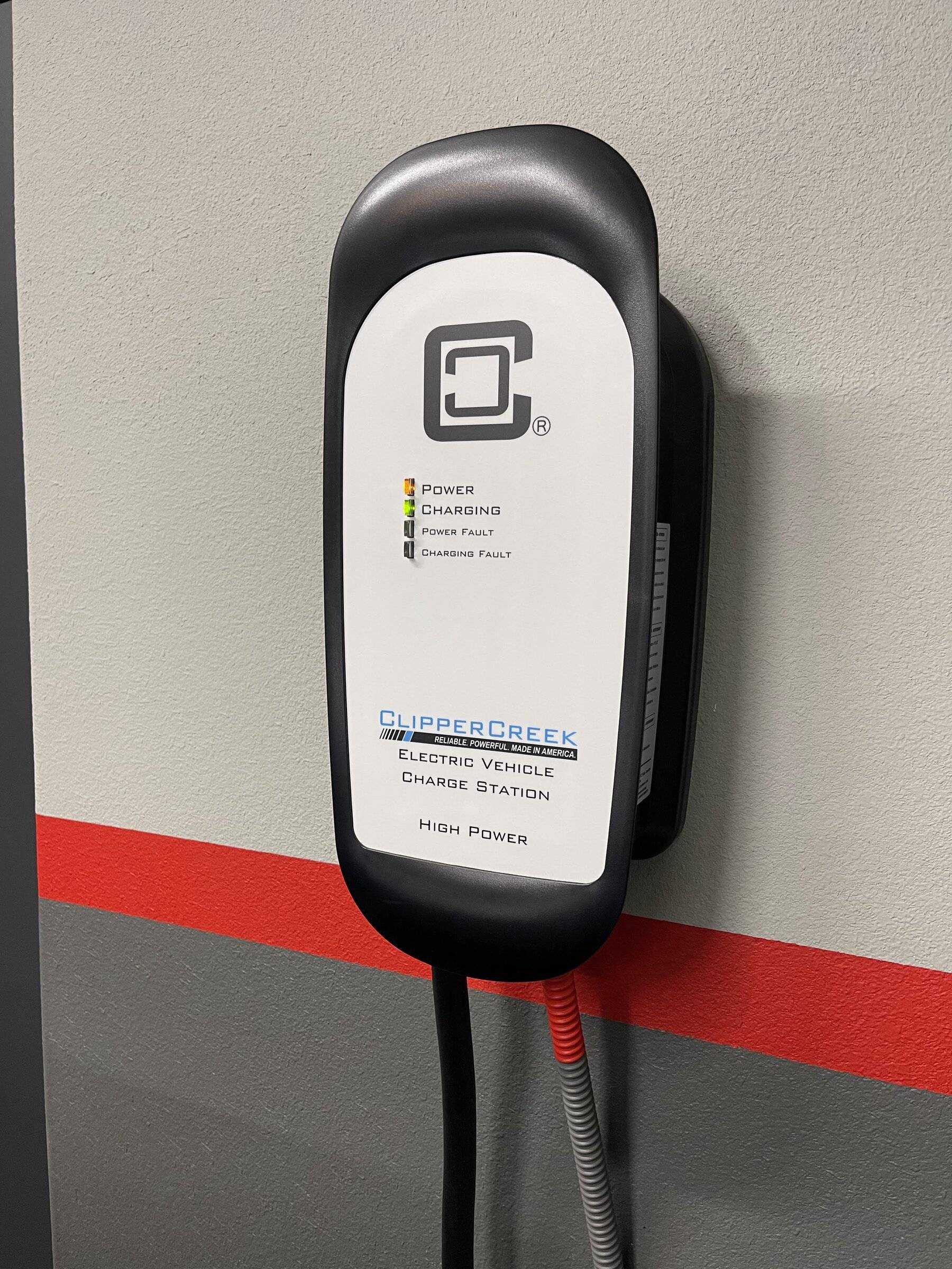

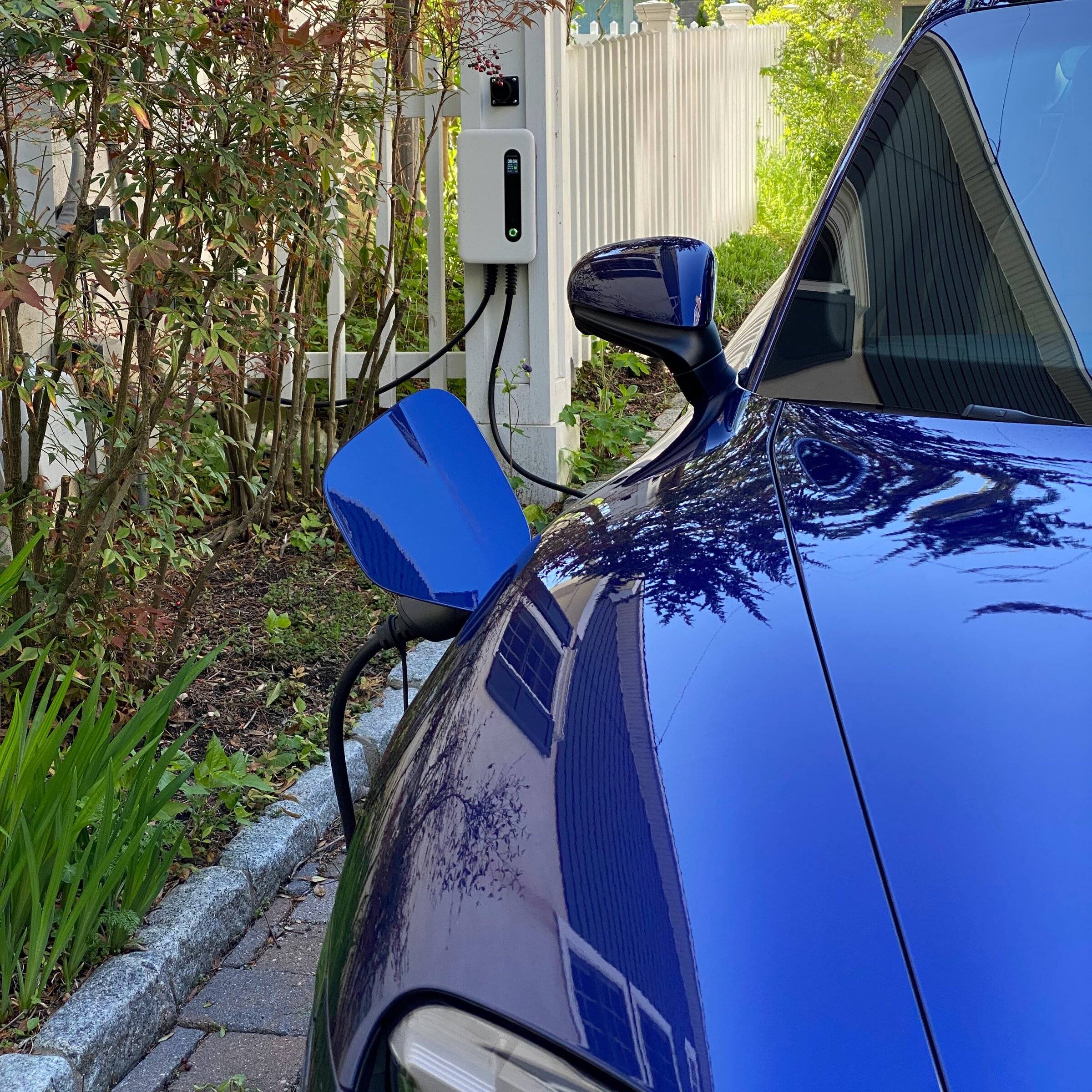

Finally picked up my car a couple of weeks ago, and got to use my home charger. I opted for an 80A Clipper Creek (was hoping for 100A), as I only had a 1" conduit from my panel, which was a long way away, and through a thick cement stem wall. Even though I am not getting the full charging from the upgraded onboard charger, I am still very happy with it.
Interestingly enough, the Clipper Creek factory is only about 10 miles from my house. :)
Porsche Taycan Show your home charging setup for your Taycan IMG_2975
Porsche Taycan Show your home charging setup for your Taycan IMG_2974

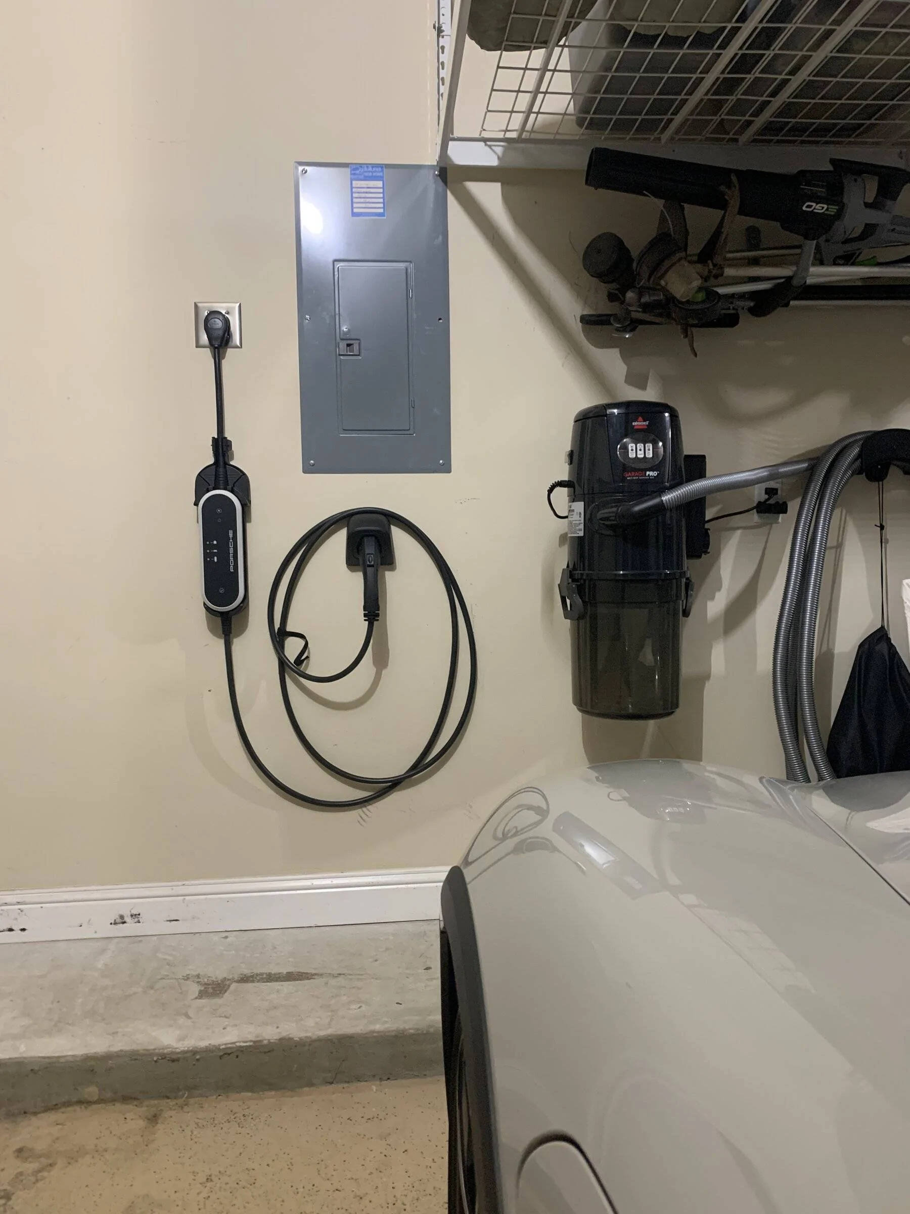

Here’s my very basic setup…
Porsche Taycan Show your home charging setup for your Taycan EB7097F8-5AEE-46D7-8F27-2B5490A665F8
