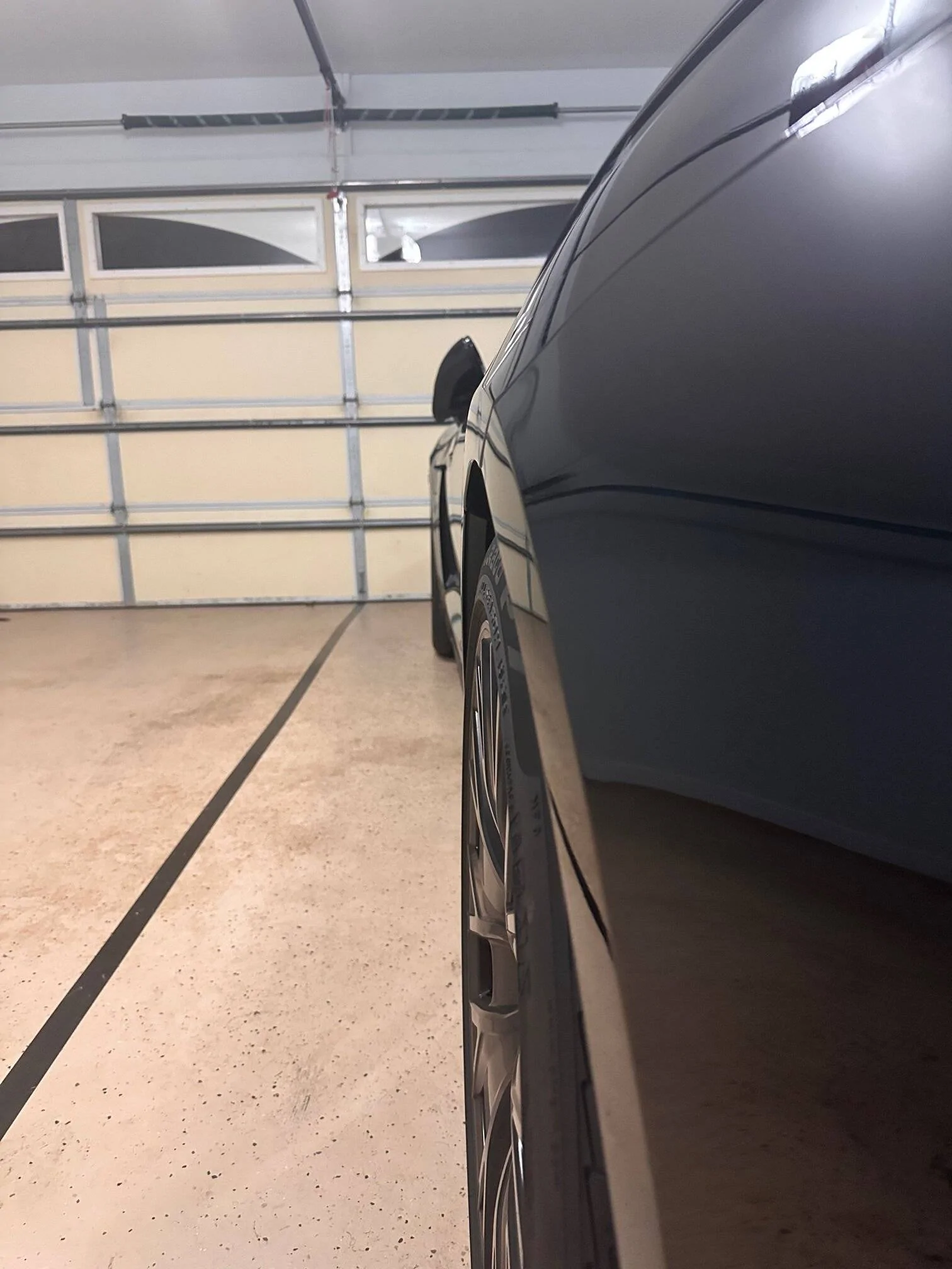

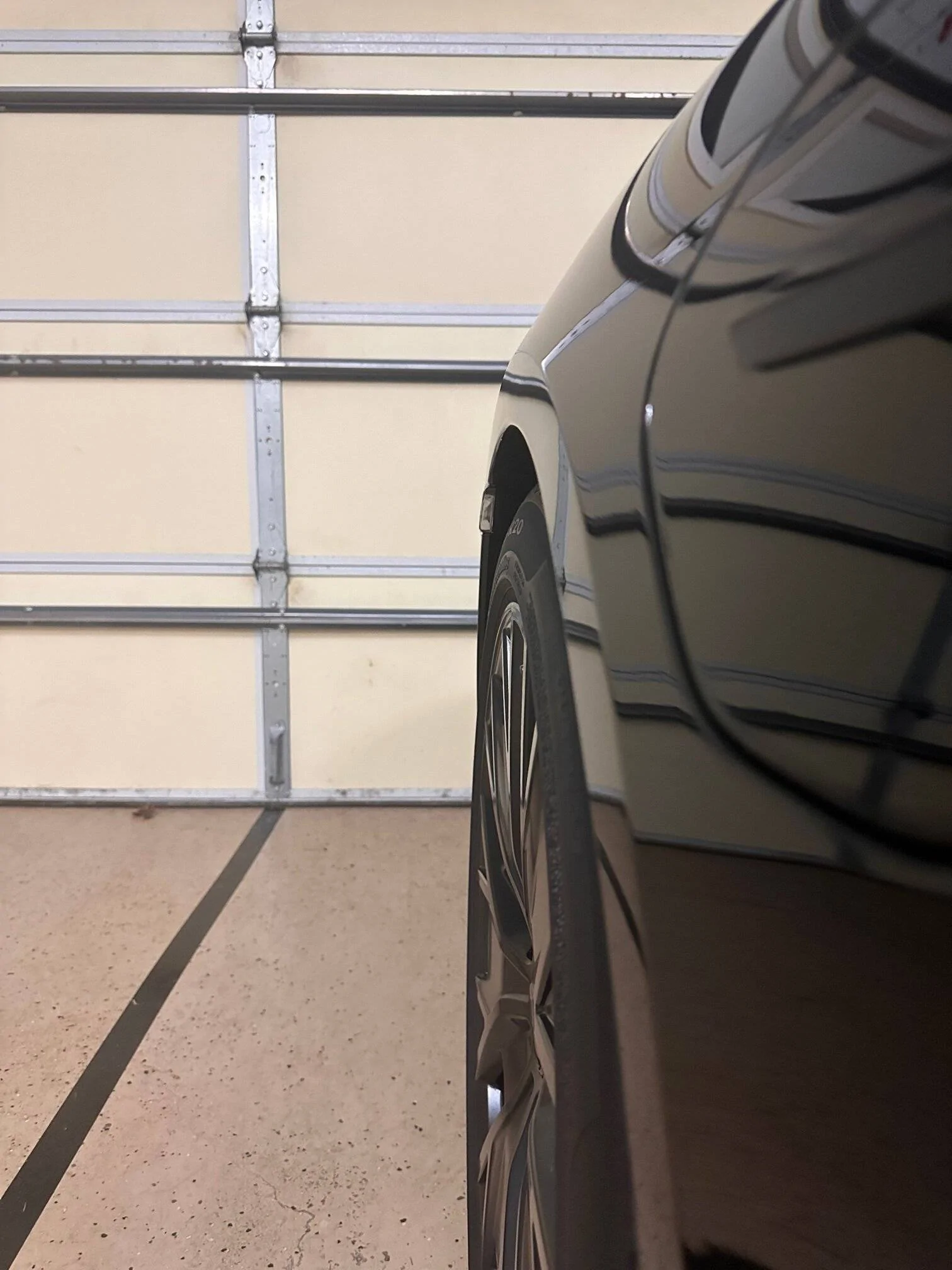

Hadn't seen a thread on this but thought I should post for anyone wondering.
After some time looking at threads on here, I bought 12mm spacers from 4wheelspaces. Installed them last week and gave the car a good week to settle back down before taking some pics.
As you can see in the pics, for the 20" Turbo S wheels, 12mm isn't enough. I like a nice flush fitment and both the fronts and rears still look far too sunken in. I took it by a local Euro shop who felt atleast another 5mm on both front and rear to get it closer to the look I'm looking for.
For comparison, a friend of mine got his GT4 the same time as I got my GTS. His GT4 came stock with an absolutely perfect stance.

I'll keep an eye on the inside wear but I think it's worth it for the look if it looks "perfect." I've had spacers on most of my cars for almost 15 years and haven't had any noticeable issues with uneven wear.
New rims that fit better is obviously the best answer! Probably what I'm going to wind up doing next year when I get bored with the look.
