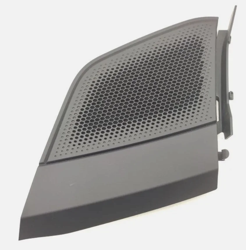

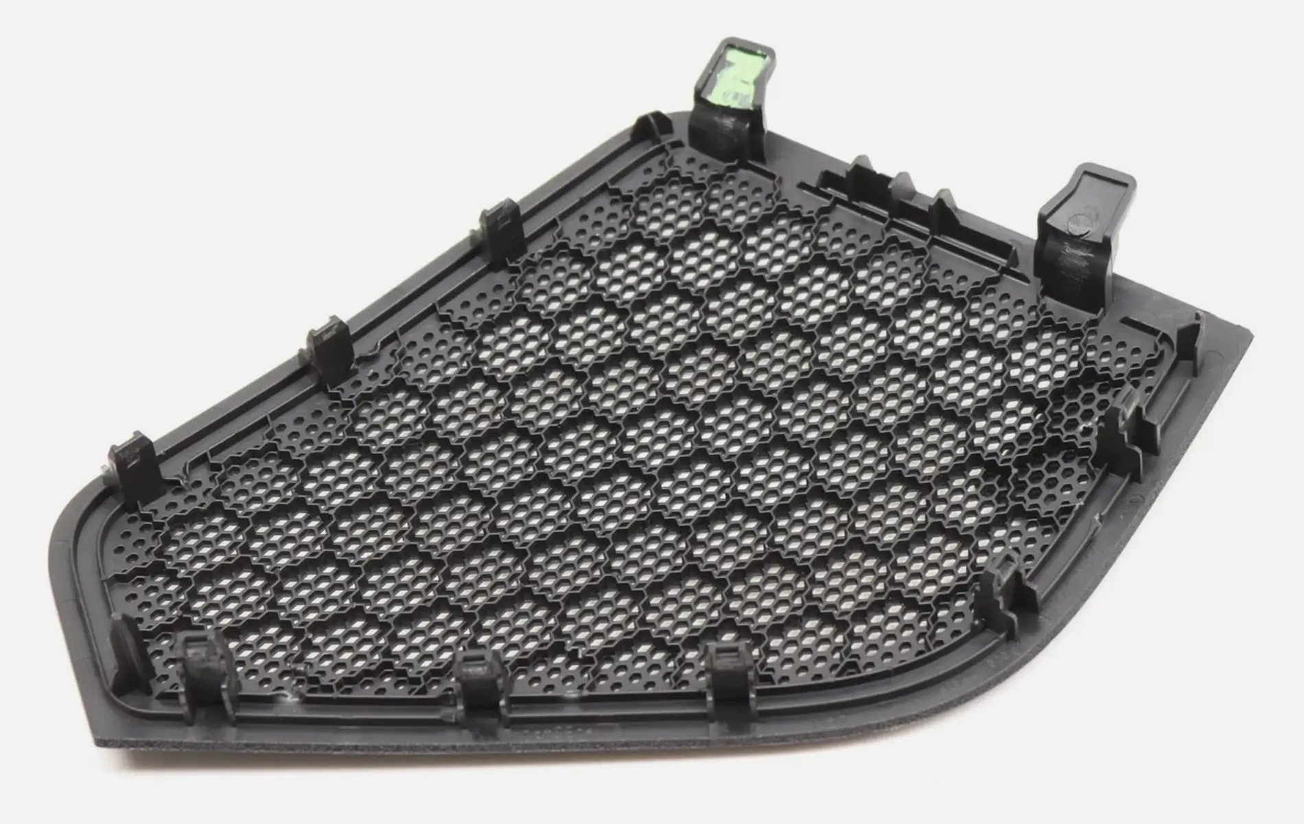

This image may help you figure where to ease off:
Porsche Taycan Speaker rattle - rear left door 1768649429074-56
Porsche Taycan Speaker rattle - rear left door 1768649394236-6z
Porsche Taycan Speaker rattle - rear left door 1768649544737-z9

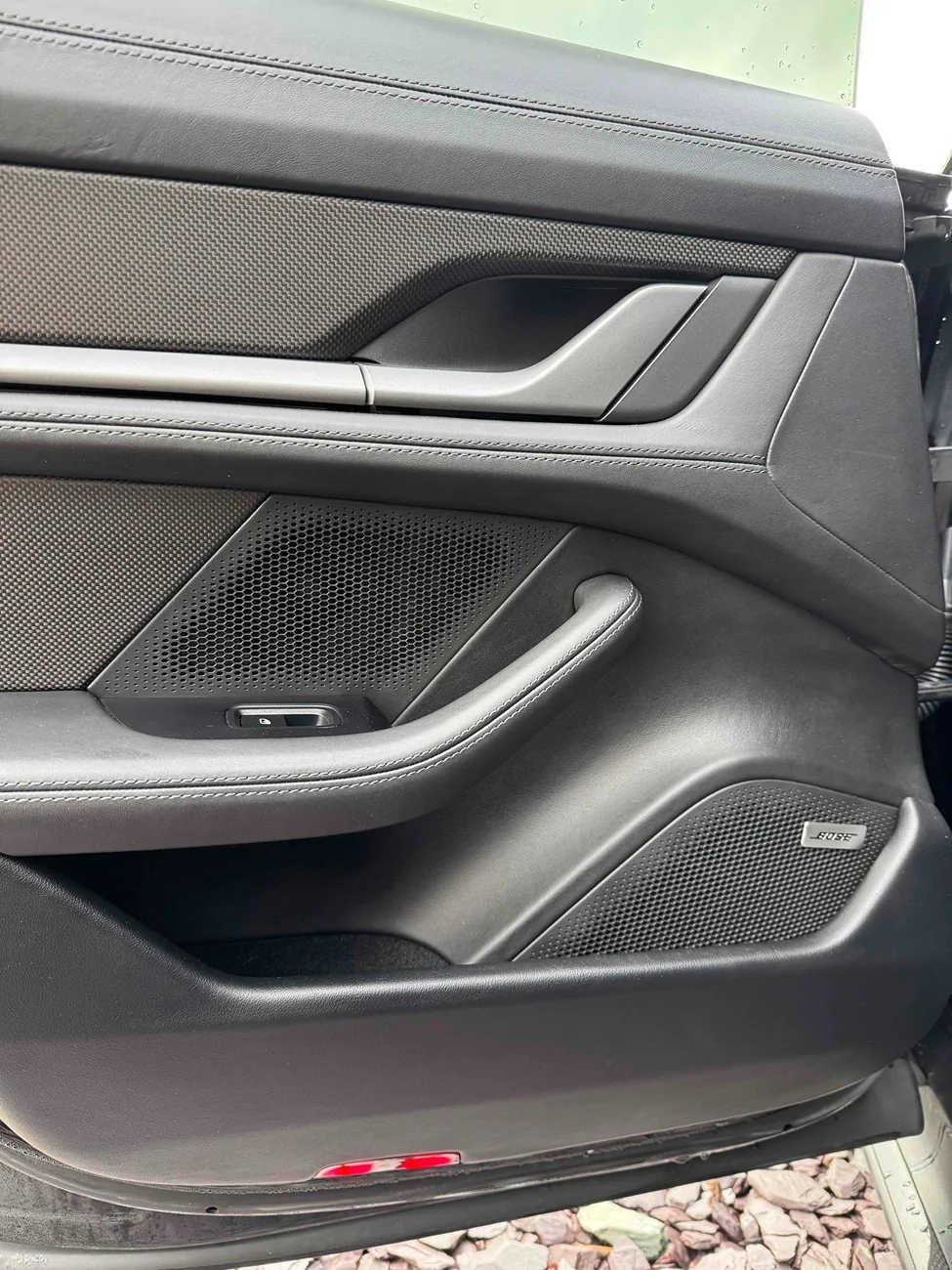

Thanks for the reply!
I have the Bose speakers, and here's a picture that shows the arrangement. It's the speaker grille right next to the window switch. Applying pressure on the grille stops the noise.
Porsche Taycan Speaker rattle - rear left door IMG_8374

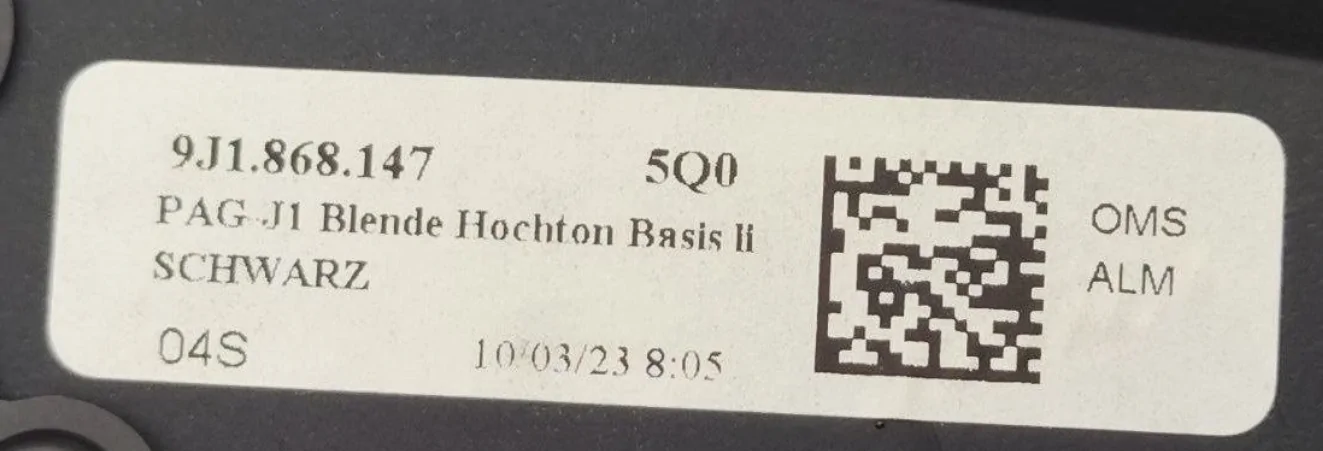

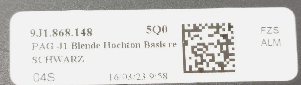

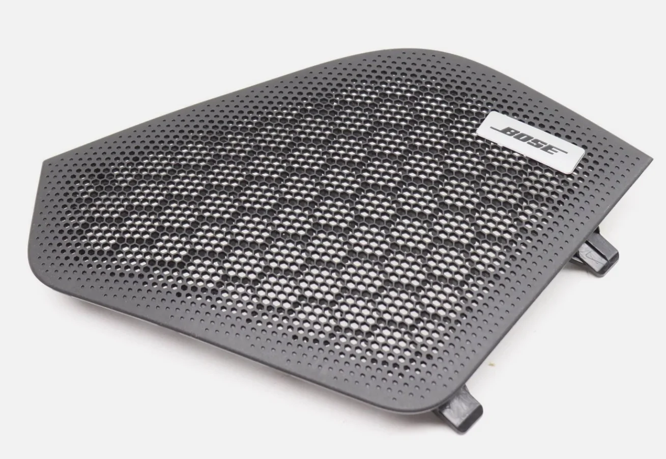

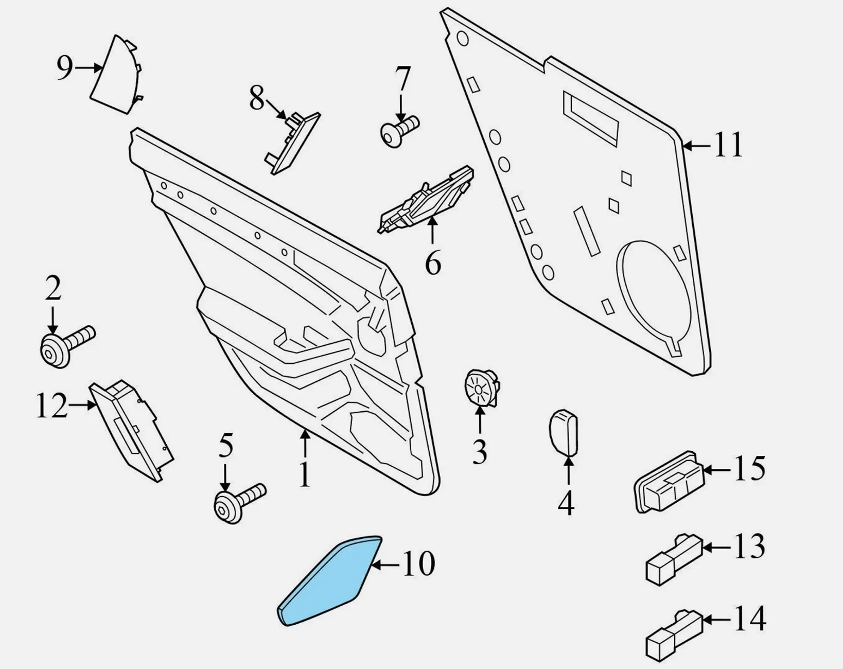

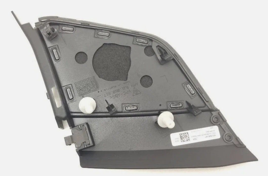

May be more involved than simply prising off and require the entire door card to be removed
Porsche Taycan Speaker rattle - rear left door 1768650297947-94
Porsche Taycan Speaker rattle - rear left door 1768650328040-m2
Porsche Taycan Speaker rattle - rear left door 1768650356773-9
LHS Part#
Porsche Taycan Speaker rattle - rear left door 1768650445622-nt
RHS Part#
Porsche Taycan Speaker rattle - rear left door 1768650494639-1a
