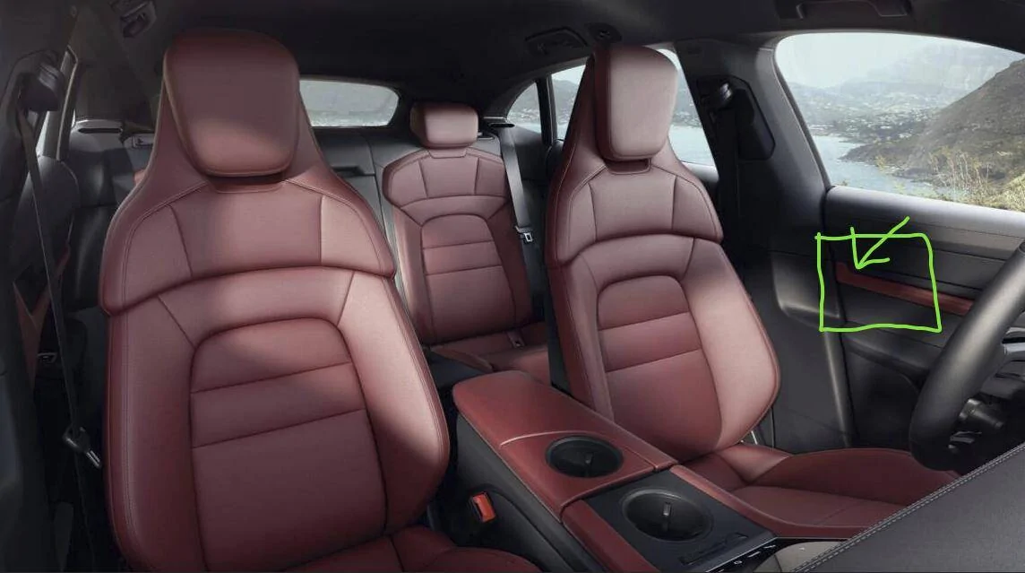

4+ years later, mine also developed a rattle in the upper side of the passenger door.
Something rattles when going over bumps / playing music even at low volumes inside the door panel. When even slightly pressed, it stops.
Porsche Taycan Rattle/vibration from upper door 1739814371117-m1
How much does Porsche charge to fix this? I do have Porsche approved warranty, but I'm not sure if they would cover this.
