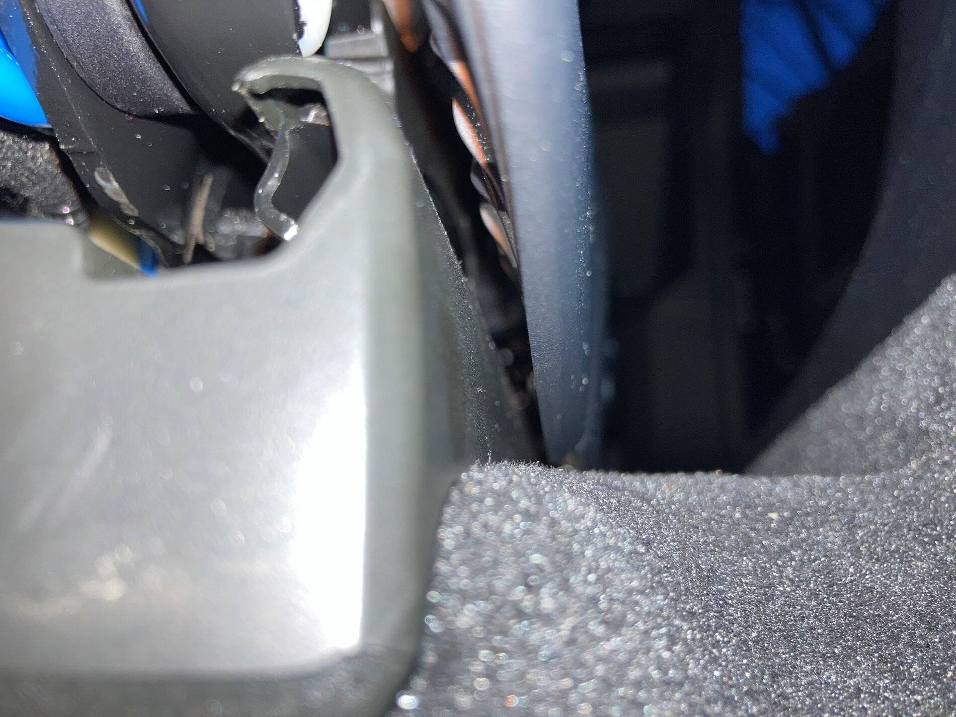

Think I’ve found evidence of what’s been happening. In the photo you’ll see part of the seat frame with a patch where the paint has clearly worn away and is showing bare metal. It’s not present on the other side (pictured is the side nearest the door). I think when the seat flexes that part is rubbing on part of the seat rail.
The solution? I expect realistically it’s either to have the seat a fair bit higher, not ideal and not something I want to do, or maybe try to get a dremel type tool in and shave it down. Will need to cover the seat rail to avoid shavings getting in there and causing other problems. Would be a pig of a job.
Before I do that I’ll get my wife to sit in the seat and push back while I have another look and see if I can catch it happening.

Oh yea - the photo!

Thanks for the update. I wonder if that is the cause. Please let me know once you’ve tested with your wife and then I can replicate your fix!
