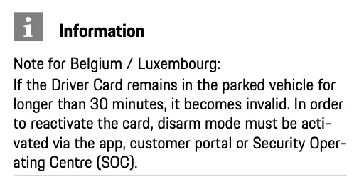

I’m not sure you can leave it in the car, for sure I read that in some countries at least, if it’s left in the car when the car is switched off for more than 30 minutes it is deactivated!
I had forgotten that – looks like its for Belgium & Luxembourg.
Porsche Taycan Standard tracker vs category 7 aftermarket Screenshot 2020-11-22 at 10.13.05

in the UK you can leave the fobs in the car. Obviously the point is you remove from car but I’ve left mine in the car for weeks with no problem.
