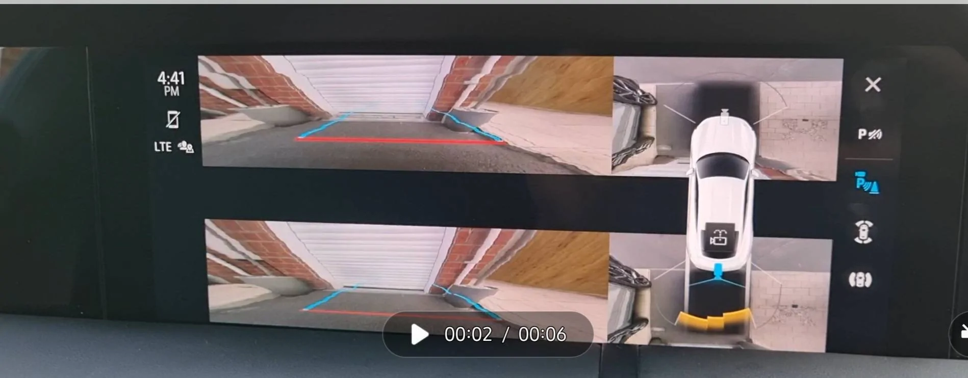

My screen has just started flickering and going mad when the reverse cameras are on.
Attached screenshot gives an idea, but it's jumping about all over the place.

Did you get this sorted W1NGE?
Yep, it cleared months ago so was a one time thing. Mine wasn't as bad as yours but again I think software related (boot sequence).
I'm in Granada just now and the car is in Glasgow airport BUT Porsche Connect tells me it is actually in Edinburgh where I started the journey!
Thanks W1NGE.
Mine cleared the next time I started the car and has been fine since.
Obv just another software glitch.
