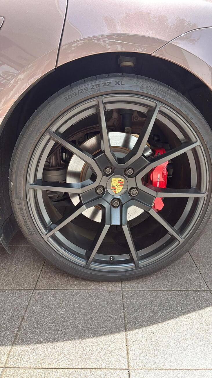

Currently using this tyre 305/25 for the rear tyres for this rim.
tyres have some issues and need to change.
however they suggested to use 295/30, is that ok?

Is 295/30 your front size?

I used 255/40 R21 front (29" H) 295/35 R21 rear (29.1" H) michelin 4S AS with no issues at all. You need to check the diameter of the rear to make sure they are relatively close to the front
thank you! yup the diameter of both front and rear is 22

Cowtownhusker means the diameters including the tyres.

While they look like them, surely those aren’t Taycan OEM rims, as they appear to be 22” not the standard 21”?

My apologies. I thought they were 21” rs spyders. Still, overall wheel diameter can’t be much over 29” for clearance. I would look at some threads with other 22” wheels.
