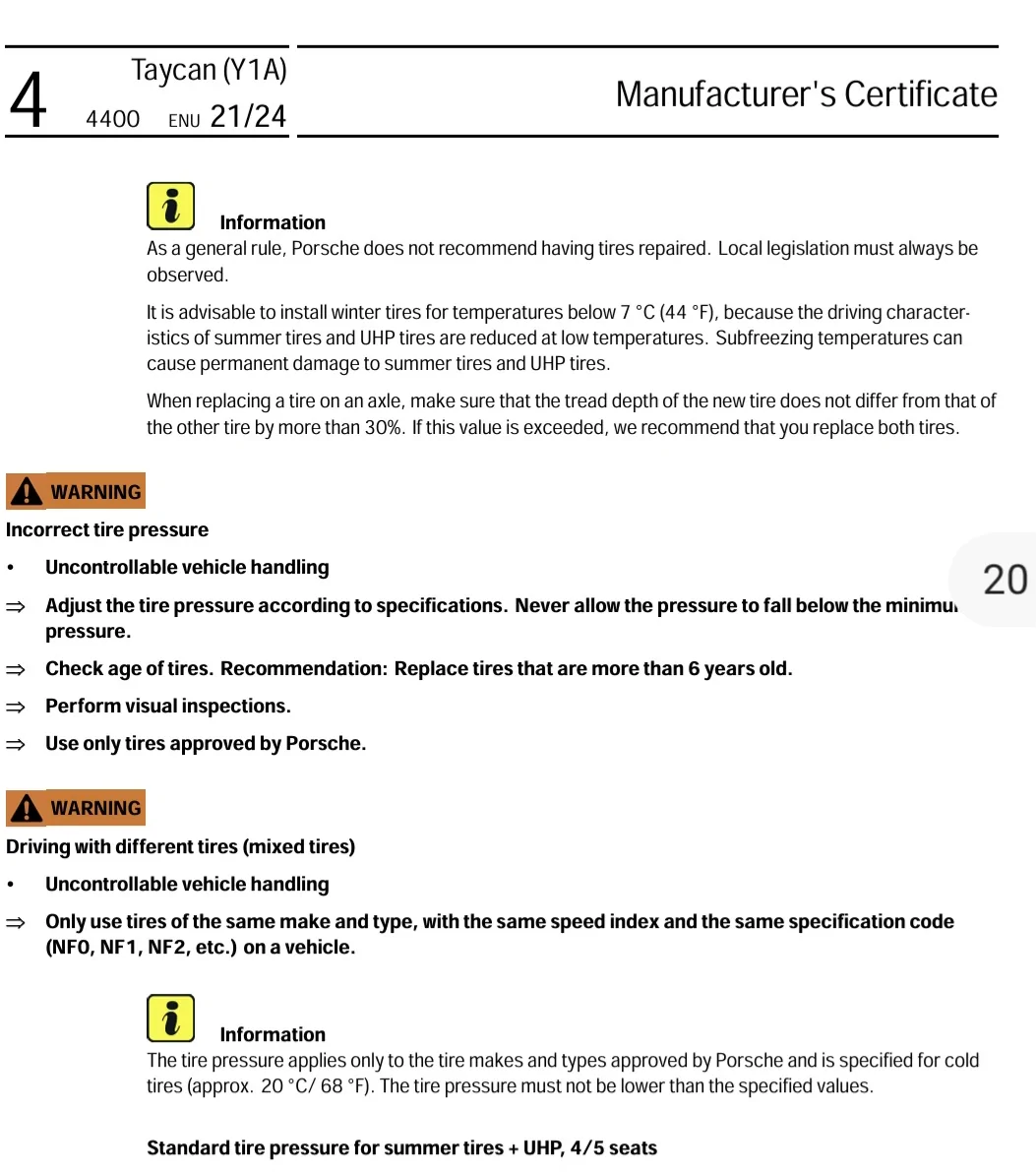

No need to change all the tyres, unless you really want a different tyre. Just replace the damage tyres with identical replacements. Porsche recommend max tread difference across the same axel as 30% so just over 2mm. See attached
Porsche Taycan Tyre Enquiry Taycan J1.2 Screenshot_20251212_182548_Adobe Acrobat
