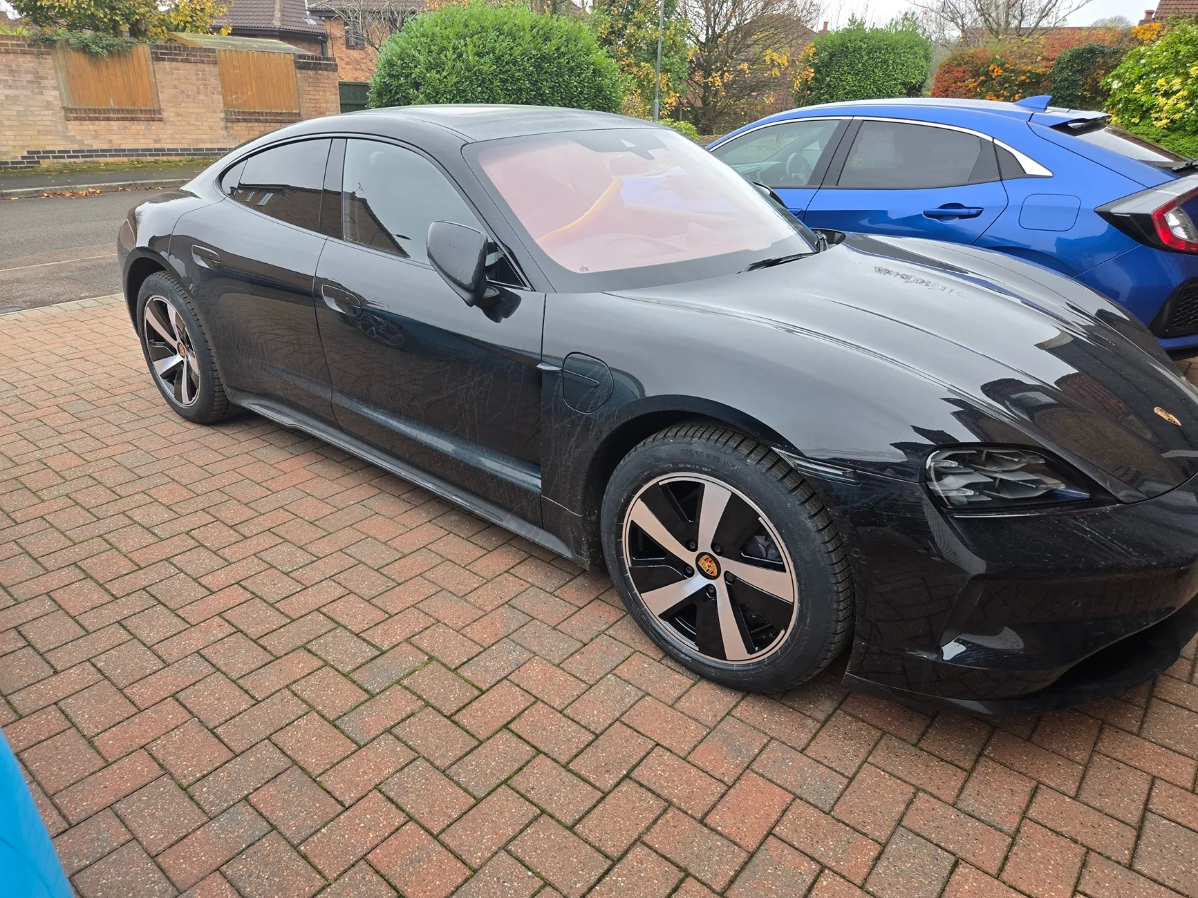

I ordered the "Lamborghini" ones from eurospares having confirmed compatibility.
Just under £280 for all 4.
Ill be fitting them in Nov i guess.

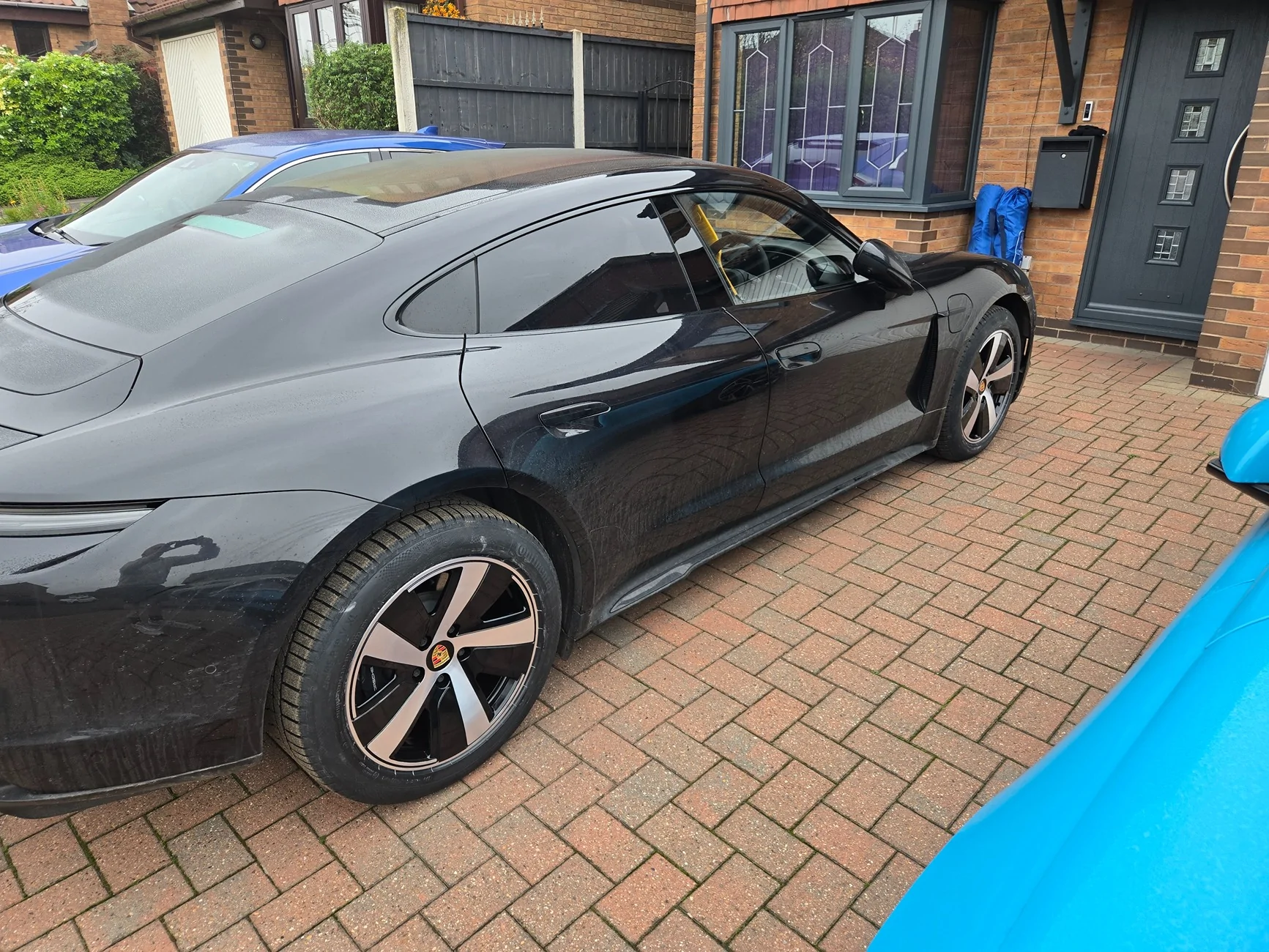

So ive had the winter wheel and tyre set fitted today, zero issues with the sensors, all working perfectly 👌
