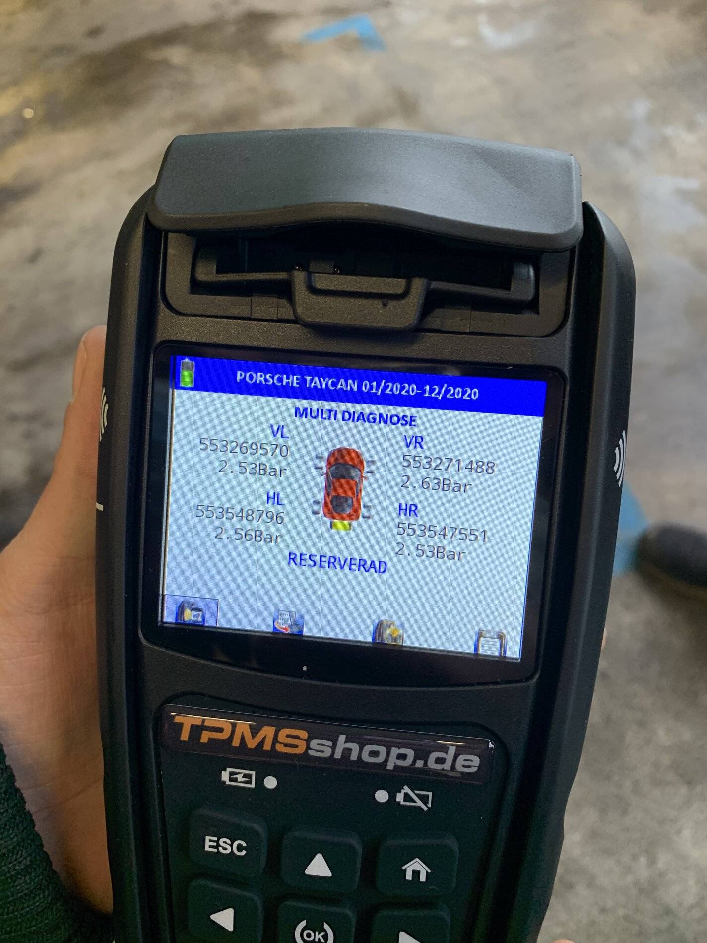

FWIW, I had a tire shop break a sensor while mounting tires on a different Porsche. They grabbed a same brand (Bosch) sensor from their inventory and replaced it, and never told me about it. Turns out there may be different models and/or frequencies within the same manufacturer - so perhaps that happened to you. TPMS should easily be able to handle if the original sensors are moved to a different corner of the car - just re-learning which sensor ID is at which wheel. After starting the re-learn procedure as others have already stated, you have to drive at least 15 minutes, or deflate each tire by at least 5 PSI to wake up the sensor.
Thanks for the info. I got a picture of the device checking the sensors. I’ll attach it. I actually drove quite a while after resetting but still after that 15 minutes it says It’s not working. Maybe because I just drove within the city, so stop and go. I’ll have a longer drive on Tuesday and try again. Let’s see what will happen.
Porsche Taycan TPMS not resetting! 55592FB5-1AAC-4023-869C-E377AC9183F9

I have now tried this several times and still no change! I even took it down to the Porsche dealer and they just took a look and said “ that is not a Porsche supplied wheel, so we can not help you!” And that was the end of conversation with them. They said they could not do anything! I also tried with a Tyre Fitter not connected to Porsche. They tried to read the sensor, which worked. But they did not have the correct system to programme the sensors in the wheel so still no results.
In my case I suspect the sensors need to have the same ID as the sensors had in the summer wheels? But I have no way of reprogramming the installed sensors unfortunately.
If there is anybody who understands and knows more about TPMS systems please let me know!

I guess the sensors are exactly the HUF/BERU sensors that normally are installed in Porsche supplied wheels. Then everything will work just fine. These sensors are more expensive then other programmable once, but seems worth it.
If you get other programmable sensors, they must be cloned or programmed to that reference you gave.
In my case I suspect they did not have the exact match to that RDE047 sensor and just choose another Porsche sensor. The programming worked but not correct for the Taycan and the car would not recognise the sensors.
Porsche wanted 1250 Euros to fit new sensors and programme them in the car.
Tyre fitter charged 200 Euros for fitting a new set of cloned sensors! Simple 40 minute job!
