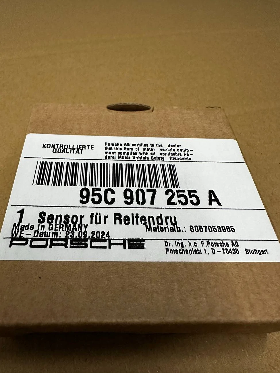

The J1 II specific sensors I was sold by the Porsche dealership are labeled "95C 907 255 A" and they indeed work.
Porsche Taycan J1.2 TPMS IMG_4972

Great, thanks for the info. I’ll see if my dealership can get me some of those too.
