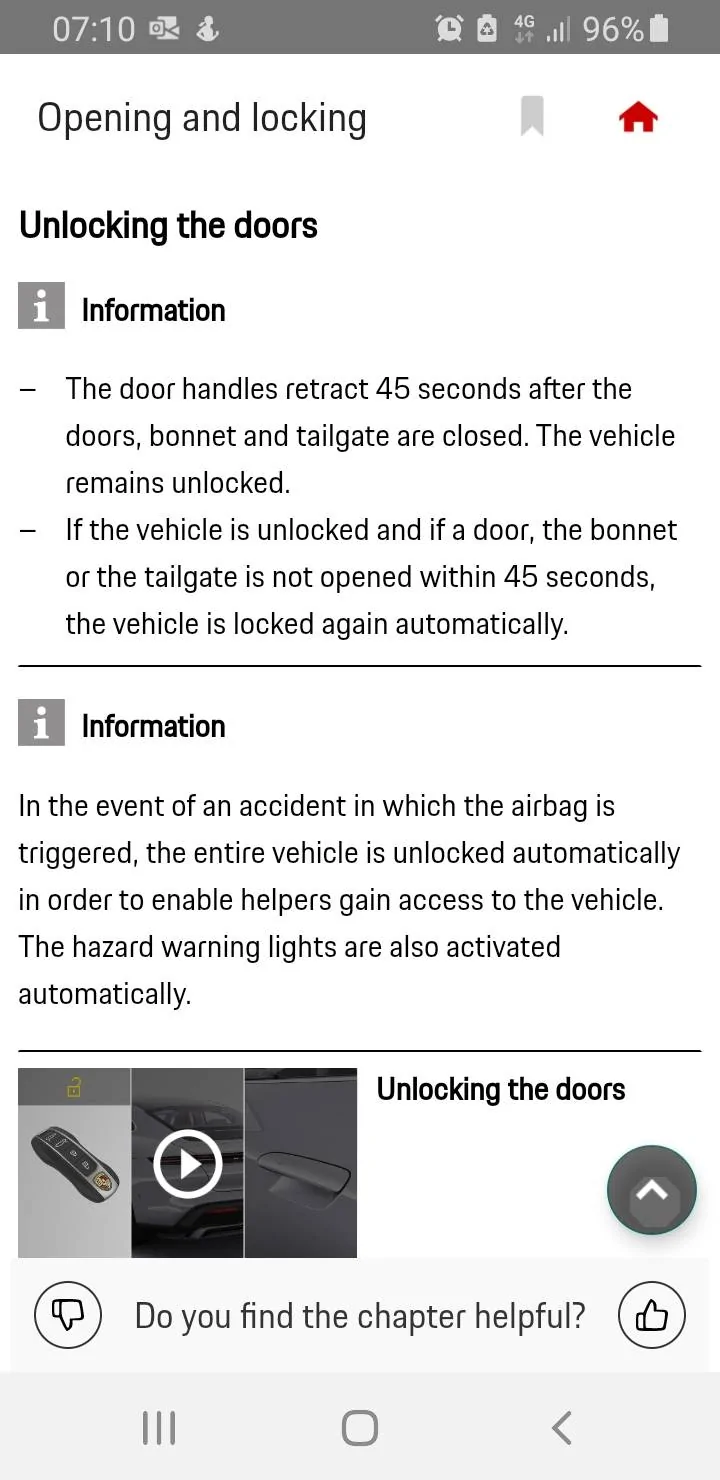

I don’t understand the handles presenting “feature”.
I have a 2021 Taycan WITHOUT comfort access. No memory package or anything, just the central locking.
When I walk far enough away for a few moments the door handles retract giving the ILLUSION of being locked. But it is definitely NOT locked, and the mirrors don’t fold, it didn’t make a locking noise, it shows unlocked on the app, and if you walk up to it WITHOUT the keyfob you can open the doors even though the handles are retracted, which is of course what a casual burglar might try.
If however, you walk back to it WITH the key Your pocket, the handles “present” just as others on this list have described. And you can open it of course because the car was never locked.
If the car is properly locked, then the handles never present. I’ve never been able to get them to pop out when locked by touching anywhere on the handle including the little slit shaped dimple.
So I can’t for the life of me work out what this feature is for. If it can hide and disclose the handles, then why can’t it just lock the damn car whilst it’s at it?!?
At best, it does little more than provide the illusion of locking, with the view of leaving it unlocked for burglars less familiar with the handle position to simply open the car and ransack the inside.

The dimple is the sensor for comfort locking and unlocking rather than use the key. Without comfort then clearly they are in active.
The car will auto lock and unlock if no door, trunk, or frunk has been opened within 45 secs. The door mirrors won't retract in this scenario I believe.

As I said, I don’t think it’s locking. Just retracting the handles.

It is locking if you don't open anything. Try it and see.
nope. It’s NOT locking. It’s only retracting the handles. If I pull the handles (like a burglar) the car will open without the key.

thats even weirder. I just tested this.
1) Car is locked.
2) unlock car by pressing key fob and remain standing nearby
3) after 45s the car does indeed lock but door handles and mirrors remain extended.
4) after a further minute, no further actions from the car, but trying the protruded handle confirms the car is indeed locked.
5) lock with keyfob - everything retracts
So I don’t Fully understand that behaviour either. But at least it’s on its way to being functional useful, if incomplete.
But itstill doesn’t go anywhere close to explaining the proximity effect. Others on this list reckon it’s locking and unlocking with keyfob proximity. Mine is only doing the door handle retraction.
So between these two strange behaviours there’s a useful function but it’s not joined up.
Evnoob
Daniel
May 15, 2021
Uk
Combo test - seems like an obvious observation.
same test as before, but after unlocking take the key away out of range. This time, it both locks and retracts the handles but NOT the wing mirrors.
returning with the keyfob, and proximity has no effect this time.
mans of course, this series of events is ONLY for the case wherea door is never opened. As stated before, if I’ve just got out of the car, and walked away without locking, it will NOT lock itself but it will retract the handles as if it has.
Who TF writes software like this? How did this get through a design cycle, let alone a test cycle?
