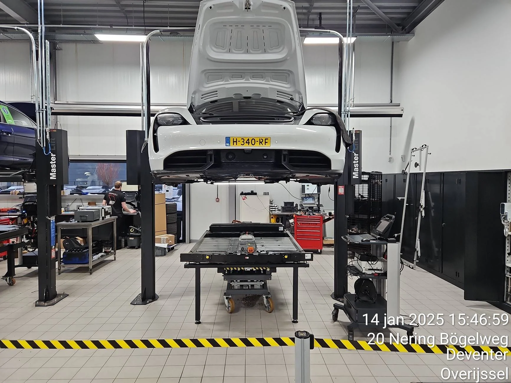

Analogy: The 22 kW OBC has proven issues (but no recall unfortunately).
Porsche Taycan Taycan battery may repeat Bolt battery disaster TimePhoto_20250114_154659

ARA4 literally replaces damaged battery module. Aka, 1 or more modules with issues. Just because you can't wrap your head around having a battery damaged, doesn't mean it wasn't damaged.
I have also had it, and they marked my ARA4 recall as done; with the actual Action campaign (WRE3) to remain to be done, where they replace the damaged module. And that has also been done now, 2 months after initially marking ARA4 as done.
More than that, my dealer VERY confidently stated that 100% of cars with ARA4 had modules replaced. ARA5 is unconfirmed production issue, and ARA4 is confirmed production issue.
So you have had issues, and likely still have the issue if your battery hasn't had modules replaced, as they are likely waiting for parts only to call you to finish the action item on the recall.
Porsche Taycan Taycan battery may repeat Bolt battery disaster 1738411928499-5s
You are trying to discuss semantics, when there are actual facts stated by Porsche for the recalls :)
