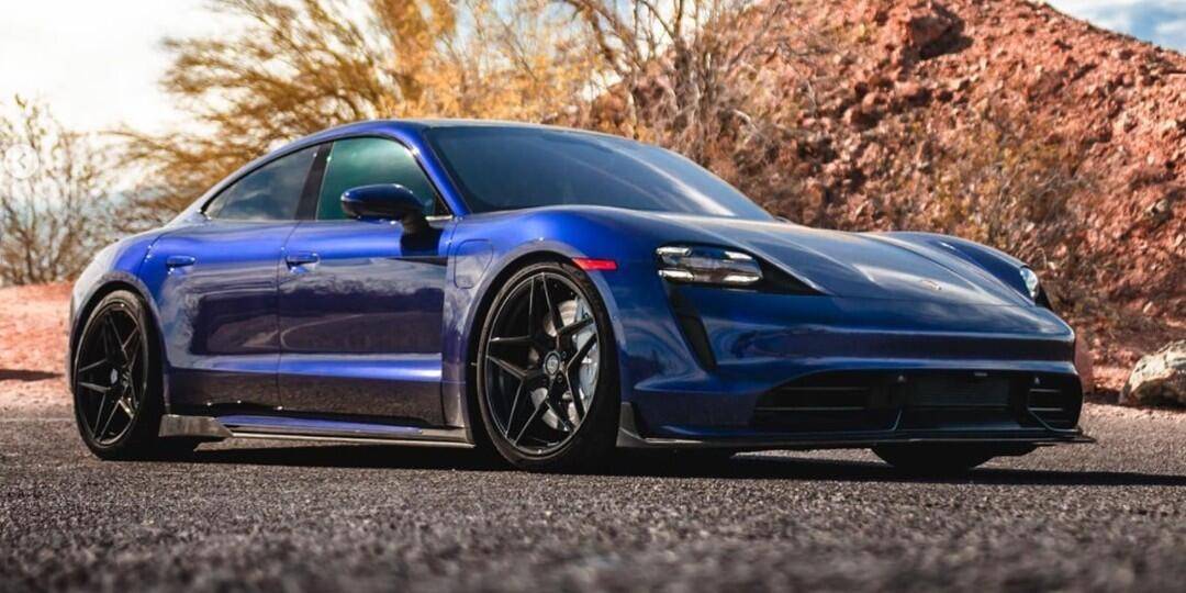

Has anyone installed Vossen custom Wheels on his/her Taycan ?
Vossen recommended that i order 50 and 58 Offsets instead of 60 and 66 of my mission e Wheels for my Taycan Turbo. I'm trying to order their S21-01 21" model.
Has anyone tried this model with the recommended offset.? Were there any road feel or handling issues.? I started to think about backing off and keeping my original wheels. ?
Any input would be highly appreciated.

Those offsets are only a minor difference from Standard (10mm further out on front and 8mm on rear) but the stance will look so much better with the wheels being slightly further out. There are taycan owners who have gone 15-18mm further out on front and 13-15mm on rear.
So don't worry it will be absolutely fine. ?
