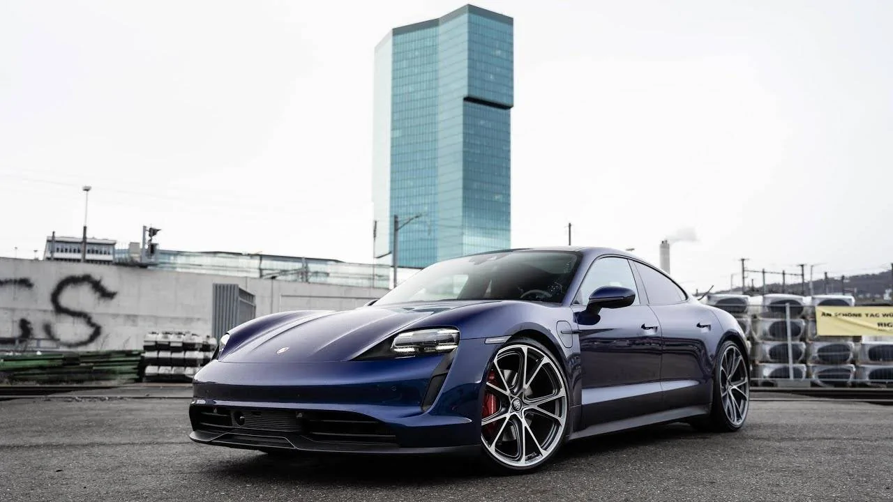

I am looking for advice in regards to offset on custom wheels. I am in contract to produce a set of Magnesium wheels from Litespeed Racing. Can you share the best offset to ensure the wheels are flush with the fender?
I reside near NYC and I'm concerned with potholes with 21 inch wheels.
I plan on installing the Vivid Lowering links as well.
I am thinking of using these offsets from the Techart IV wheels except with 21 inch diameter.
21X10 et56 Front
21X11.5 et59 Rear

Hi! You can take the Mission E wheels specs and find your preferred wheel brand.
Center Bore 71,6mm
5x130
For 20”: 245/45R20 9J x 20 ET54 FRONT
285/40R20 11J x 20 ET60 REAR
For 21”: 265/35R21 9,5J x 21 ET60 FRONT
305/30R21 11,5J x 21 ET66 REAR
Mission E 9J1 073 660 K original
9J1.601.025.AA front
9J1.601.025.AB rear
