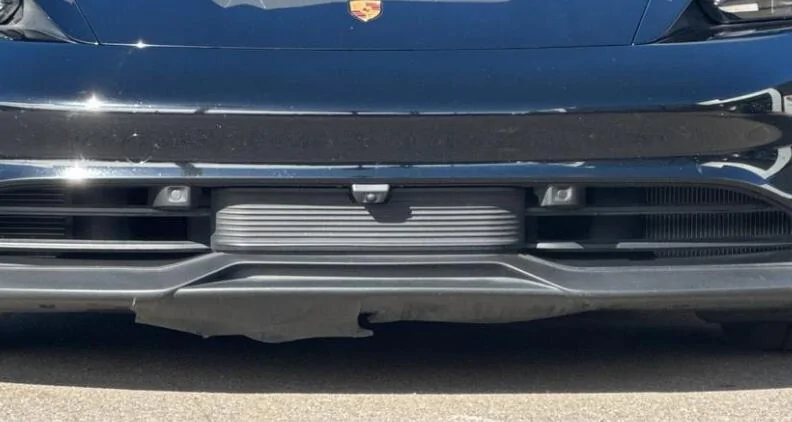

Dealer took this into account when car was traded/lease returned.
Make them put it on a lift so you and the tech can inspect, THEN if it is only the chin piece, have them replace it. Otherwise move on. Buyer’s market!
Agreed, the part is so cheap they should have no problem doing this to close the deal.

I replaced the lower lip and I had to remove your broken part. It took me 6 hours to remove and replace the bumper with caution and replacing the scratch part. Very time consuming but super result in the end. I think the part you showed cost $200. The Lower lip cost me $400.
That's really true? You have to remove the bumper cover to replace the front spoiler? That's wheel well liners, headlights, frunk liner, etc. I'm disappointed. If done at the dealer, the $400 is going to be the smallest line item. Technically if you mess with the bumper cover you have to recalibrate all the sensors. There's $1000 right there.
