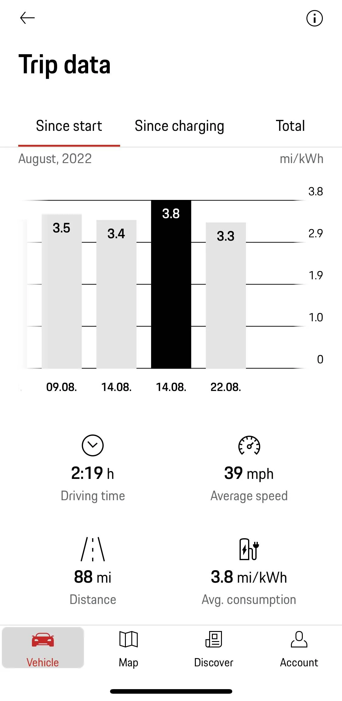

I suppose I'm not really surprised that people seem to be so hung up on range, but now I've had my car for 18 months / 16k miles I mostly only look at efficiency. In fact pretty much the same as I did when I owned ICE cars, but now it's miles/kWh
I do 98% of my driving in 'Individual' setting where I have the car on its lowest height setting, Normal driving mode, and Adaptive Regen. I also have the A/C set to Eco at 20 Deg C which I've found even in the recent 40 Deg C UK heat wave to work perfectly well enough.
Last summer on my cross-country runs (no motorway) of approx. 140 miles from mid Wales to Bath, the very best I could get was 3.5 m/kWh. However on my last 70 mile trip from Bath to the Porsche Club GB Taycan Register meet at Caffeine and Machine just outside Stratford, in what could be best described as a 'spirited' cross-country Sunday drive due to there being very light traffic in the early morning, I still managed to achieve 3.4 m/kWh at an average speed of 43 mph.
But then on my 88 mile drive home, again across country as there were problems on the motorway route, I managed the previously unattainable 3.8 m/kWh at an average speed of 39 mph. And just to be clear, whilst there was a fair bit of traffic I did use every opportunity possible to overtake so I wasn't exactly trying very hard to maximise efficiency.
The reason for this 8.5%+ increase in efficiency? Surely it must have something to do with the fact that my car recently had the uPdate ?

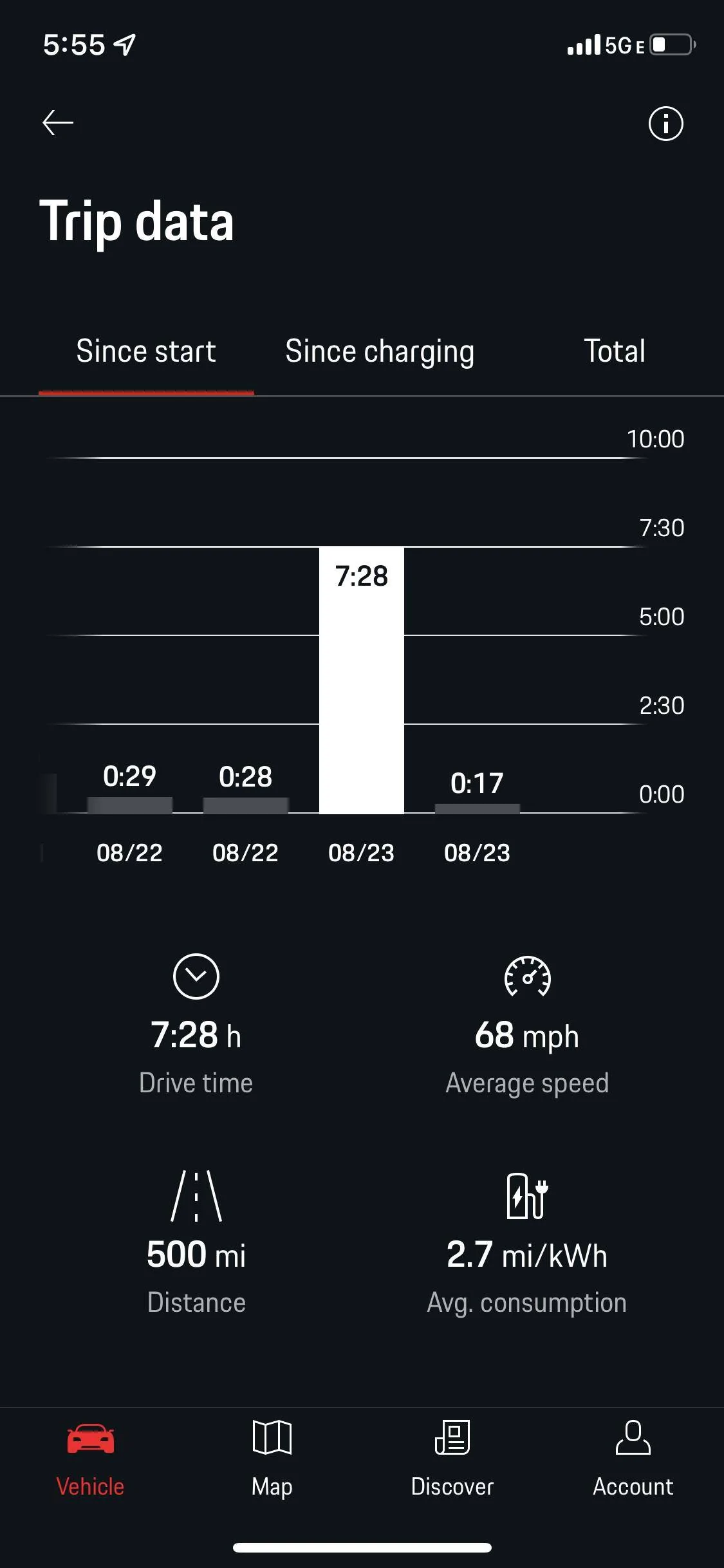

For my 2022 4S (Feb build) with Mission E wheels, basically no difference at highway speeds with the update. I typically run 2.7-3.0 depending upon the speed which is usually sustained and well north of 70MPH. With that being said, I have noticed substantially improved efficiency in traffic and regular/B roads.
Charging speed is the same fast as it always has been — no change there.
Navigation is dramatically improved. Much faster. PIRM also feels like a few kinks have been worked out.
Overall, I really like the update and appreciate Porsche doing right by their early adopters. That’s a great thing and bodes well for strong resale values. Understand that if you’re traveling at speed on the highway, don’t expect a revolutionary change in range performance.
