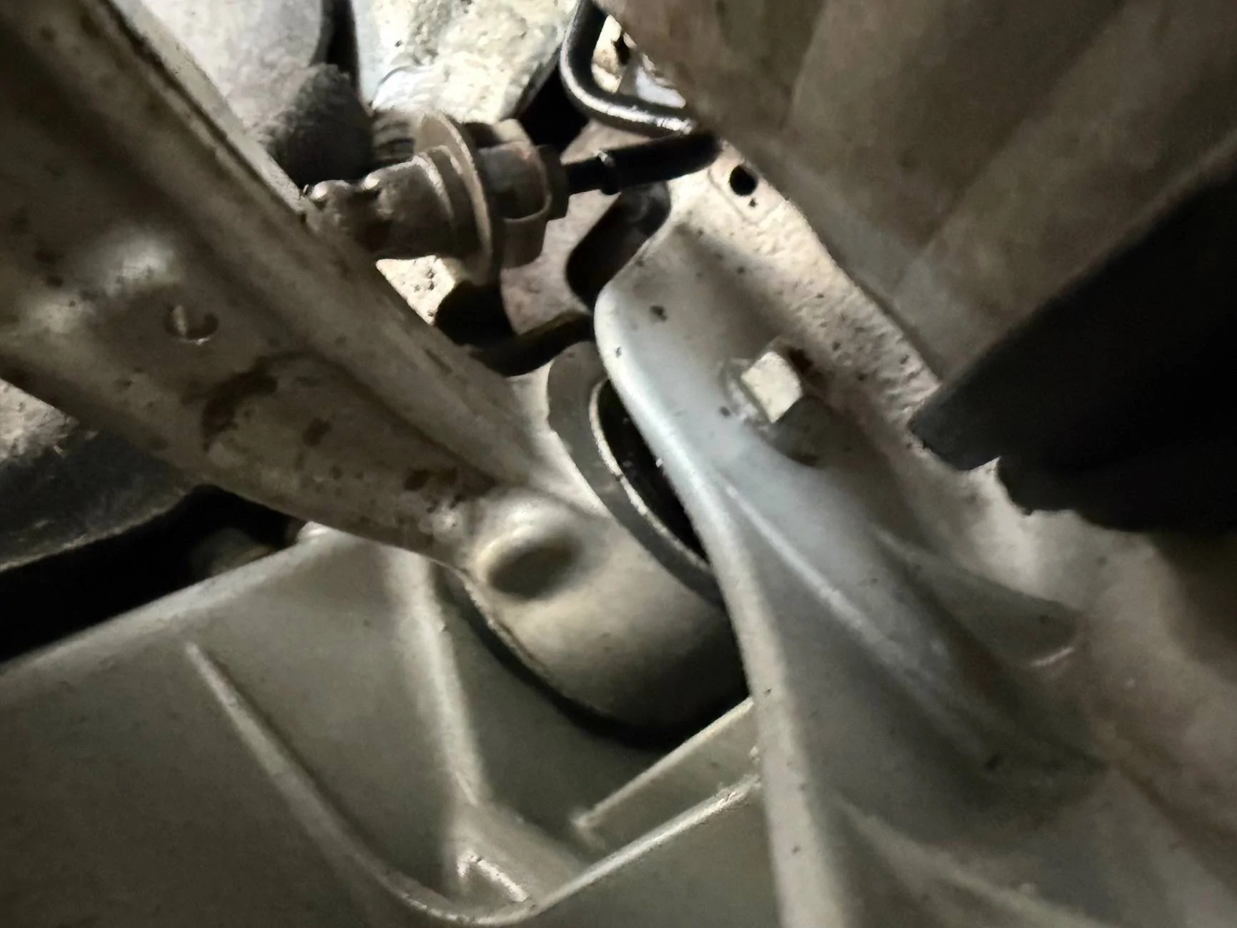

Does it squeak squeak/creak when reversing off driveways, as the wishbone bushes cause this?

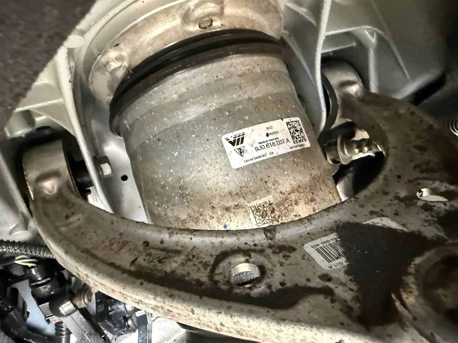

It is most likely the bushes, mine was really bad and is booked in in a few weeks for this and a few other problems, I fixed mine as it was driving me mad, I removed front wheels and jet washed the bushes as they was very incrused with dust and dirt, I then blew them out with a airline and sprayed them with a rubber proof silicone spray, after 5 minutes of driving the squeak had gone, Porsche know there is a problem with them as there is 3 different versions however they are classed as a wear and tear part so difficult to get done under warranty.
