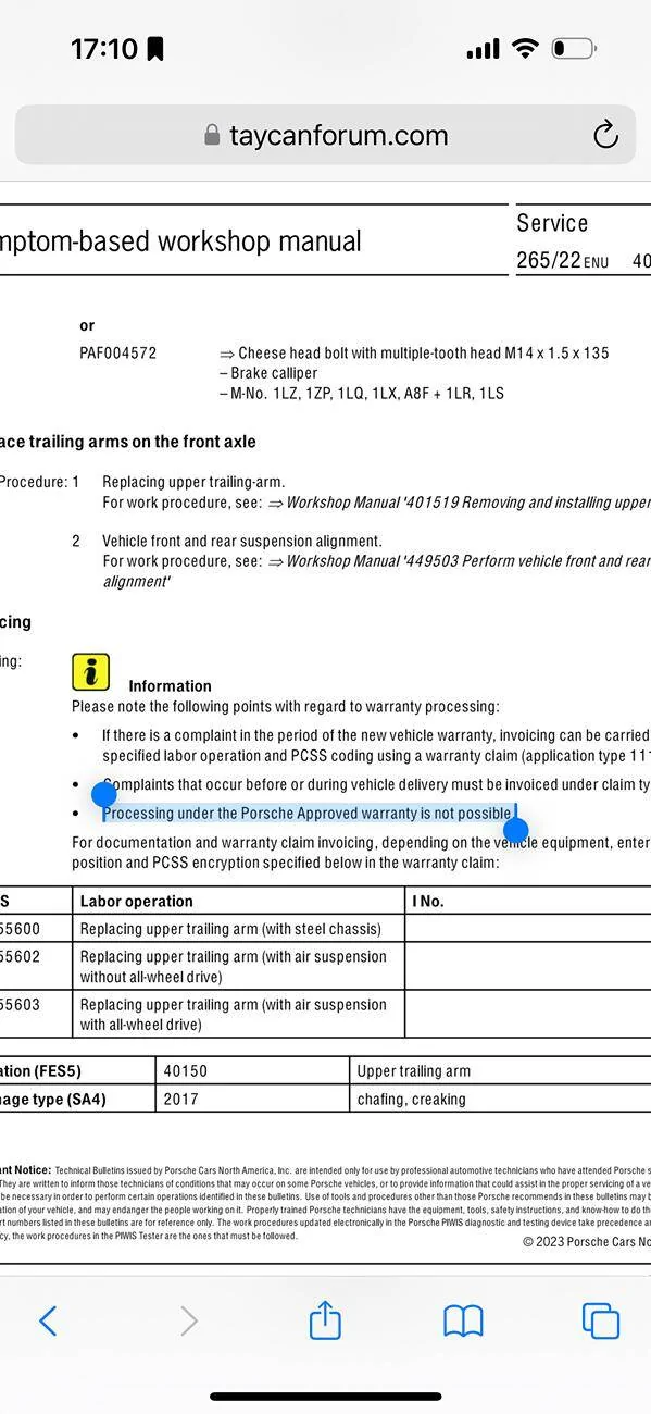

I have the same problem. There is an abnormal sound when passing through a speed bump.
Reactions: Mtk

@Mtk - forward the bulletin & remedy attached in the previous post to your warranty/customer service contact, stating this is a recognised defect.
Note the remedy does say that claims under the extended warranty are not possible, so you‘ll have to negotiate that.

It’s a CPO car. He doesn’t have factory warranty, but extended warranty. The document clearly states that this claim cannot be processed as Porsche approved warranty.

Regarding the replacement under CPO warranty, dealership explained very clear that Porsche AG won‘t approve this job (As stated in the above mentioned bulletin). @Chiu thanks for attaching this doc.
tl;dr If the creaking sound is present, CPO warranty won’t cover it unless there is free movement in the control arm. Lubrication will fix the issue for unknown time.
