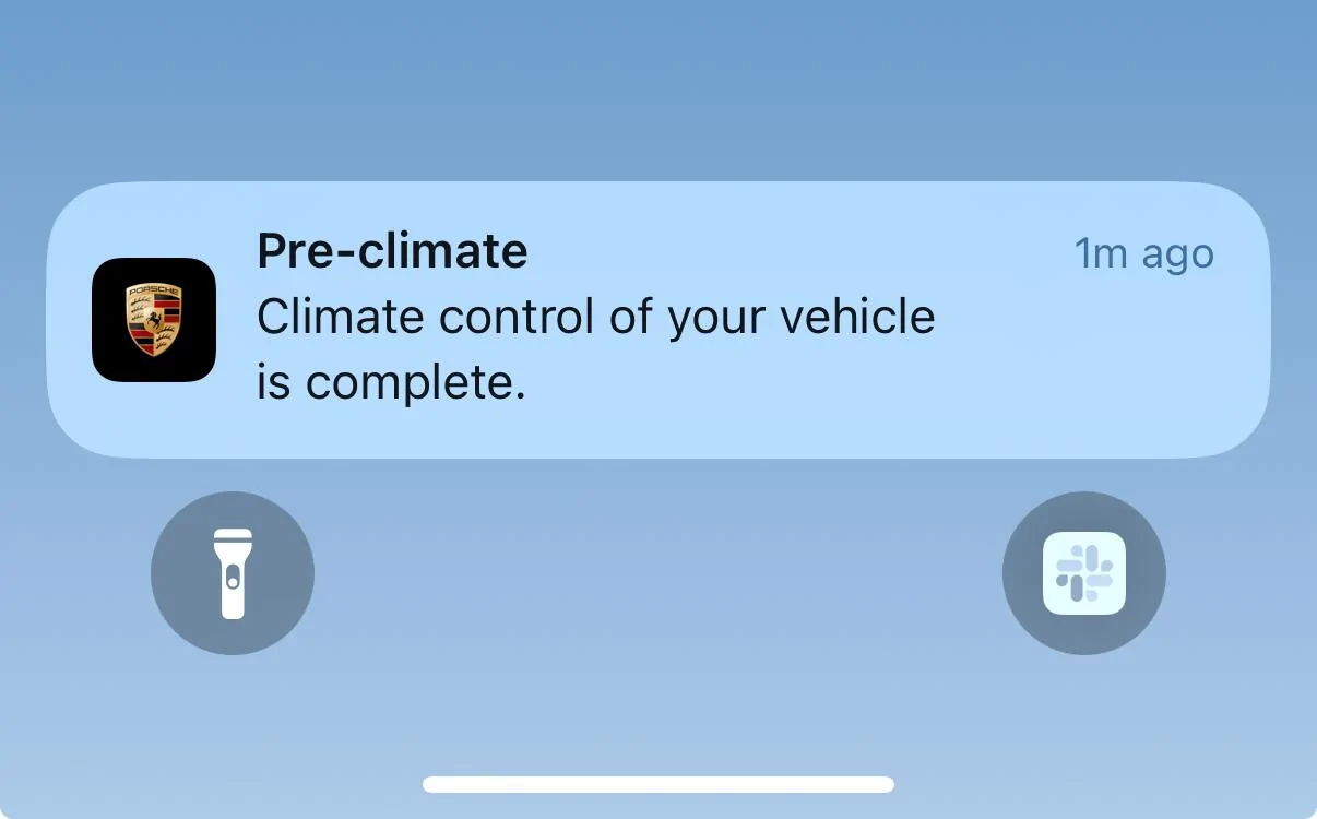

Literally, unclocked the car, opened my frunk to grab my gym bag, locked the car. 3 minutes later on my phone.
happens like 4 times a day. What am I doing wrong?

I believe you can turn this option off which automatically pre heat/cool your car once you unlock it. Since I like this feature I left it on. When I just need to unlock to grab something quickly I just go into the app to stop the pre heat/cool process.

Using the Porsche Communication Management (PCM)
Access the PCM in your vehicle.
Navigate to Home > Climate > Precool/heat.
Tap on the Precool/heat option to turn it off.
It's such a strange feature to me. Would you unlock your car minutes before getting in? From afar?
The time between unlock and ON/Drive is so short it hardly matters, and can only cause problems when walking past the car.
