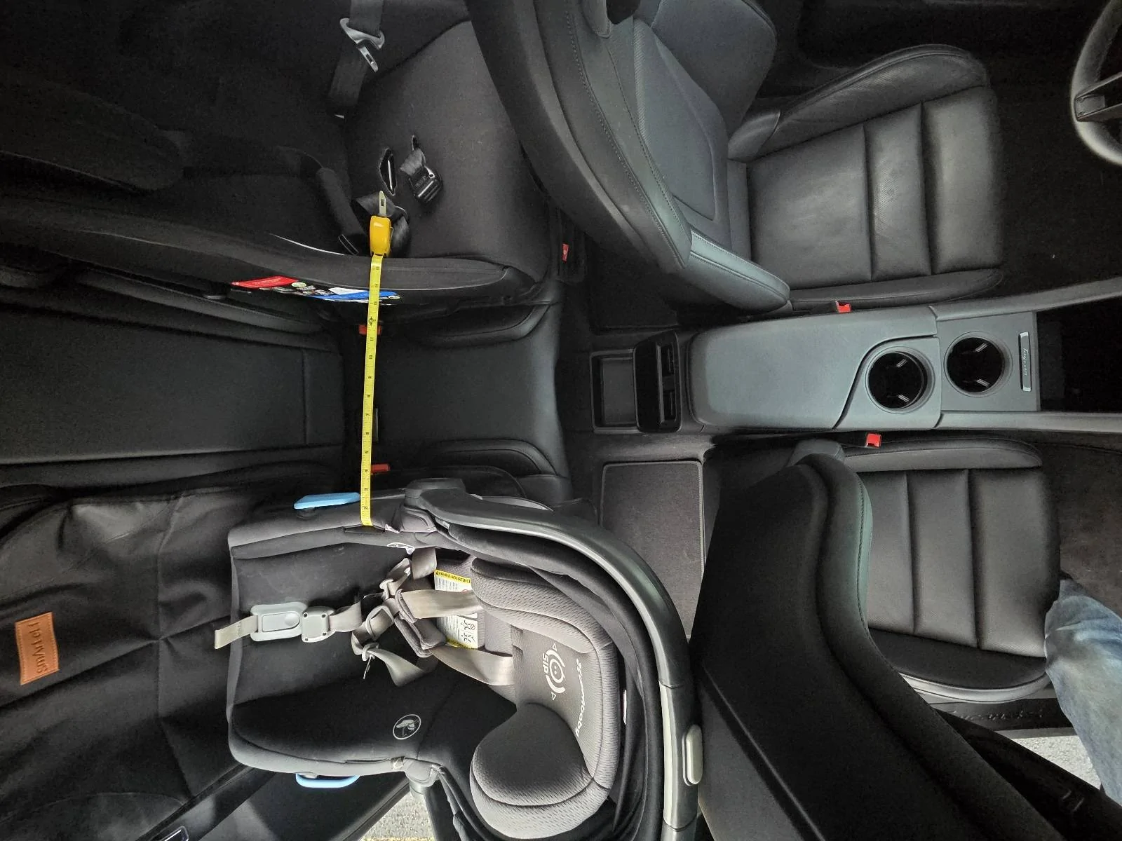

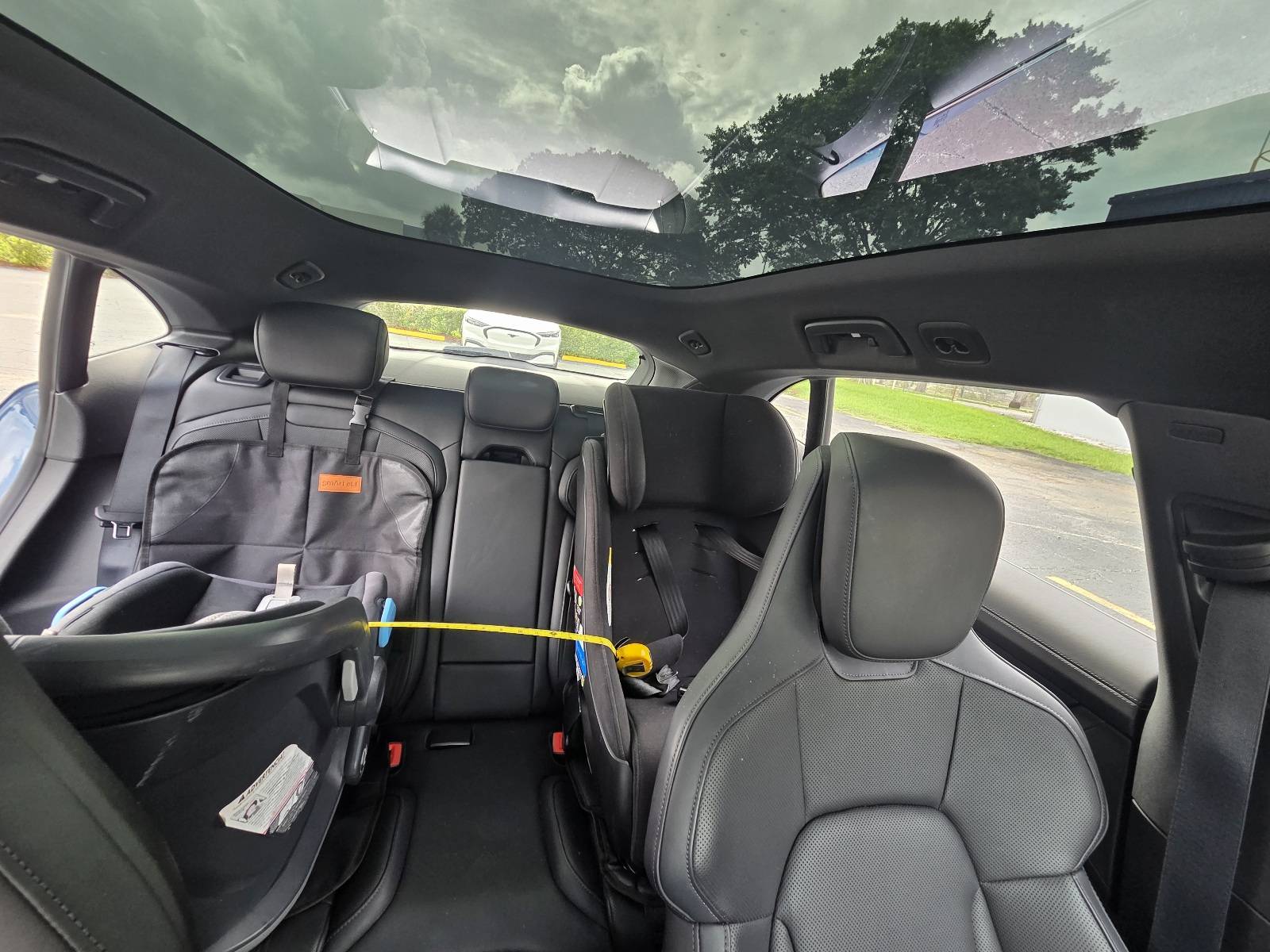

With the current setup I have 11" - 12" between my child seats, a rear facing Upababy Mesa and a Clek Fllo which is known for fitting 3 across.
I will be replacing the rear facing seat when my new seat arrives in a few days. I can test if I can fit 3 across.
But I think your best chance might be two slim seats with a backless booster in the middle. Or 2 backless booster if your 5 year-old can fit safely in it.

Thanks for sharing this. I think three would be quite tight. However, our current seats are a bit bulky, so I think I'll check for some slim seats and see how that might work out. Would love to see your three-seat setup.
