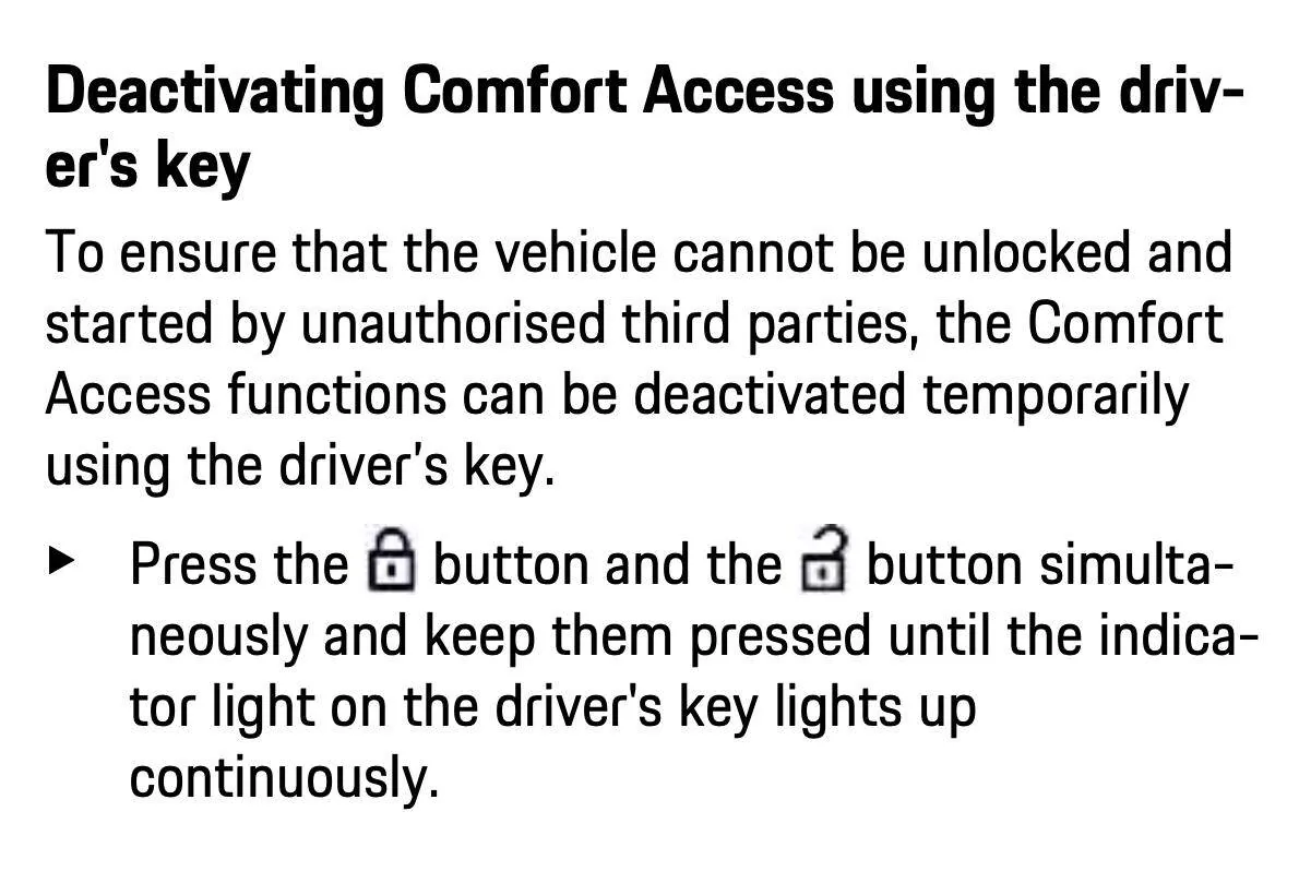

Think about deactivating the comfort Access to avoid the risk of unexpected openings of front trunk or charging port doors during jetwash.
I started leaving keys inside before I wash as it would pop open often. Will try your step! Looks smarter.
