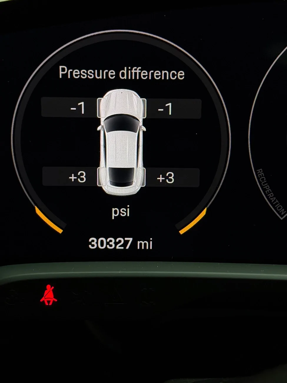

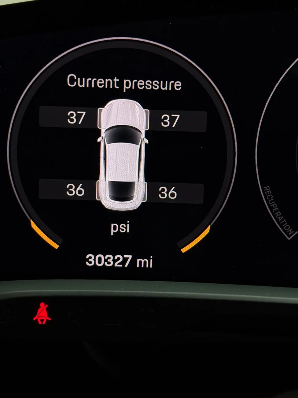

Got a warning that one tire was low. So, I decided (for the first time) to add some air to it and check the computer/monitor and I just realized that Porsche has a thing called “pressure difference”. I read the manual. I think I get it…just not really sure how and what the purpose it is.
I tried searching for this on the forum. Any ideas/insights would be appreciated.

In your first picture the tires in the front are 1psi short of target pressure, the rears are 3 psi over target pressure. Target pressure depends on your tire and load settings in the PCM. The difference screen is compensated for temperature to make adjustments easier than using absolute tire pressure. As temperature goes up, the absolute tire pressure goes up, but the difference will stay about the same (it varies a little due to some inaccuracies of the compensation).
PS> What is your tire type and load set to in the PCM? It seems like the PCM is expecting lower pressures on the back, which is odd (I've never seen it before). Or did you take the second picture at different time than the first?

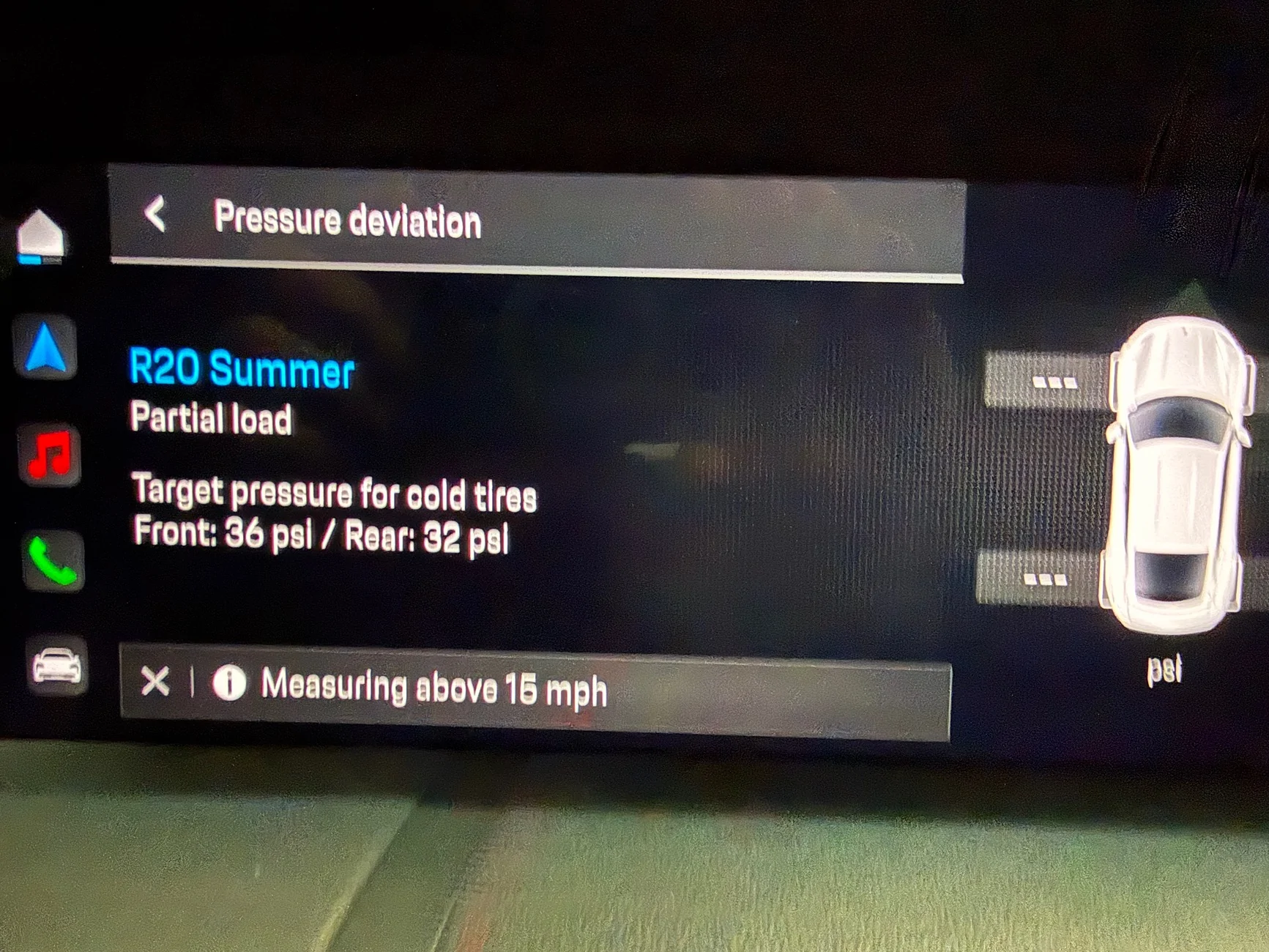

@whitex , thanks for insights. Making more sense now. The pics above are from same time. Just checked and It looks like the car is set for partial load. So, the front PSI are set higher than rear. I don’t see an option to change the pressure. Maybe if I set it to full load. Tire brand is Falken Azenis 20”.

@udubfl , yes, changing from partial load to full load, as well as type and size of tire will change your target pressures.
As for differentials, I usually pump up the tires to recommended/target pressure, take the car for a short ride, then adjust the differential pressures so they show 0 all around when parked on a flat, level surface. I find that they stay at 0 +/-1 until next wheel change (up to 6 months - I change wheels 3 times a year: winter, all-season, summer).

I asked it a porsche dealer here.
But there is also a standard or comfort choice. Comfort then is for lower speed , I think 160 kmph/99 mph.
Porsche for other models give between brackets () the recomended pressure for the setting calculated from 20 degrC/ 68 degrF to temperature of gascompound in tyre, also sended by the sensors.
This makes possible to adjust pressure warm at a tankstation.
Then yust fill to pressure given on screen between brackets
