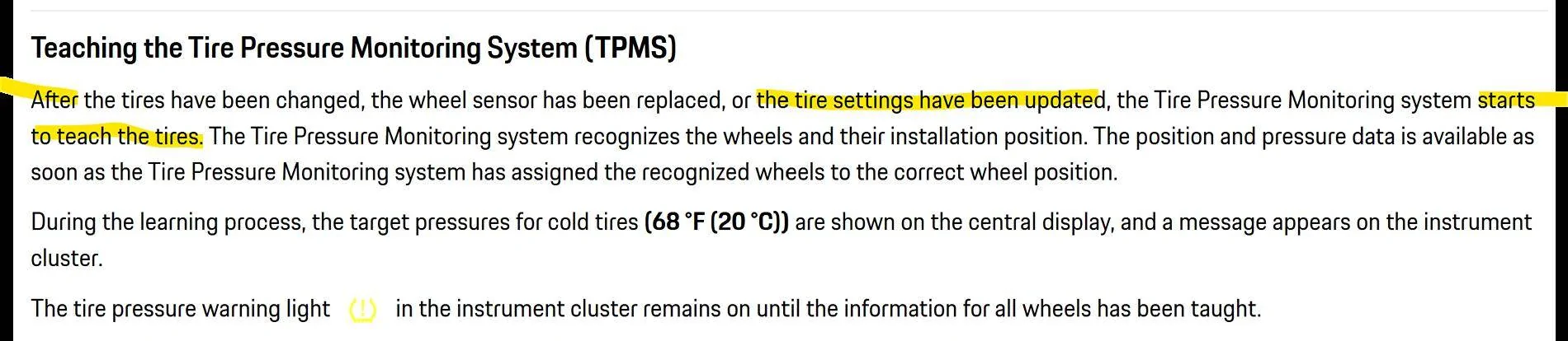

This is what the manual says to kick off the learning, which is what @gramorris said.
If this does not resolve the issue then this would mean to me that there is some issue with the TPMS system and/or TPMS sensors and the dealer most likely can read the fault codes to resolve.

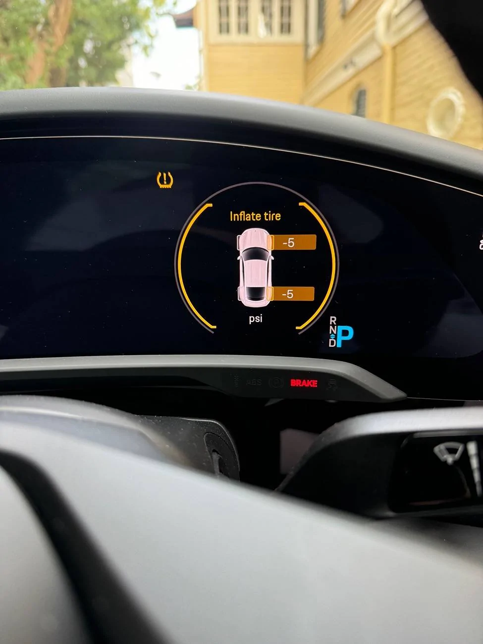

Well, I thought (hoped) I was in the clear, but tonight turning the car off, I got this message on the dash before the PCM went to sleep. So, back to the drawing board. Any other suggestions?
This is very odd. I wonder if you tried measuring the tires using a manual tire pressure gauge to compare to what the car is measuring. Also, have you had any work done on your wheels or tires that would damage TPMS sensors.

Great suggestion, I’ll try manually measuring. No work done (at least not on my watch) to the tires. The weird thing is that the PCM shows a -5 pressure differential, but when I pull up the pressures on all four tires through the PCM or the left circle on the digital dashboard, none of the tires show a pressure deficit. Yet the error message persists. Then I do the full-load select/de-select move and the error messages clear. Super strange…makes me think there is a software glitch, and this is not a hardware (TPMS sensor) issue. It’s a minor annoyance at the end of the day, but still something I should not need to deal with.
