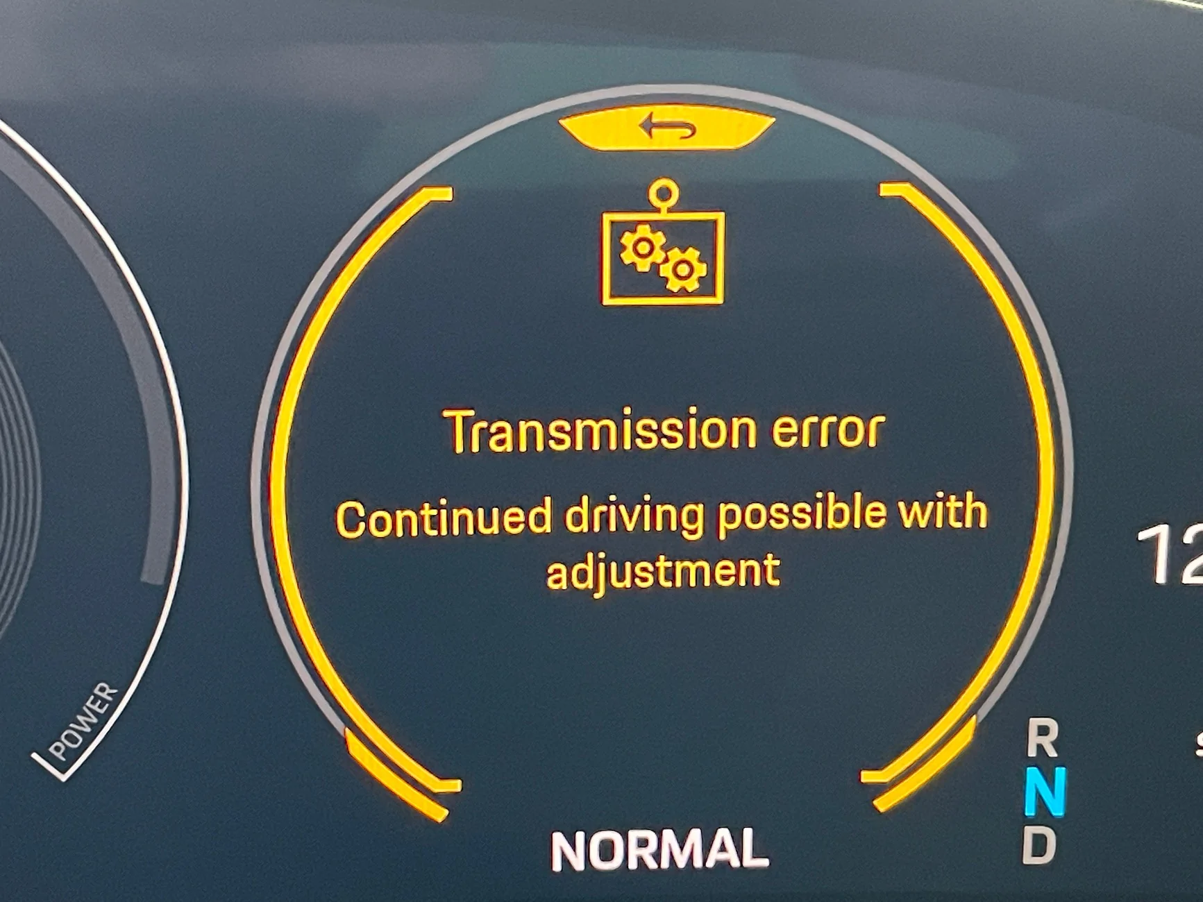

Has anyone gotten this transmission error? If yes, what is the fix? My Taycan throws this error at about 35 mph and it seems like the car is only using first gear and can’t get into second gear. The car is currently at the dealer so I will be able to report back on the cause and fix of the problem. But just wondered if anyone else had seen this error.

Thanks for all the info. But i am asking if anyone in the forum has experienced this problem and if they were able to fix it. I tried the repeated accelerations but no luck.

Just to follow up on my original post, here is how things turned out. The car was taken by flatbed to the dealer, but by the time they looked at the car the next day, the error had cleared. Presumably the clutch released on its own. They found a bunch of inactive transmission faults that they cleared. They were not able to reproduce the problem upon driving the car.
if this happens again, I will try to clear it with a launch. It might also be a good idea to wait a day to see if it clears on its own.
