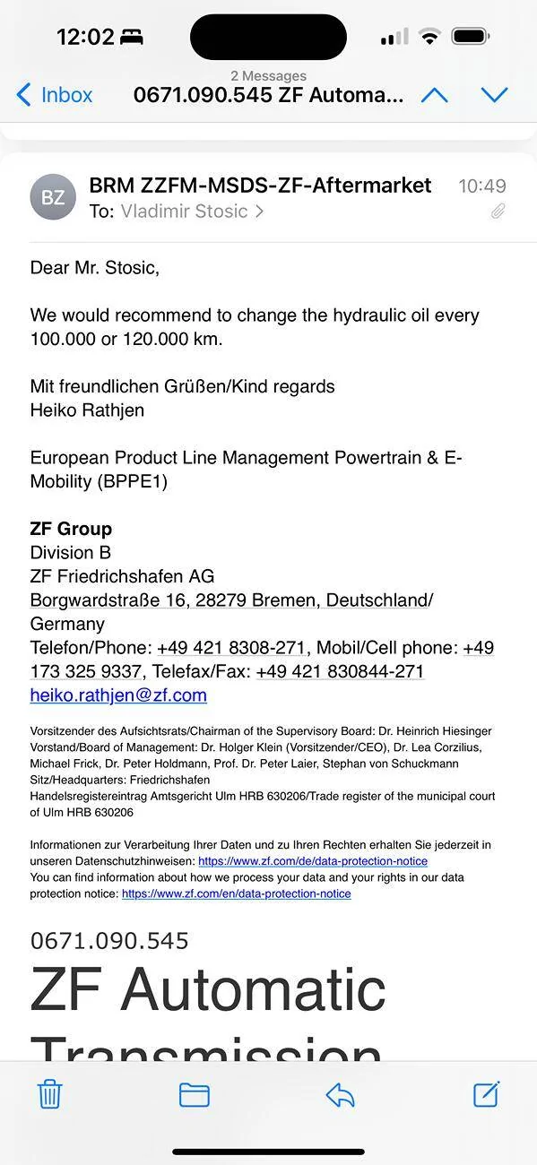

Also noticed the thread is over a year old.
Has anyone hit 100k km yet??
