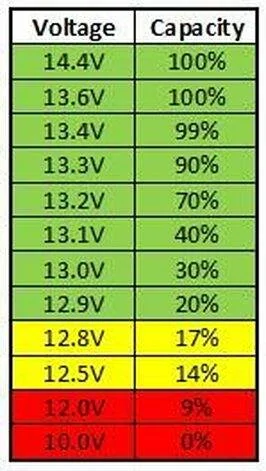

Taycan has a Lithium battery. 13.3 volts is normal for them.

From batteryworld.com.au :
"A 12v lithium LiFePO4 battery fully charged to 100% will hold voltage around 13.3-13.4v. Its lead acid equivalent will be approximately 12.6-12.7v."
All our Porsche vehicles with LiFePO4 batteries are always >13 volts and charge near 13.8v.

I was just looking at the 12v battery in my Taycan which says it’s nominal voltage is 13.2V but by the chart you attached shows the battery is at only 70% charge rather than 100% at 13.2V.
My Taycan hasn’t shown greater than 13.5V since I’ve owned it the last 9 months. I haven’t seen it go below 13.3V so it’s appears not be fully charged yet still above the 13.2V nominal rating of the battery.
Does anyone ever see voltage readings 13.6V or greater which would be 100% fully charged?
