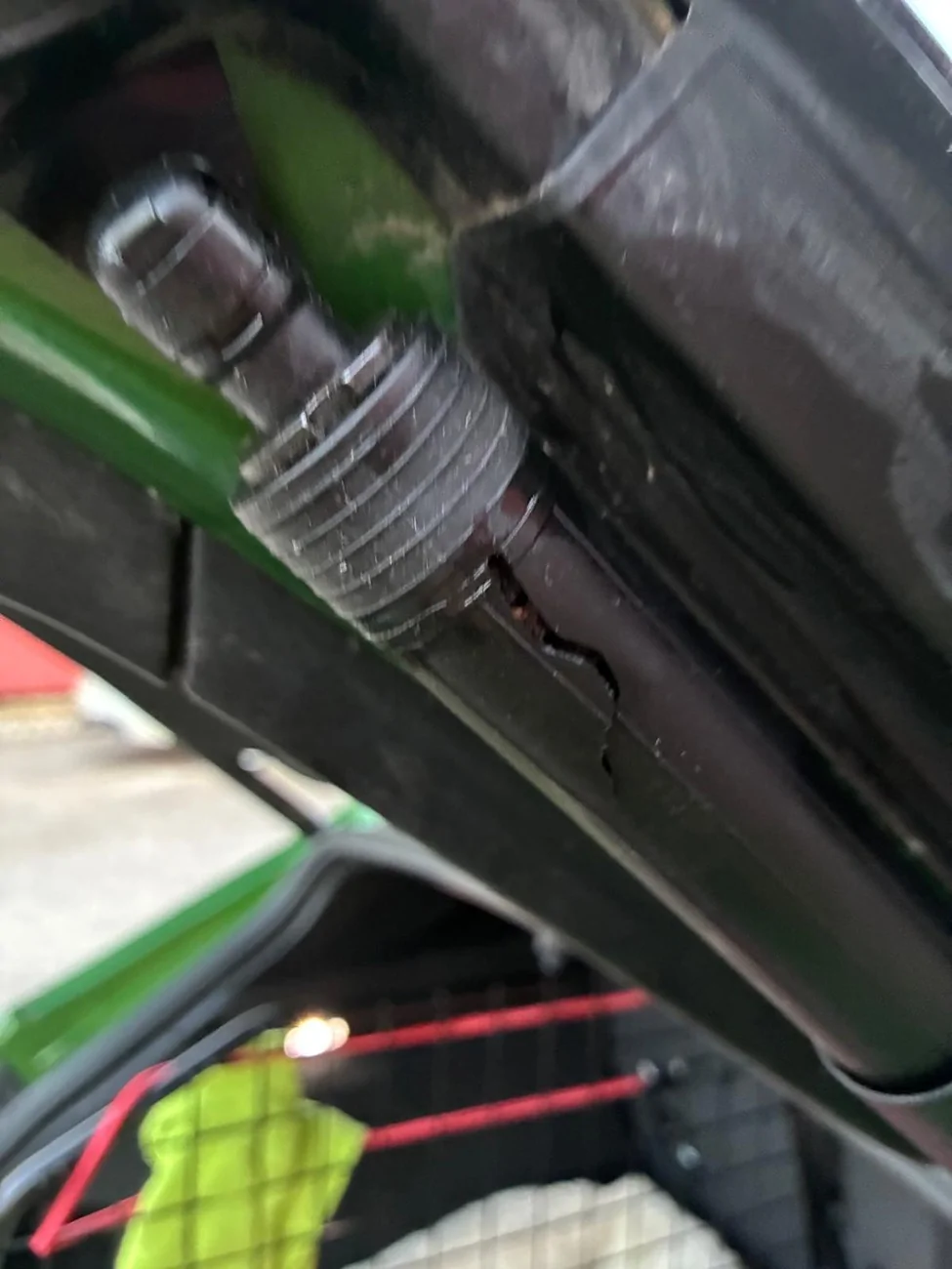

I just noticed that my CT 2022 trunk is not closing on its own.
When it is almost closed it beeps and stays about 15cm open, i can close it by pushing it a little when it is going down.
I cleaned the suspectec sensors but then i read that there are no sensors on boot, just in the strusts / shocks that are driving the trunk "door"
Also another side shock is broken, there is a big crack on the shield, so that is probably the reason why it is not working.
this is probably the right part :
https://www.ebay.co.uk/itm/27764393...et=pla-325425753764&abcId=&merchantid=7153724
anyone changed these? do i need to recalibration or something that cannot be done by yourseld? PIWIS needed?
Also cleared codes to see if that would help, nothing

Just a point of reference - i remember Matt Farrah said he had the same issue with his. Some people said it's due to walking away from the car and the key loses proximity? Not sure.
See @7:57

Yes read that one too, no change with key or without key. Also rebooted PCM just to be sure.
