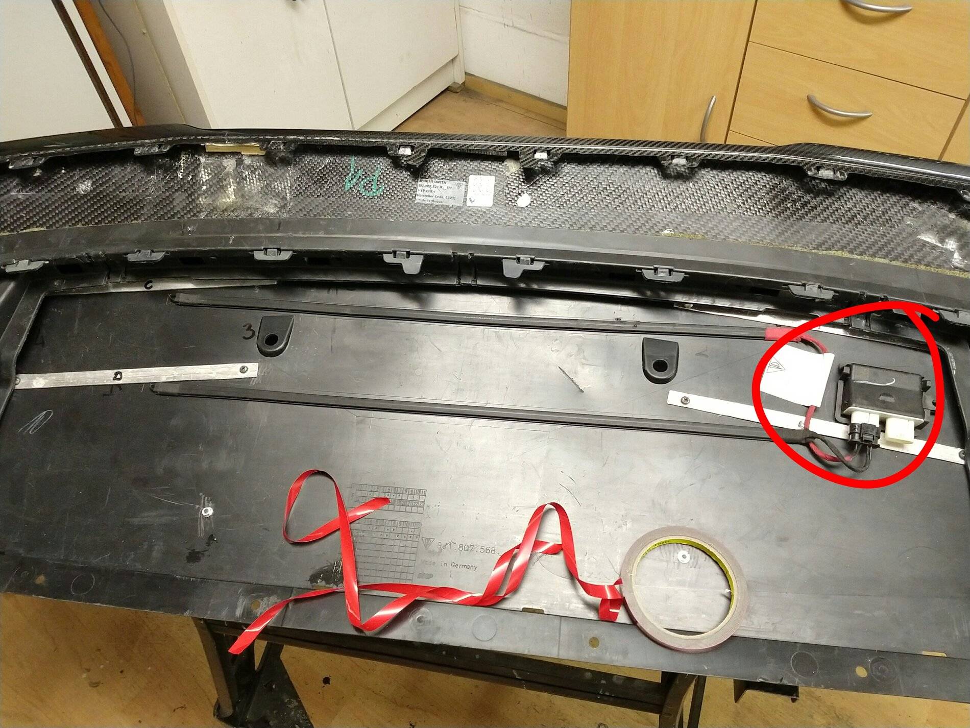

hard to differ. I'd say it's surface heat of sunlight. vulcano gray get's hot quite fast. (30min sunlight is enough)
Maybe it's the connection module of the foot sensor that is faulty when hot, or even the two strips which are attached on the bottom plate.

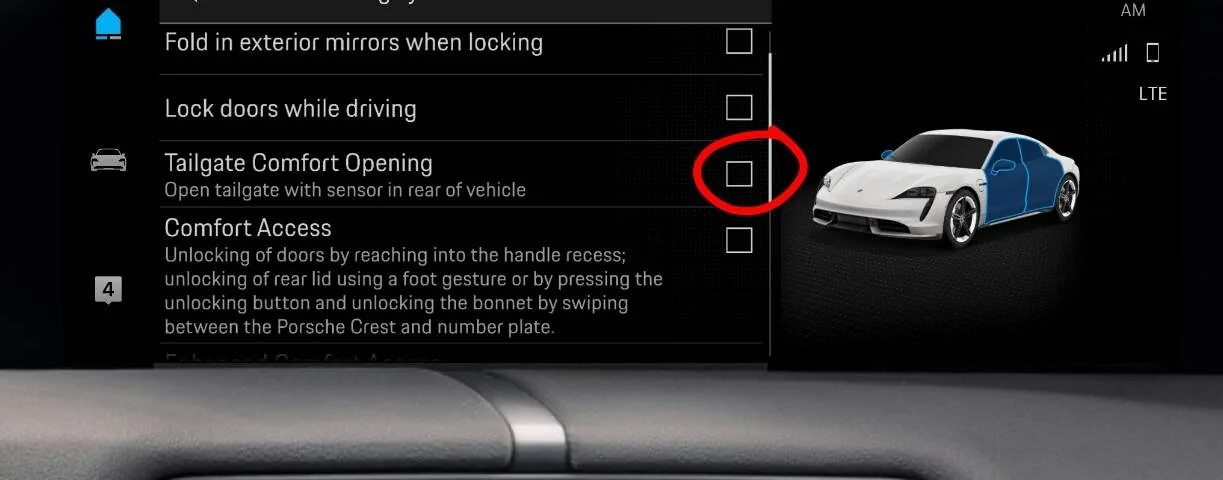

I do not have comfort access, so I don't know if this is built in. Is it difficult to check?
that part shown is the diffusor / bottom of the trunk?
It's the diffuser plate yes.
Every Taycan has this if I'm not mistaken, same as the hood.
You can check if you have it under settings -> car -> vehicle locking system.
my car (every car without comfort access) is missing it. Also the closing button in the lid is only 1 switch not 2.
