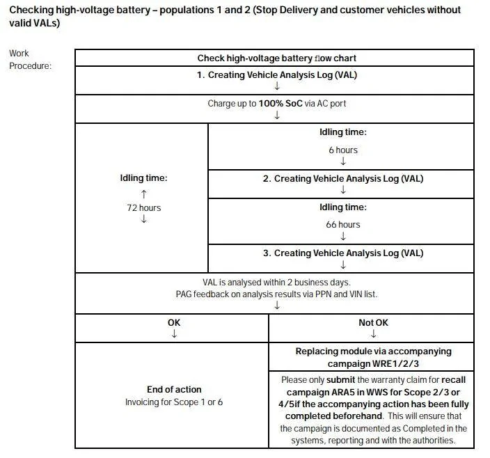

An evaluation of the state of the module cell block of the Affected Vehicles is carried out by the PAG
internal analysis of the VALs.
Valid (complete) workshop and OTA VALs are taken into account for the evaluation.
For vehicles for which no OTA VALs are available until the action is carried out, 1 to 3 workshop VALs
must be created and transmitted to PAG depending on the vehicle population, taking into account defined
process steps.
• Population 1 – blocked vehicles without an existing, valid VAL – create 3x VAL
• Population 2 – customer vehicles without an existing, valid VAL – create 3x VAL
• Population 3 – customer vehicles with an existing, valid VAL – create 1x VAL

Up to 3 VALs may be needed. One VAL requires an idling time of 66 hours and a second VAL requires an idling time of 6 hours. Results of the VALs determine whether battery modules need to be replaced.

1. Charge to 100%.
2. Idle vehicle (ignition on) for 72 hours.
3. See what happens.
@ciaranob and @daveo4EV , this looks like a different battery test procedure - the short circuit test.

How are they going to obtain a OTA VAL after 6hrs of idling? Last I checked Porsche times out way before them and shuts off the car (no Camping Mode like Teslas).
My guess is that either the car is connected to PIWIS device during the idle which prevents shutdown, or dealer has some other method to keep ignition on.
Ok, so not OTA then.
