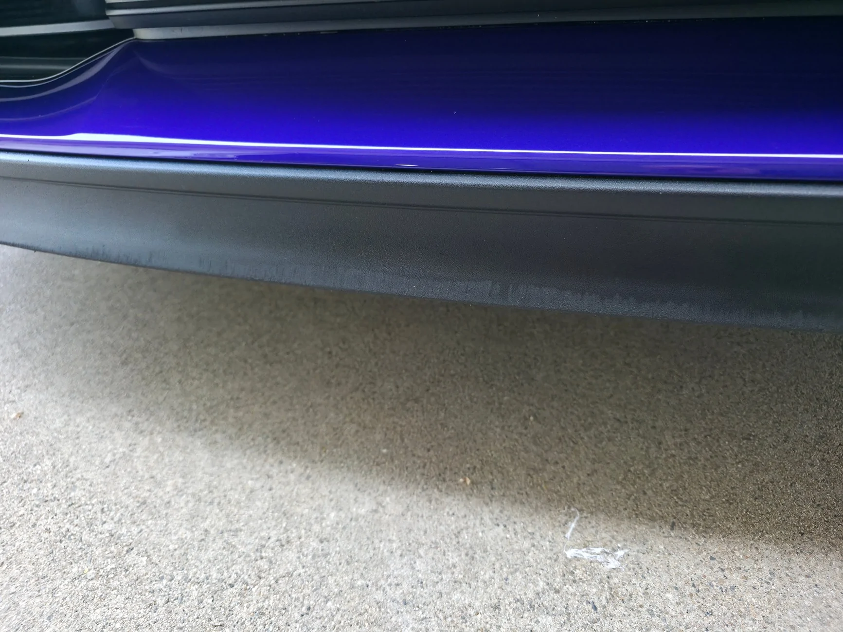

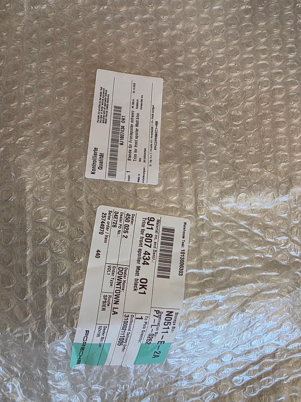

Bottomed out badly and scratched the front aero lip.
Luckily it's a separate piece that can be purchased for around $600 for a cheap piece of plastic.

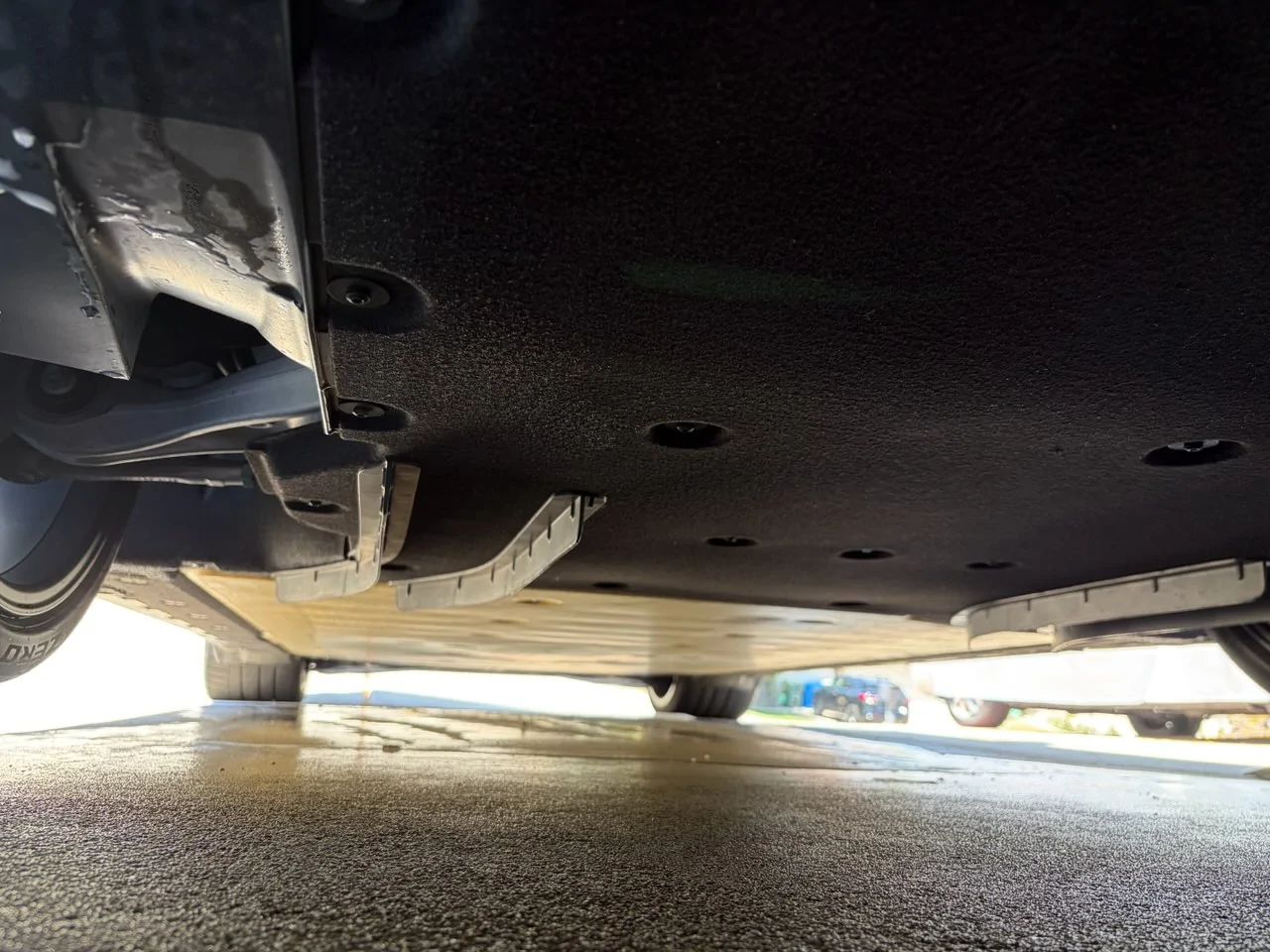

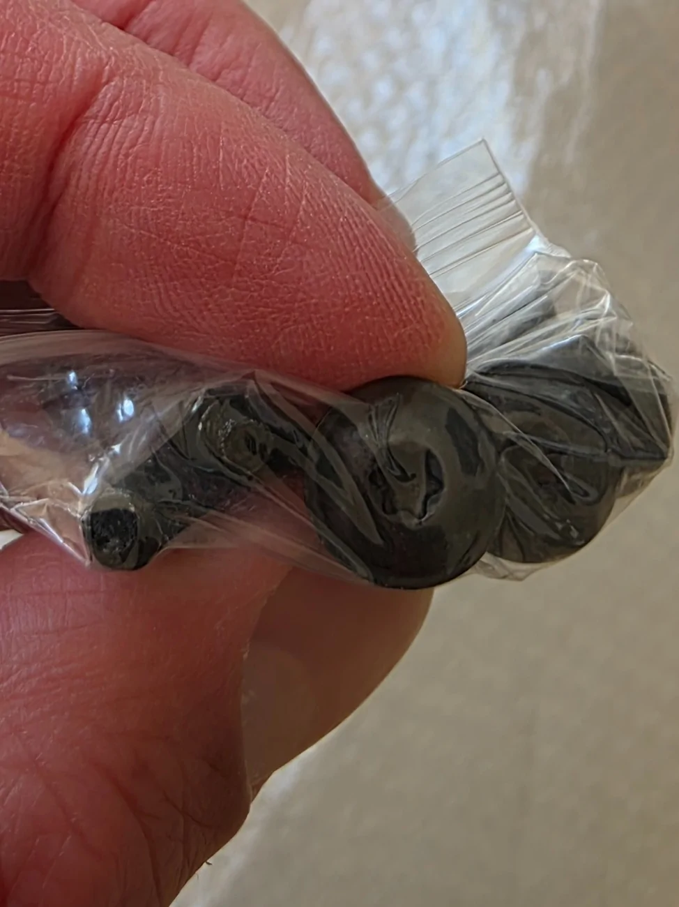

There are 7 star screws that need to be removed, but lifting it is required. I used some ramps to get the clearance.

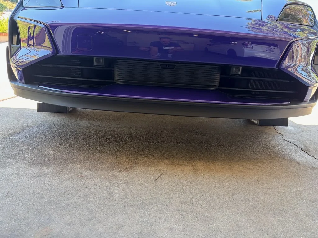

Took around 45min, applied 2 layers of ceramic coating to give the plastic some depth, hydrophobicity and protects it against oil stains.
The scratches
Porsche Taycan Turbo GT front lip replacement 20260425_070557

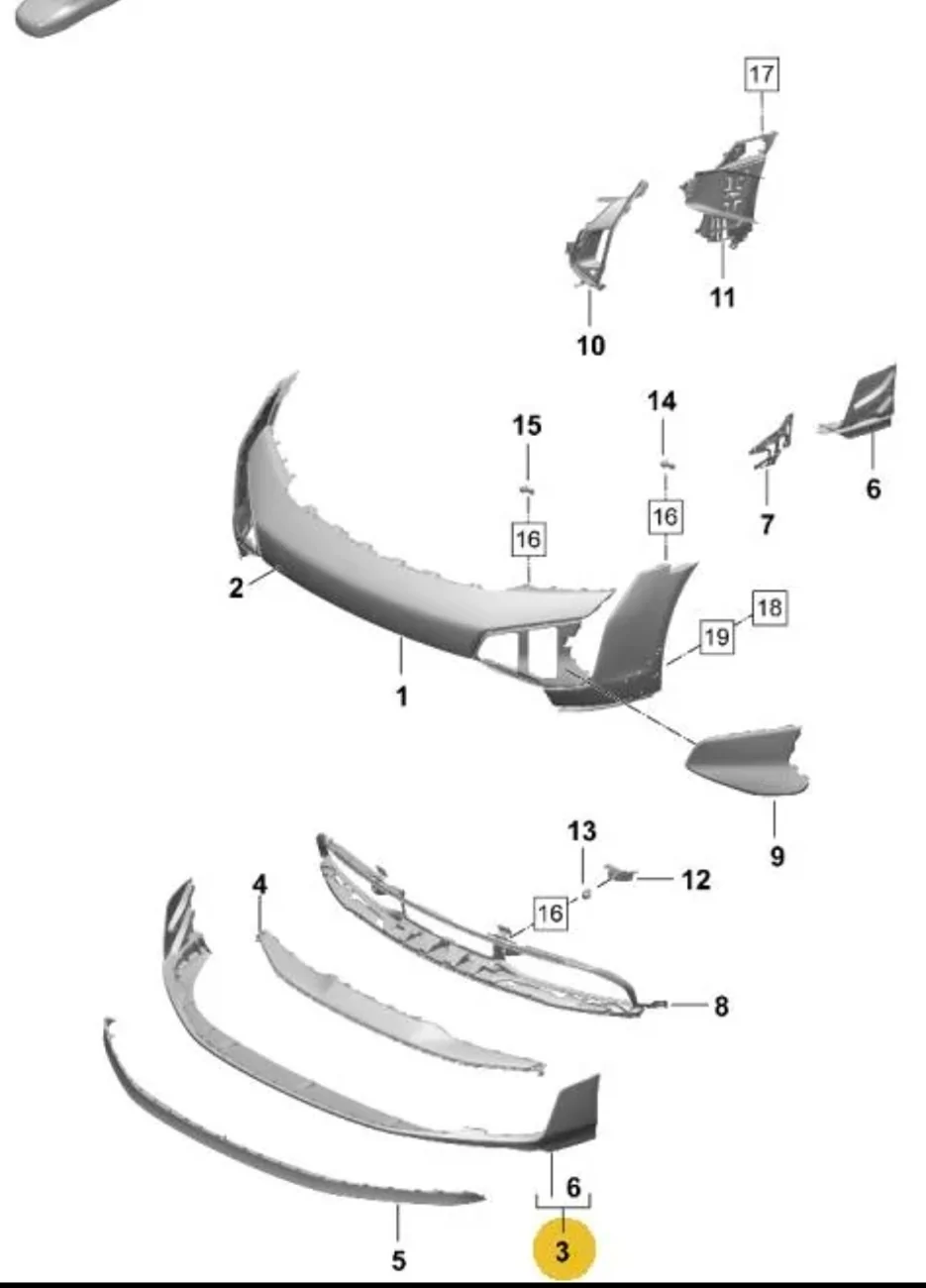

Part# 9J1-807-434-OK1
Porsche Taycan Turbo GT front lip replacement Screenshot_20260427_050148_Gallery

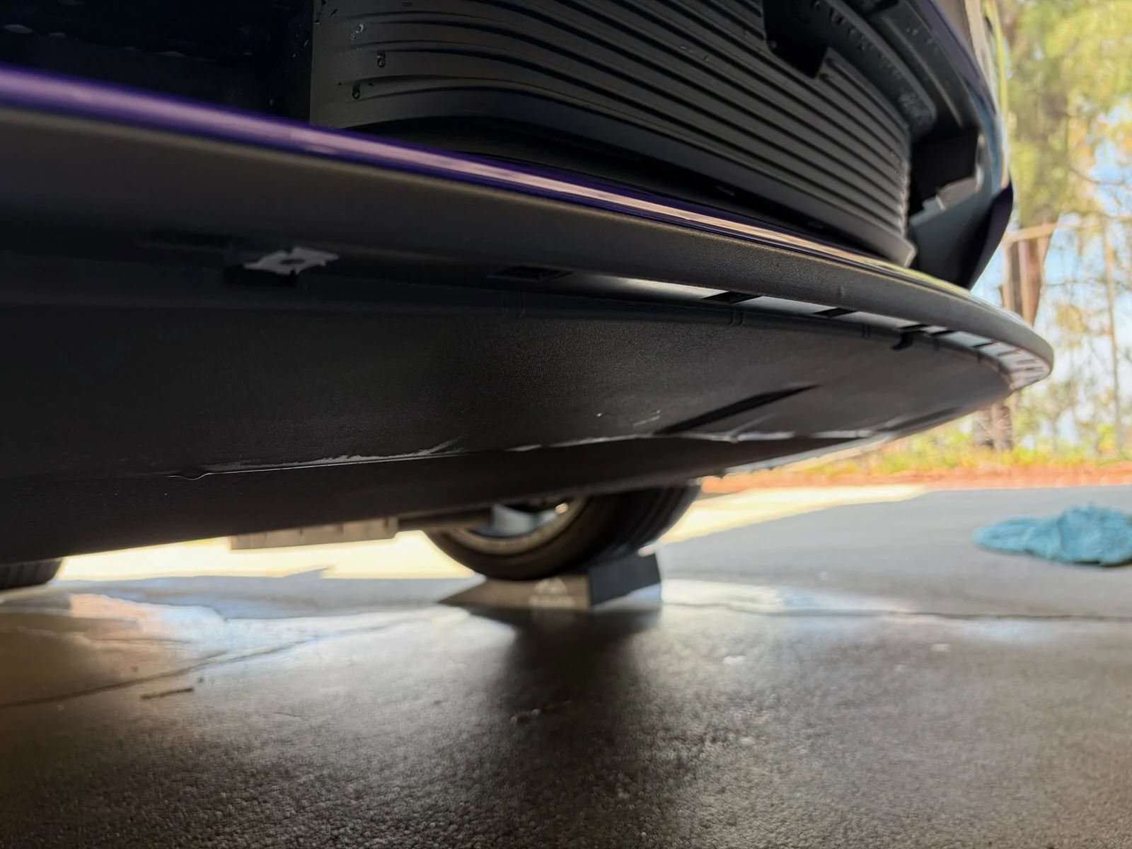

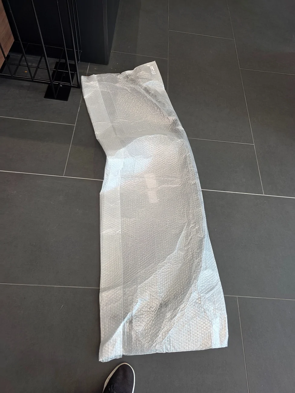

Part

Star screws
Porsche Taycan Turbo GT front lip replacement 20260430_115021
Removed, 7 screws total and clips to secure.

New installed
Porsche Taycan Turbo GT front lip replacement IMG_20260520_142010
