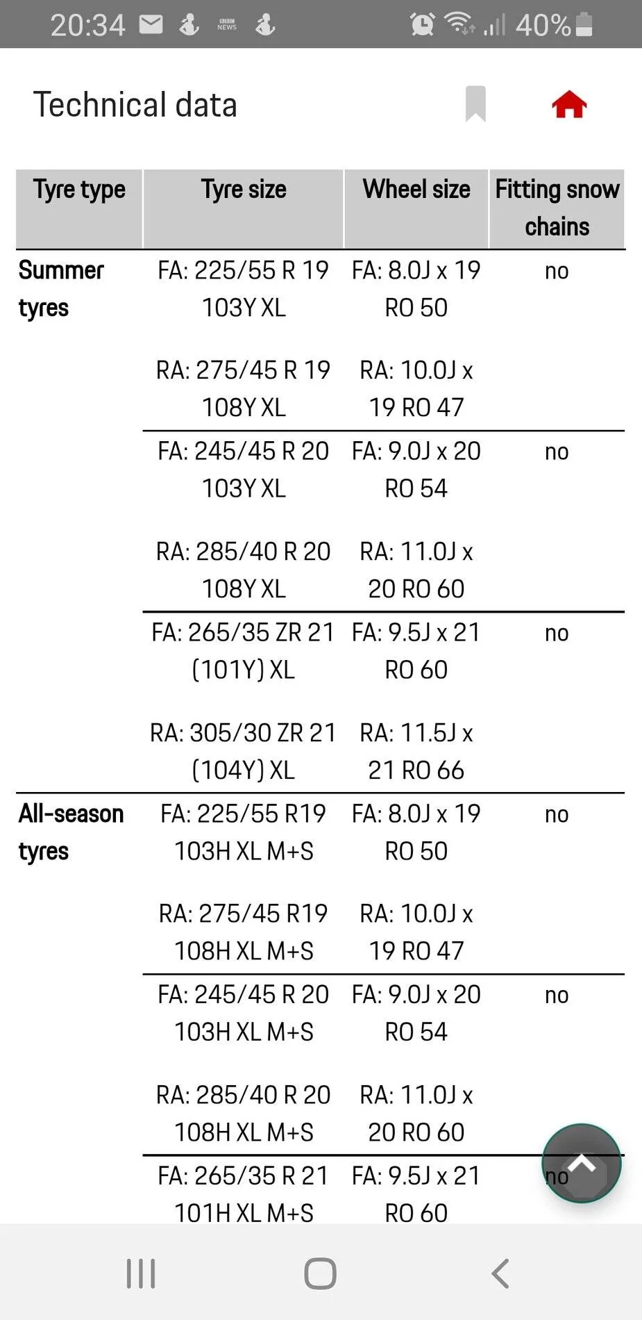

@W1NGE , Yes I do have that info, but that are just the technical dimensions etc. No pressure recommendation in that. I thought there would be pressure info in bars or psi

Read the text and it refers you to the plate on the car as I mentioned in an earlier post.

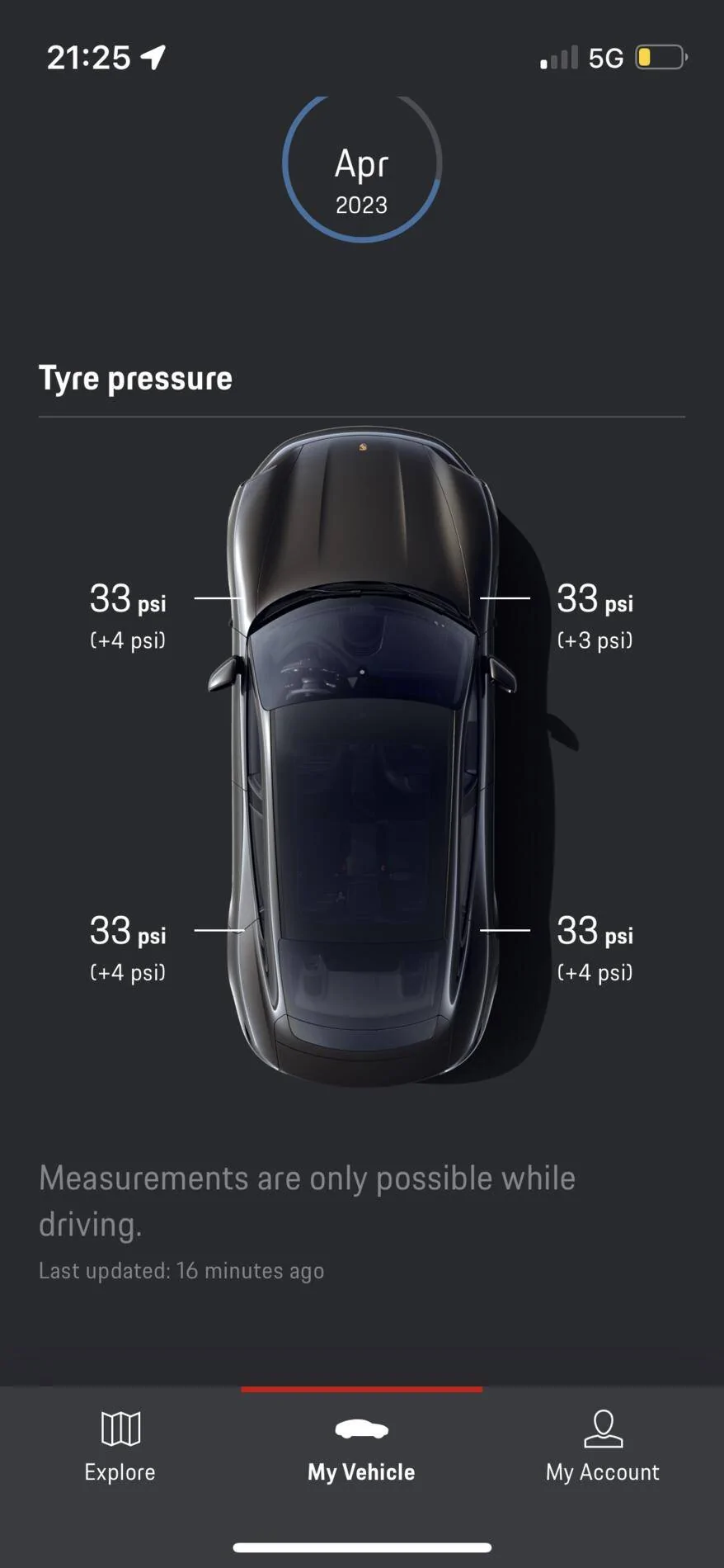

So this is where I am now;
Porsche Taycan Tyre pressures dropped suddenly E2E41604-81EA-4A5F-B9FE-0E02086FB4FB
why does the deviation think my tyres are under inflated from what’s on the pillar?
So from what some earlier posts suggest, trust the car - so why is 29/30psi correct?
Remind me + Taycan model, wheel size and tyre type?

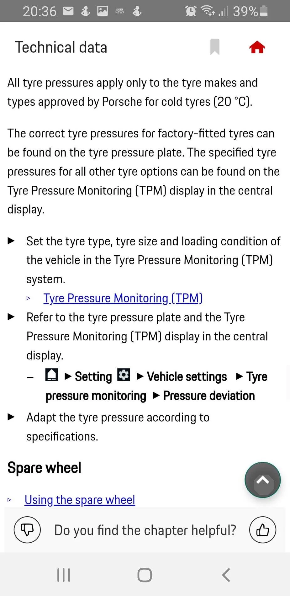

I am aware of that but I responded to the comment about the manual for the Cayenne as below. Seems the Cayenne has two pages of information with tyre pressures and wheel combination.
ALSO -- the Owner's Manual for my Cayenne has two pages of recommended pressures, based upon the tire size; type of tire (i.e. summer; A/S; snow; etc.) and number of occupants. There is only one recommendation on the inside of the driver's door, and that is for a fully-occupied vehicle with four people. If I used that recommendation and not what is in the Manual, I would see early / uneven tire wear
Secondly I think it gives an incorrect data if you follow the door sticker, as the OP has upgraded wheels as he has stated. The car might have been delivered with 20 inch wheels and he might have upgraded to 21 inch, OEM or third party. In that case the door sticker is not much help. That is why it would be helpful to have information in the manual that would state which tyre pressure is recommended for different tyre sizes.

I understand - had the same in my Cayennes, Boxster, Macan and Panamera. Still things move on.
The plate on the car corresponds to the tyres and wheels fitted at the factory.
For any change to wheel size or tyre you must use the TPMS utility in the PCM - Tyre selection and loading. This will then give you the deviation to be adjusted to match the wheel size and tyres you now have.
Agree a table would be simpler but the electronic method is easier to maintain and keep up to date.
I think you stated that you have upgraded tyres? From factory delivery or later?
Is the door plate the same size as your actual tyres?
What tyre size are you having on the car now?
Have you checked that the PCM shows the same tyre size as you actually have on the car?
And that they are correctly stated ie summer or winter?

It’s all in the PCM. Set it up with your wheels, tires, and load setup and the system will provide you with Porsche’s ideal pressure for a balance of road holding, efficiency, wear and feedback.
The door frame sticker is a catch all that’s always *safe* but not optimized. If you’re interested in an optimum pressure, use the system built into the car designed for this purpose. Tune from there if you are in search of further personal optimization.

Thanks. But if that’s true then the car as pictured above is telling me I need to inflate my tyres to 29psi?
Did you check that the tyre setting in the PCM corresponds to the tyres you actually have on the car?
