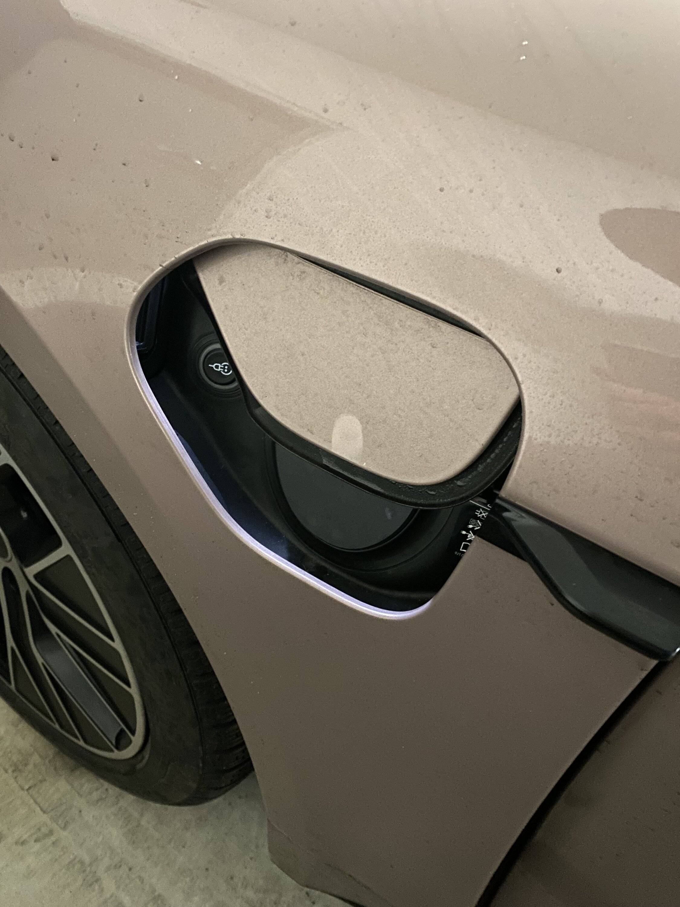

[UK] Motorised charge port half opened itself and now stuck?!

okay so I got the exact same problem with the charge port. Stuck half open and i didn't use it. I got the error message when I entered the vehicle and noticed it was open. I have to leave with the car in a few days... i might try again and then call my dealer if no success.. Wtf is this seriously.

The trick I use to be clear is to get the door to re-attempt to close (it retracts and tries to close - use either multiple swipes of fin, repeated pushing of end charge button and/or console open/close button) and the KEY point is to ‘interrupt’ the door on its descent almost immediately I.e. when it reappears after retraction, don’t let it travel more than one inch when it appears/is visible AND not just putting your fingers/hand in its way but provide a firm press up to imitate a blockage.
In the few times I’ve had to do this it was this procedure that worked every time and other attempts like fiddling with door when further down did not work. If successful the door will immed retract and descend to close properly.
Clear as mud!? I did take a video of last event and following up with service soon.

I went back to the car and now the charge port was fully open (when I left it was mid-open) so I tried to close it and it worked flawlessly. I’ve open and close it 10times without any problem. Go figure ?

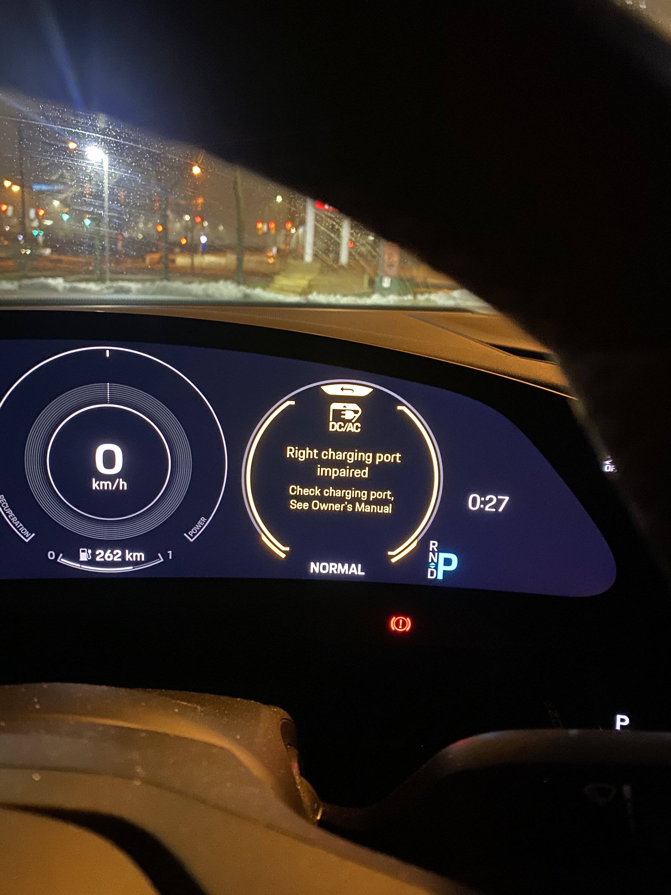

Well unfortunately roadside assistance weren't able to sort it out - they tried some computer diagnostics and fuse resets but no joy, so off to the dealer it will need to go. Interestingly I hadn't picked up on it before but the dash error does indeed say it is the opposite port which is impaired (so on my right hand drive car with the right hand AC port jammed open it reports "left hand AC/DC charge port impaired") - very strange!
Not had this specific issue but have had the impaired message when the door closed on the DC flap which hadn't sprung back into position.
I have had a charge port fail but the opposite one to where the error was reported which implies all paths lead to the same single AC charger. This may explain why the opposite one is your issue.

I’ve had the same problem. Near side port door stuck half way and dash reports ‘right hand’ port impaired.
6 or 7 times now. No amount of fiddling fixes. Resolves itself over night. Dealership can’t find any fault….

In this case I believe it is simply bad syntax/wording by Porsche - I too had this issue - because the left hand door is stuck open the right hand charge door cannot be opened hence it says the RHD is 'impaired' when in fact it likely works just fine and is simply unable to activate whilst the LHD is stuck open (both doors cannot be open at the same time).
In my case it was a faulty charge door sensor - the door was replaced and I've not seen a recurrence of this error (many months). For some other folk it also required replacing the plug assembly in the port with the faulty door.

Just had this happen to me, or even worse. Central dash shows right side charge port error(CCS side). Drove back home and found left side half open and won’t close. When I tried to close it, it closed and went back up to half open.
Ok the bright side I’m at 70% SOC. But I don’t think dealership service department open on weekend.

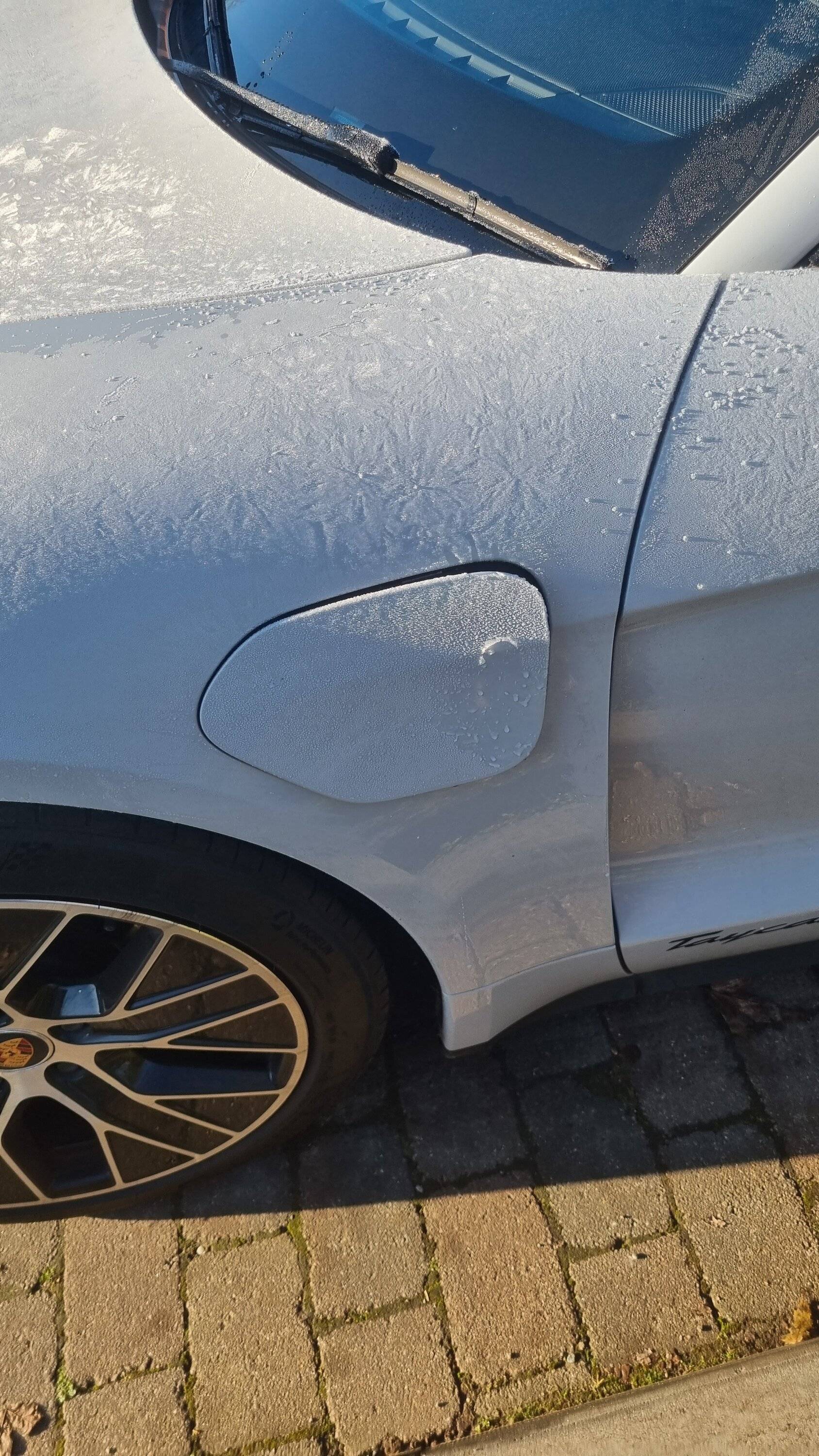

Don't be too quick to discount the electric charge ports though.
I have the manual ones and during a recent cold snap (-10) the LH catch was frozen after overnight charging and I couldn't get the flap to 'click shut'.
When the car warmed in the sun it started working again, but the same thing happened 3 cold days on the trot.
You couid drive it with the flap slightly ajar ok, but the manual flaps are not very robust imo.

This was mine after a recent cold night.
I had charged overnight at that port, but the flap would not click closed until it warmed up in the sun.
It would not latch shut....just bounced back to this position.
Happens every time it's below about -5c

Porsche and fuel cap or port covers is not a core strength at all on any of there models in my experience. Clearly missed this on the zillion miles of winter testing....
