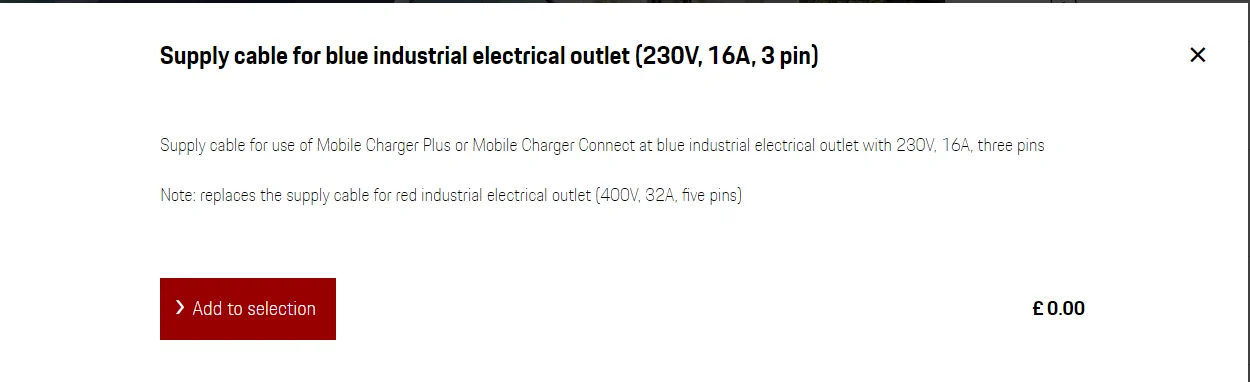

It would be SO easy to word this in a helpful way in the configurator wouldn't it - 'swop 7.4kWh capable 32a commando for 16a smaller commando'. Job done. Same as the Acoustic glass - 7.3% reduction in noise I later read in a press release but just intern marketing twaddle in the configurator!
Actually it does, if you look at the info 'i' for the option it is pretty clear what you get and that it replaces the standard cable. Your dealer should have highlighted this as an additional check before completing your order.

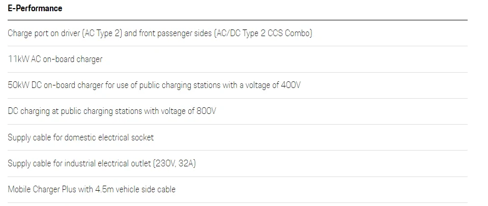

Standard spec for all UK Taycans:
Porsche Taycan UK Porsche mobile charge connect - what output with 32A commando socket 1643710911780
You do not need to add anything further in terms of cabling for home use (unless you have specific needs or potentially need a longer EVSE to car cable).
If you will use / could use a public AC charger which is not tethered (i.e. no cable to connect EVSE to your car) then you should order the Public Mode 3 charging cable or you run the risk of getting caught out.

That's exactly what happened - I saw I needed a blue commando which seemed to be an option and it didn't state you got the 32a as std. I didn't know then that blue could be 16a or 32a and that they werent compatible. Well they never told me either! Ho hum.
I disagree - that is NOT clear and it is quite misleading. I'm all over it like a rash now but I knew then that I would never want a 3phase 400v one so chose the 240v blue. Their info can be drastically improved to add clarity for a newbie and what is actually typical for charging. That suggests a 3phase red is std!
The point is that you did not need to choose anything and stick with what came standard.
