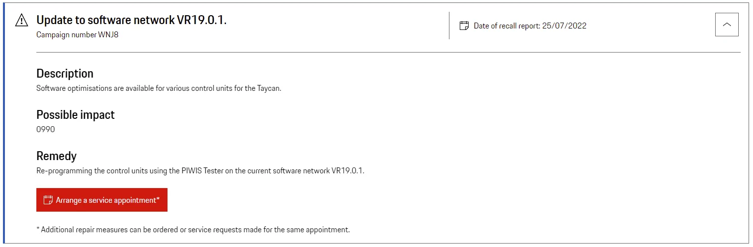

Update to software network VR19.0.1. Campaign number WNJ8 (UK)

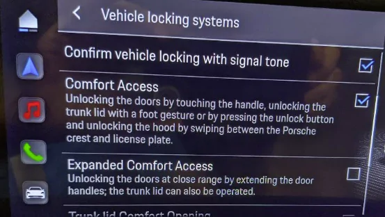

Biggest irritation Is my handles no longer pop out when I come back to car. Previously if car unlocked and I walked near car door handles presented themselves. Now, nothing. It’s incredibly annoying especially with kids. Cars unlocked but have to almost force the handles up unless you re press the unlock button. Anyone else had this ?
Check your PCM - you may have two levels of Comfort Settings as a result of the update. Only Expanded Comfort Access extends the door handles.
Yes, also. After the update. I’ve not got comfort entry, don’t trust it, but it was handy having handles lift if car was unlocked when you approach. Apparently that feature was a bug and has been removed. . .
Same, no comfort entry for me either. I did fear as much that it was a bug previously. It is daft though though and super annoying now. Did I see that Comfort access was a FOD so are they removing this bug (!) so people start paying for it?

My car was completed 1st of July but nevertheless it is awaiting update WNJ8 (VR19.0.1). How is this possible? Shouldn’t the car already have it if it was produced then? It entered production 26.06.2022
Furthermore, my dealer in Romania said that they don’t have the USB stick with the update yet… A USB stick? What is this? 1994?

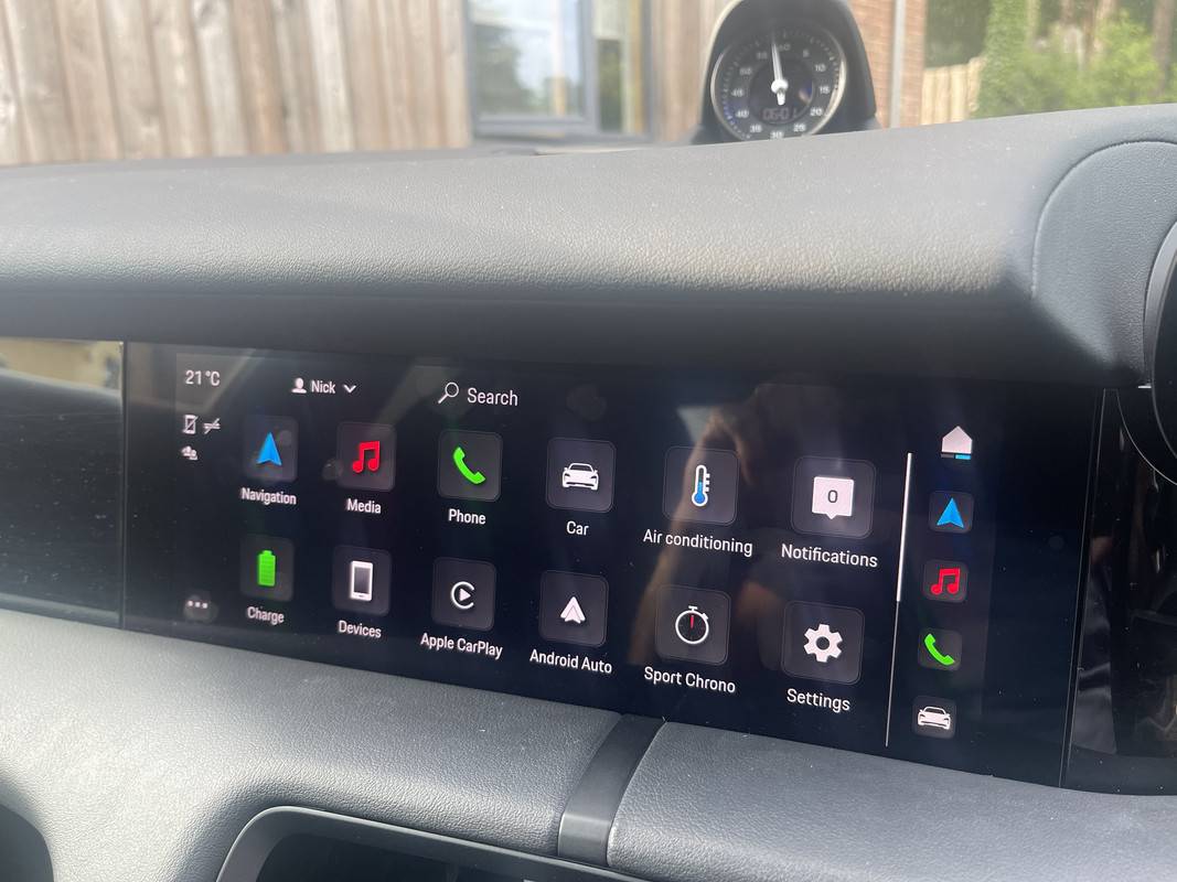

I had the update applied to my July 2020 car. Hugh improvement, having android auto is a joy! Much faster to use overall and just a big leap forward from the systen provided to us early adopters.
The car was with the dealership for two days and the update was applied with no issues.
However, the biggest improvement for me is power steering+. This was added a year after delivery of the car through connect. It made no difference and don't belive it was ever activated, although Porsche insisted it was. I can now safely say it is actually activated as the difference is immediately obvious.
