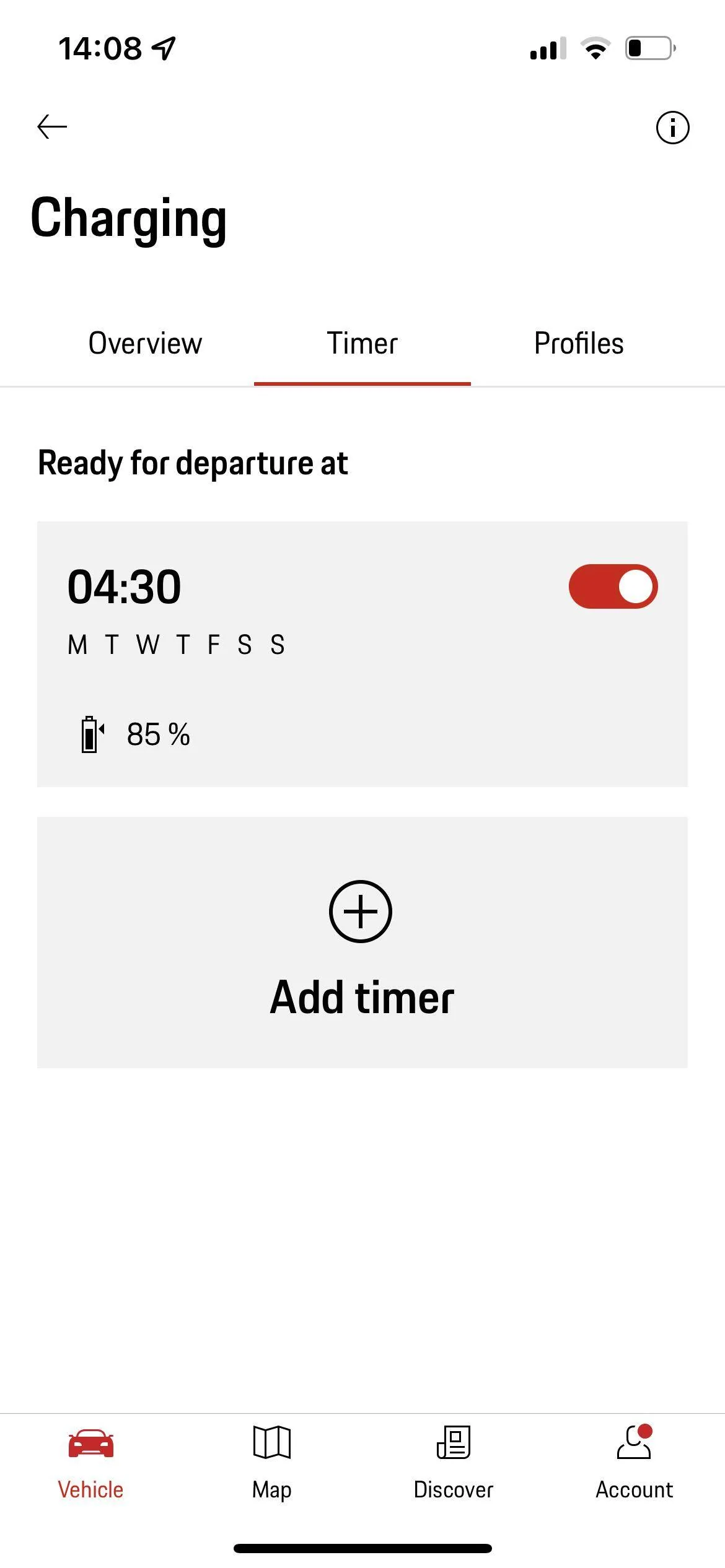

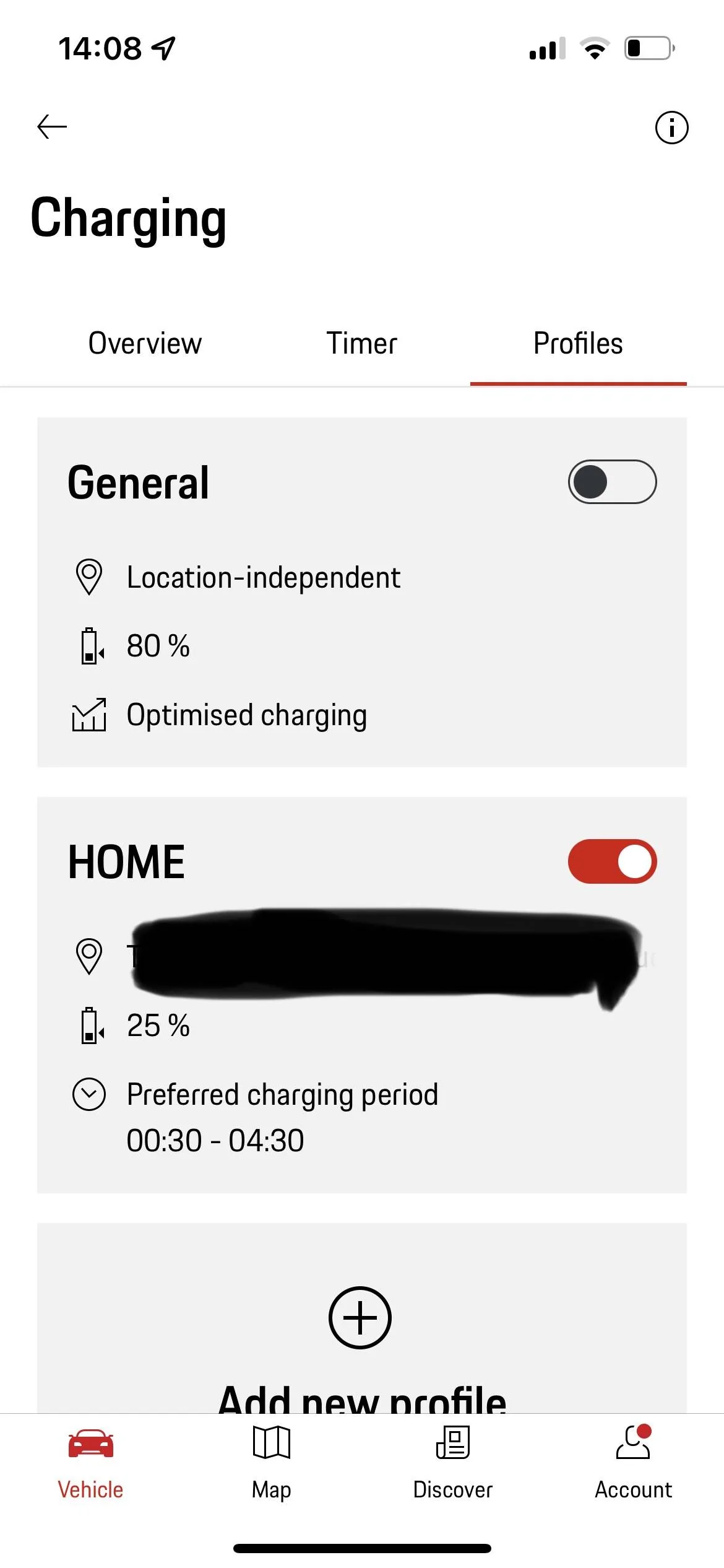

I got the WNJ8 update done Monday/Tuesday last week. All as expected except for one headache....
My timers and profiles were all in place but the car does not charge to the timer - I want between it to charge 12.30 and 4.30am for cheap rate so have a departure timer set at 4.30 am
I have deleted the timer and profile and re done them but still doesn't charge over night
If I hit direct charge all works as expected.
Anyone else have this and have you resolved it?
Ive attached my settings
Looks fine to me and I use the exact same but stop at 07:00.
Have noticed other issues with the update but not charging.
Perhaps power cycle your EVSE and try again?
Also does your PCM concur with the active profile and timer settings?

Thanks daveo4EV - this timer profile set up worked absolutely as anticipated for me prior to the update. Now it doesn't start the charge at all overnight.
Are you saying that timers profiles didn't work for you intermittently or that the implementation is a little sketchy/complex/non intuitive?

I've tried that - I deleted all the timers and profiles . Left the car off at work for a day and then re did them as I posted above.
Still doesn't't initiate a charge in the preferred hours between 12.30 and 4.30am
Interestingly if I hit direct charge on the app during that time period send to to the car and then turn immediately direct charge off again it seems to kick start it and the car then charges to 04.30am

Various SOC eg last night was at 60% but did not charge at all . I’ve also tried bringing the departure time forward if I bring it close enough to force immediate charging it starts ok. If there is a delayed start it didn’t start.
However it looks like the EVSE reset has worked - a test timer set for this evening worked ok. Hopefully it will work tonight.
