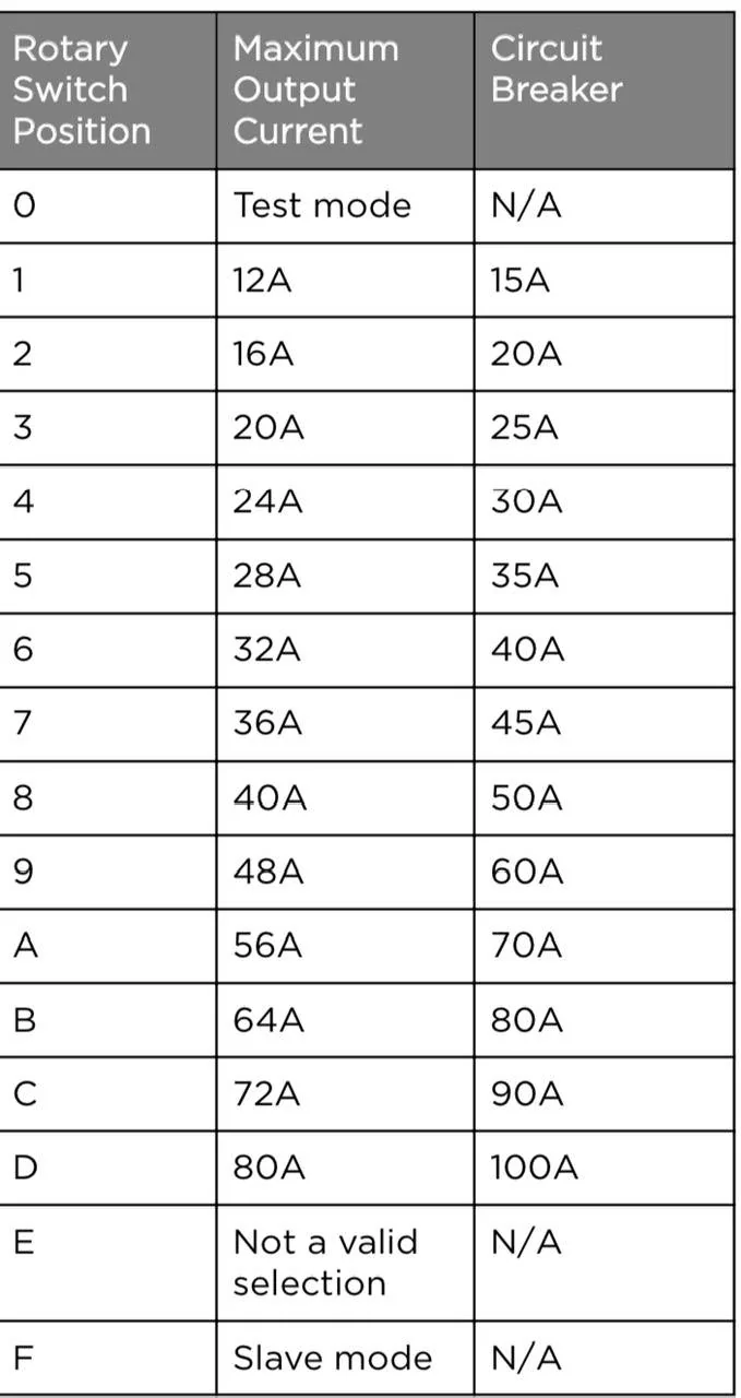

The Tesla Gen 2 is capable of pushing out 80amps, then I'm wondering if it's possible that the Taycan will try to "suck" 80amps through and trip the circuit.
this will ONLY happen if the Tesla charger is “misconfigured” - i.e. the dip-switch inside it was not set correctly to match the breaker/wire when the charger was installed/configured.
_IF_ say the following _IS_true (as a hypothetical)
  • your Wall chargers is physicaly installed with 60 amp breaker + 60 amp rated wire - 48 amp charge rate therefore is advised for electrical safety
  • BUT the installer “forgot” to set the internal switch to 60 amp breaker setting
  • AND the internal switch is say on 90 amps (one of the possible settings)
  • you plug your taycan in - the Tesla charger will incorrectly report it can do 90 amps (72 amp charge rate)
  • the Taycan will “pull” 72 amps - overloading the breaker because the CHARGER told it that was it’s maximum rate
  • this would be bad and hopefully trip the 60 amp breaker after some time
however the fix it easy - take the cover plate off the TEsla wall charger - get a small screw driver and “turn” the rotary dip-switch inside the Tesla charger to the setting that matches the breaker - and volia - no more mis-advertising of the charger’s maximum charge rate.

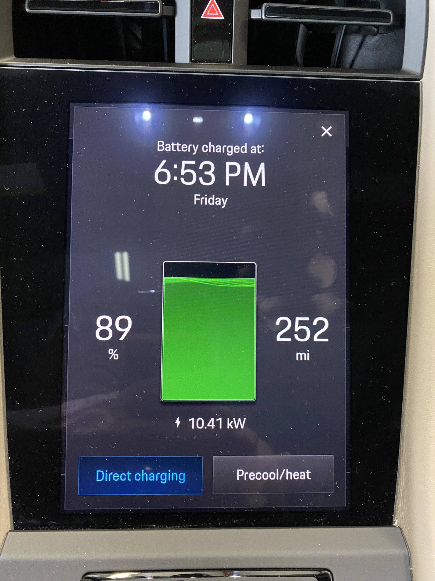

how would you tell the Taycan is pulling too much power - well we know 48 amp Taycans pull about 10.4 kW according to the in car display during charging - if you plug in your Taycan to a 60 amp breaker (48 amp charge rate) and the main display shows a number more than say 11 kW for the charge rate - well then something’s misconfigured and you find out what and fix it.

here is the installation guide:
https://www.tesla.com/sites/default/files/downloads/wall_connector_installation_manual_80A_en_US.pdf
page 22 is the reference for the corrrect settings inside the unit to match the external breaker+wire you installed…see picture included in this post for possible settings - happy to answer questions
the good news here is that _IF_ you want to increase your charge rate you only need install new breaker+appropriate wire guage - but you do not need to purchase a new EVSE - just open up the case and adjust the setting inside the unit to match your new breaker+wire and volia - you have a faster charger the next time you plug in.
ALWAYS ALWAYS ALWAYS make sure the breaker+wire-gauge+charger settings are matched so that you do not overload the electrical circuit - vehicles are rather dumb - while they will limit themselves to the advertised rate from the charger/EVSE - they will also pull power for hours at a time at that advertised rate - so make sure your charger/EVSE is not over-promising on it’s advertised rate.

Just took delivery of a 4S. I am charging from a Gen 2 Tesla Wall Charger and Mini Tesla Tap 60 amp. I have noticed a lot of heat is thrown off during charging. Garage (small) went from 80F to 90F pretty quick. Also the Tesla charging cable runs about 96F and about 102F on the Tesla Tap. I have not felt this with charging Model 3 or S. Curious of other's experience with heat generation while charging the Taycan.
193
7,031
10,517
nothing here that appears abnormal.
