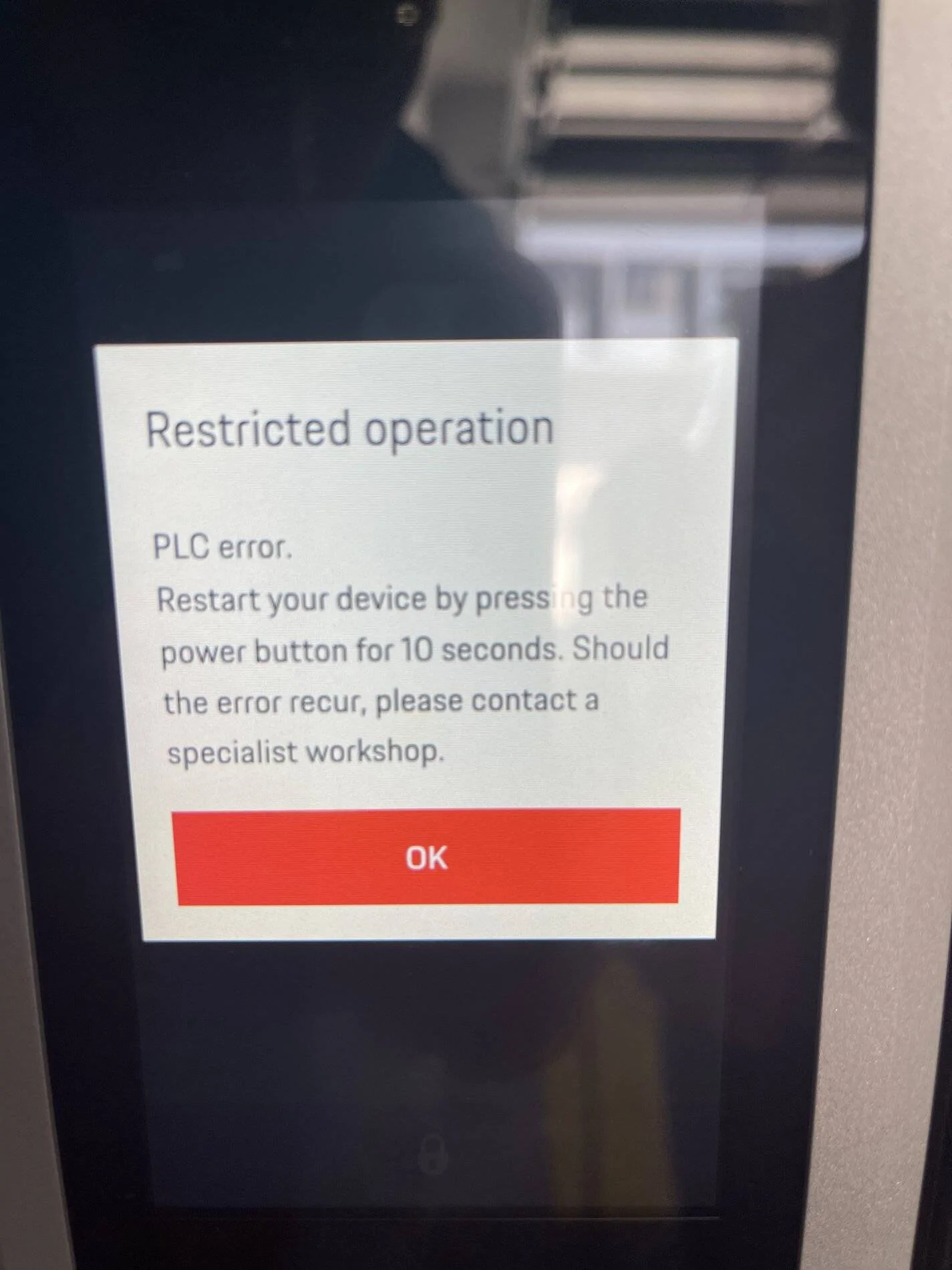

Has anyone seen this error before with the Porsche Charger?
I reset it and it starts charging ok for a few mins then the error comes up again and it reduces charging to almost nothing.

Yes.
Disable the network connection option Power Line Communications (PLC) as a means of connecting the PMCC charger to your home network.
To do this either use the touch panel or the web interface from your phone or computer.
You will have received a white envelope with user accounts and passwords. One is 'user' and the other is "tech".
To deactivate PLC sign in one of these accounts and go to the Power Line / networking option if accessing from phone / laptop.
You only need your charger to connect via WiFi.

Yes.
