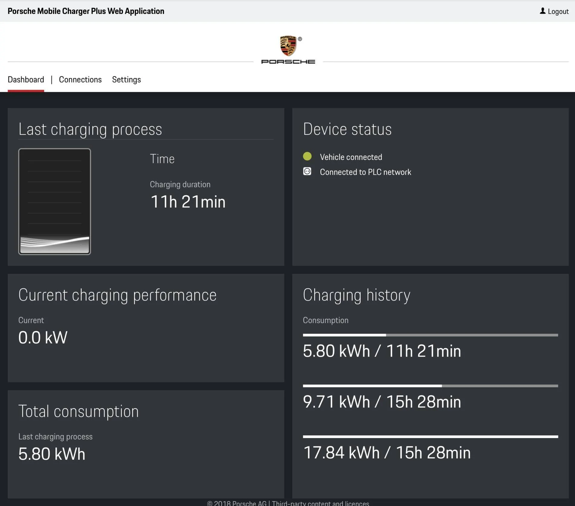

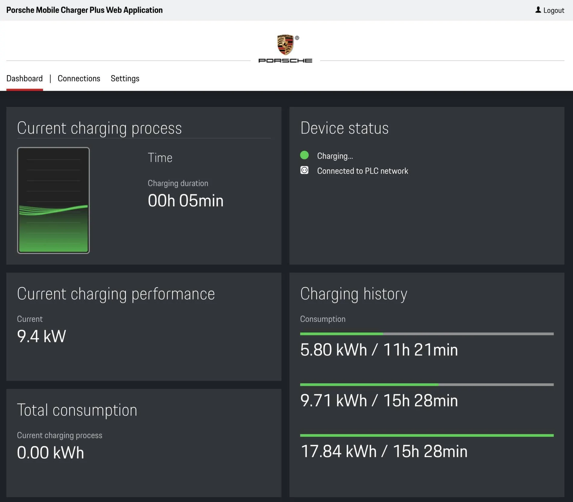

Yes, I used the pairing button on the receiving end after powering up the charger.
Note: the charger is only "online" when plugged into the car, so make sure that is done also.
It's not super useful but I do like pulling the charge values off and putting them into a spreadsheet to see what I am spending on "fuel."
Last month was < $25 :)

I'm curious. Are you sure you are in fact connecting to the charger rather than the car? The plug-and-charge standard runs on TCP/TP/Ethernet/Power-Lines. Do you by any chance have any non-Porsche charger you could try to see if you can still talk via same interface?
I am dead certain I am connecting to the charger.

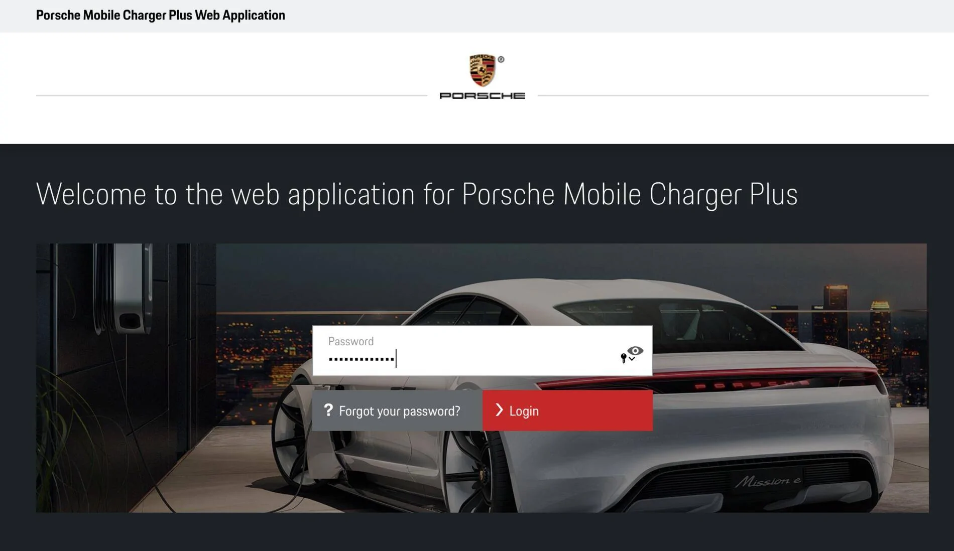

  • The URL (device specific) is https://mobilechargerplus-0005872.local
  • The login page reflects Porsche Mobile Charger Plus
  • The dashboard shows "vehicle connected" and when charging shows consumption (a higher level at the charger than the car shows, which is expected due to loss.)
    Porsche Taycan Porsche Mobile Charger Plus with PLC Adapter Screen Shot 2021-09-08 at 9.04.17 PM
    Porsche Taycan Porsche Mobile Charger Plus with PLC Adapter Screen Shot 2021-09-08 at 9.05.57 PM
    Porsche Taycan Porsche Mobile Charger Plus with PLC Adapter Screen Shot 2021-09-08 at 9.07.46 PM
Thanks.
Does it ever show "vehicle disconnected", or does the charger go offline when vehicle disconnect and therefore you will never see "vehicle disconnected"?

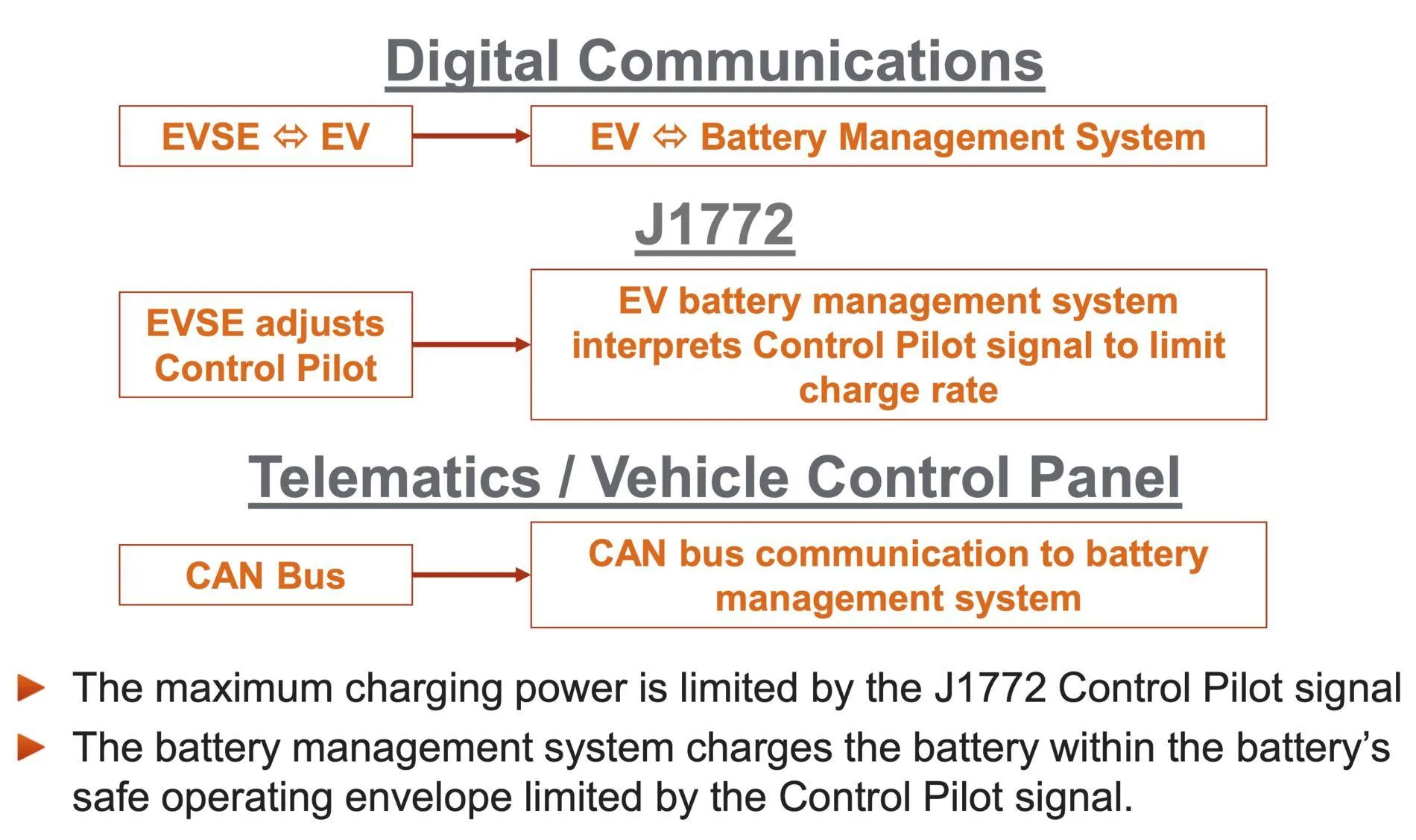

I just draw, what I understand the communication path would be.
The question is what communication is between the EVSE and In-car charger. Does it support PLC or is it another type og signaling?
PC <-> PLC Adapter <-> socket <-> power line <-> socket <-> EVSE <-> In-car charger
PLC communication (IP) = PLC Adapter <-> socket <-> power line <-> Socket <-> EVSE
Uknown communication = EVSE <-> In-car charger
I found this, which may explain the communication between EVSE and the in-car charger:

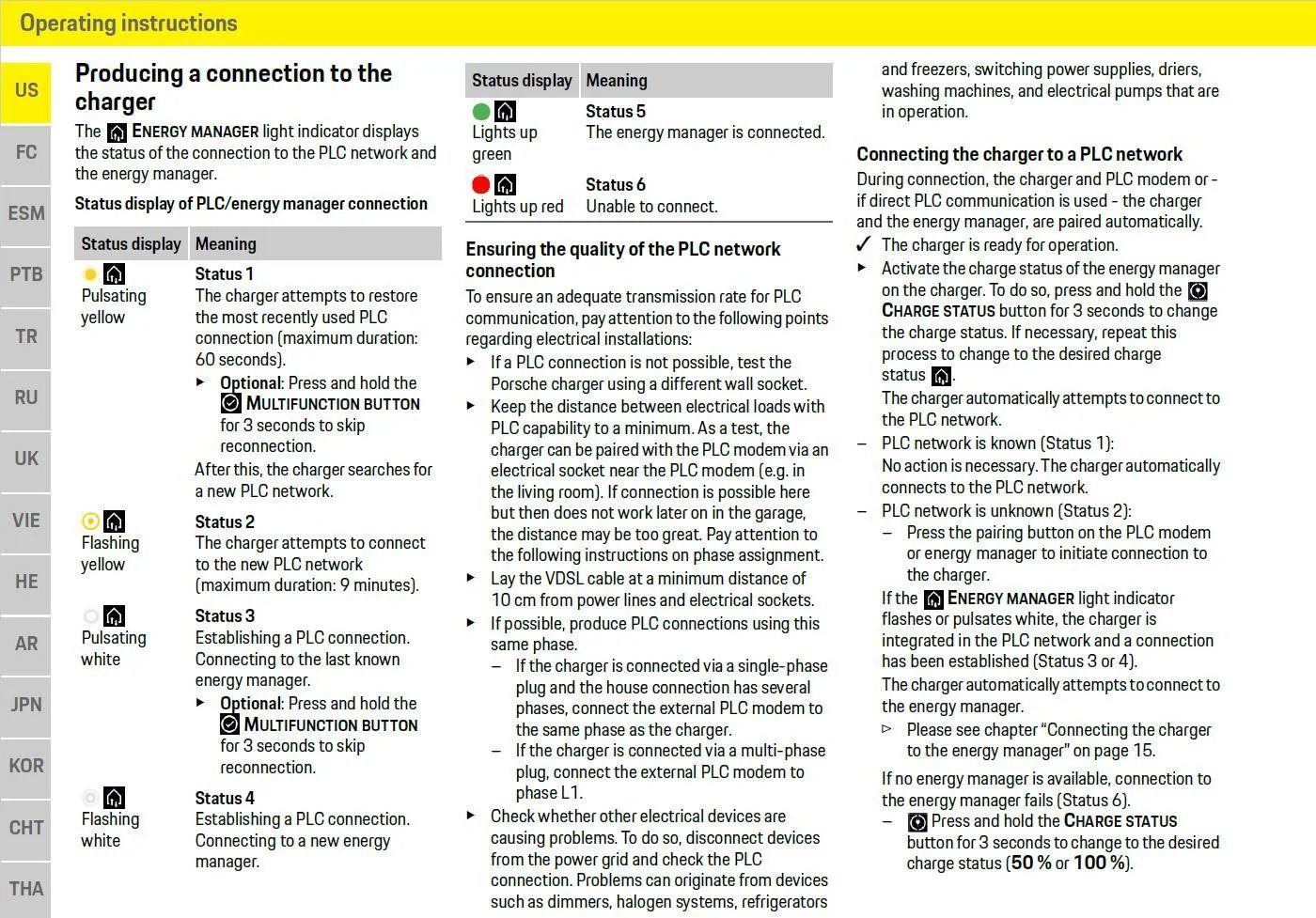

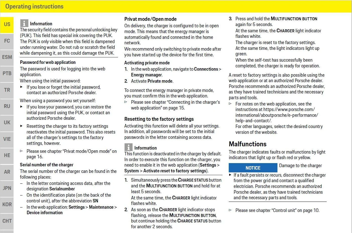

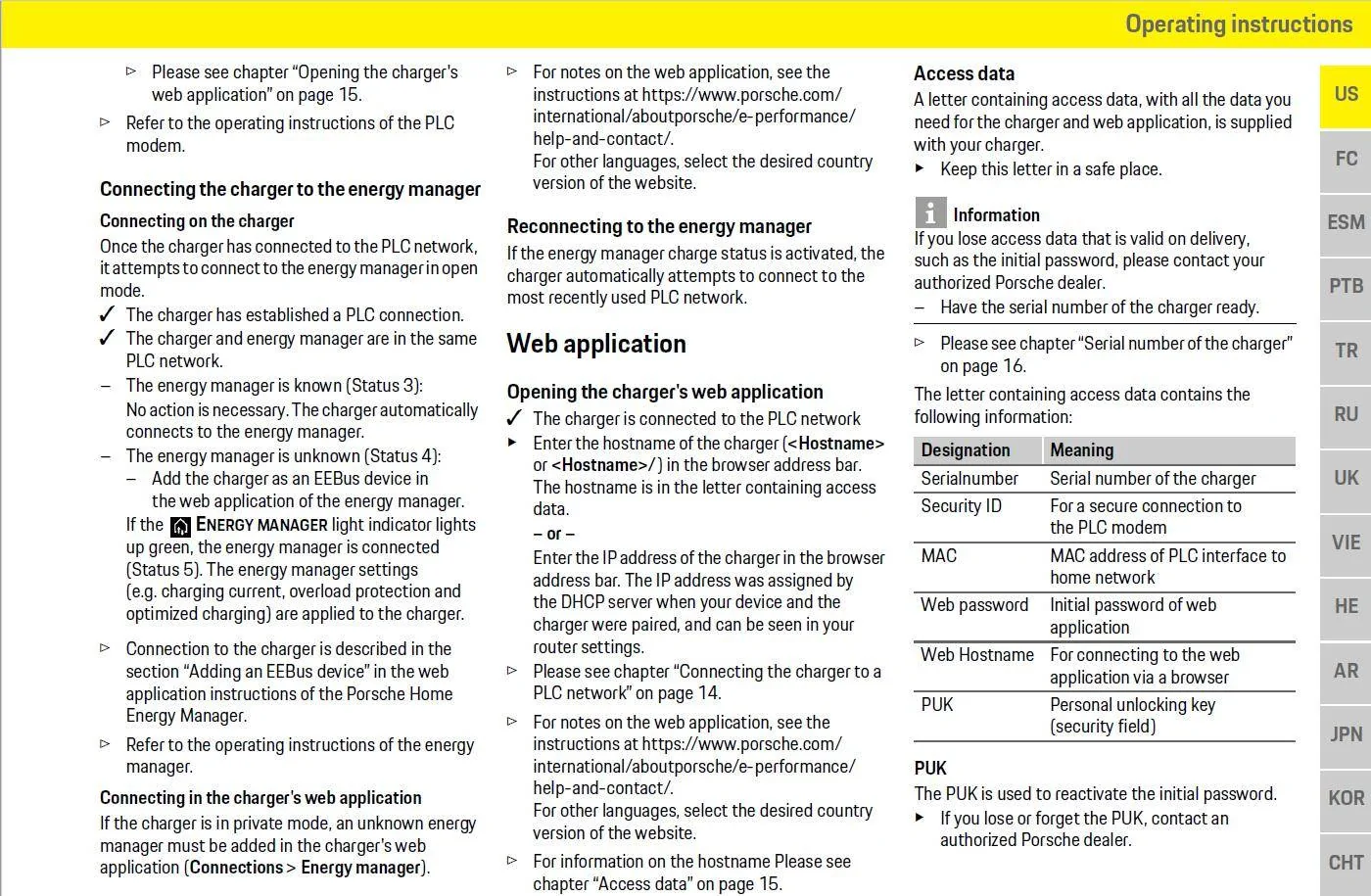

Actually, have you checked the manual - PLC is supported
Porsche Taycan Porsche Mobile Charger Plus with PLC Adapter 1631188114478
Porsche Taycan Porsche Mobile Charger Plus with PLC Adapter 1631187989651
Porsche Taycan Porsche Mobile Charger Plus with PLC Adapter 1631188036383
Porsche Taycan Porsche Mobile Charger Plus with PLC Adapter 1631188065516
Manual is too big to upload (25Mb).
As I said, PLC is possible to connect to your home network, but NOT to the EV.
You can easily check this also by connecting the PMC+ to your home network, then logging in as an Tech User and navigate to the connections menu. The PMCC has a menu item called "PLC connection to the vehicle" and the PMC+ does not. Hence PLC is only available to connect to your home network but not to the EV to use Plug & Charger or any other ISO15118 based feature.
11,046
6,825
Sorry - yes my mistake - PLC only to your local home network.
